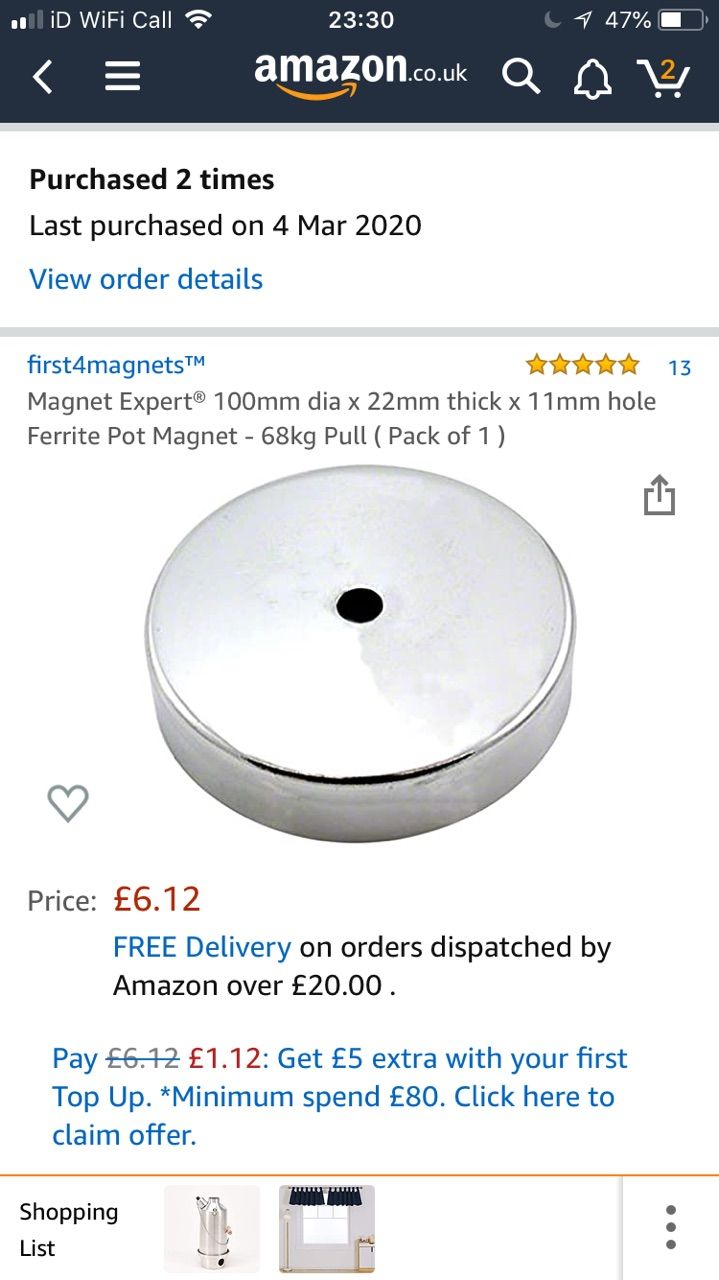

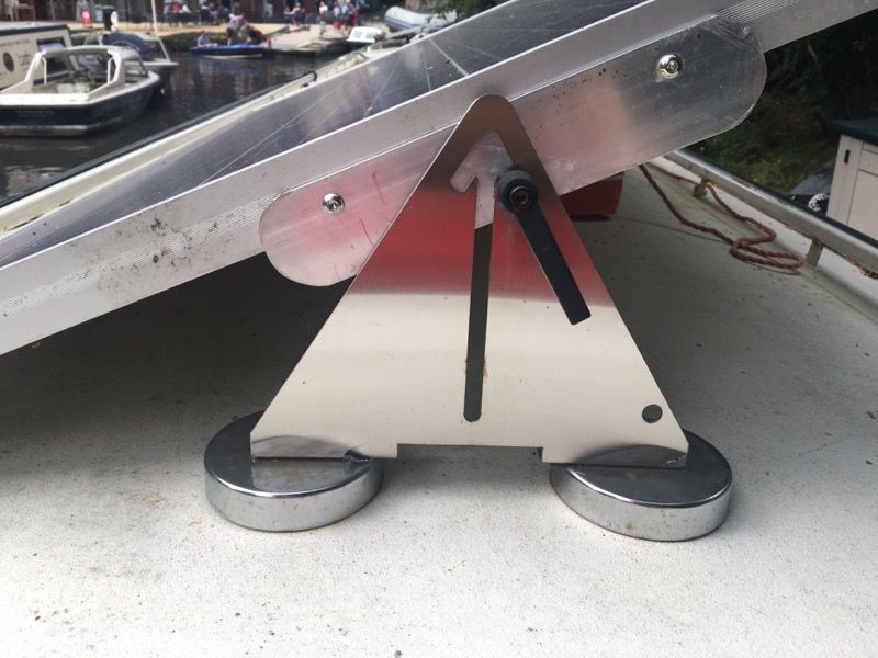

hey so I've recently installed two solar panals on my boat. The boat electrition who wired them in suggested I use high powered magnets on the mounts instead of drilling holes in the boat.
Seems like a good idea to me but I just wanted to hear anyone else's thoughts is this going to affect the boat in any way?
I have uploaded pictures of the magnets he suggested and a picture of how he did it on his own boat.

If they are the magnets I think they are, be careful, they are quite fragile - look tough, but drop them on a hard surface and they will shatter!

The magnets should be fine, and the effort involved in pulling a decent sized one off should deter all but the most determined thieves.
Our satellite tv dish has a magnet mount - we always dismount it before moving. On a couple of occasions or so, in extremely windy conditions overnight, it has blown over, such that when there is a wind at all I try to remember to tether it from falling into the water. I would suggest you consider what lift might generate in a high wind and compare it with the attraction force of the magnets. Both items of data may be less than easy to obtain or even estimate. I would have thought that the more elevated from the roof the greater the risk but specific shapes and angles for the panels may be factors. Alas, you likely can't take them inside when it starts to blow.

It is surprising just how much lift a strong gust of wind can cause. For example my small panel installation measures just 1ft wide and 8ft long, and is strapped to my gangplank (easily removable if I need to use the plank) so that it doesn't occupy any of my roof - and yet the gales earlier this year lifted the whole assembly off the roof including the plank which is a thick wooden scaffold plank that I can only just manage to lift off the roof myself. Only the fact that the wires held prevented it from being lost.
I've been looking into this when i do our solar install and will use magnets with the panels fairly flush with the boat so not to show too much. I'd do anything to avoid drilling holes in the roof and magnets seem the sensible choice.
My panels have been held down with magnets for years. Never a sign of movement. They are flat to the roof though. Well as flat as a flat panel can be on a curved roof. A tilted panel would be more at risk of being moved with wind pressure. Just make sure you have the panels horizontal before a big blow is due.

As you're using them outside consider corrosion. The ones shown are ferrite (which is essentially rust) so the magnets should be fine, but what about the casings they're in? Probably steel, so likely to corrode in time. Also beware of other magnet types which may be stronger, but will corrode.
