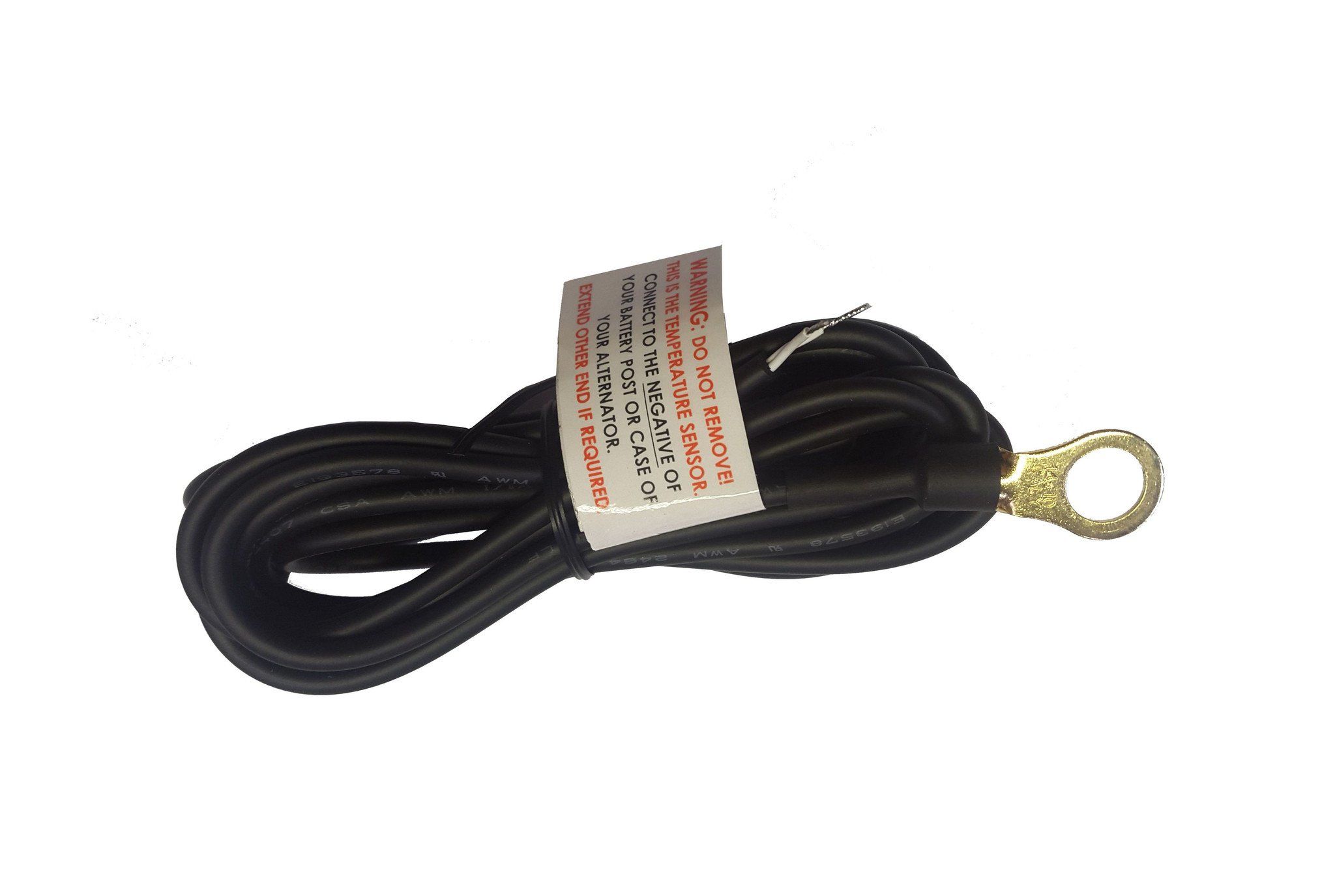

  17. We have a charge control/battery charger display by sterling power. This turns on when we hook up to the shore power to charge the batteries. It then beeps after about 10mins saying batteries over temp. We also have solar panels and a different display for the solar In the picture is the Stirling power display one Also I found the picture of the temperature sensor on the internet on the sterling power website https://sterling-power.com/search?type=product&q=Temperature+sensor
  18. Oh yes well spotted! I don't know if mine is the same as that mine is a black and red wire with the metal ring. Perhaps mine isn't meant to sit underneath the battery and actually on the negative of the battery? I don't really know much about electrics only basic knowledge how will I know if it's the same as the picture???
  19. I definitely think it's the heat sensor playing up. It's very annoying all I want to do is charge my new batteries and make sure they don't go under 12v ??? I've move the heat sensor completely away from the batteries and the charge controller is still saying over heating The heat sensor is just a wire with a metal bit on that sits underneath the battery (see picture) I'm gunna have a go at disconnecting all the batteries and reconnecting them properly. Or perhaps I need to fit a new temperature sensor. But I wouldn't really know where to start with that
  20. No not hot to touch I just went and checked
  21. Yes we have a heat sensor connector to the batteries that monitors the heat of the batteries and their outer casing. Both these temperatures show up on our battery charge controller The batteries are around +45degrees and the outer casing +22degrees when on charge
  22. Hi We recently bought 3 new leisure batteries as the old ones were not holding any charge. We have plugged in to hook up to charge the batteries as they weren't even half full on our solar charge control. But every time we we plug in the hook up to the battery charger the battery charger beeps saying the batteries are over heating. Is it something we have done wrong? What is causing the batteries to over heat when on charge? What are the dangers of over heating batteries? We have a sterling power product battery charge controller And we have fitted 3 new leisure batteries from halfords Voltage: 12V with Capacity 115Ah im getting very stressed and worried because I don't want overheating batteries but also I don't want them to drop below 12v

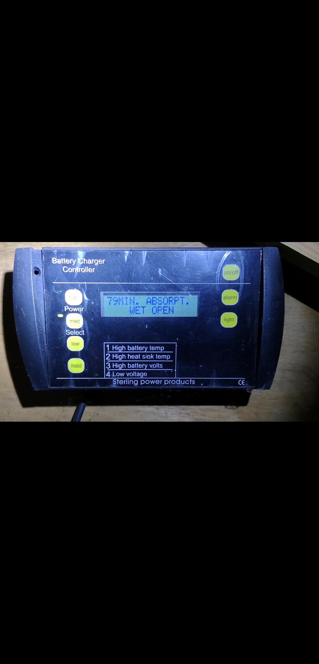

  24. Hey guys So we fitted 3 brand new leisure batteries today as our others were not holding any charge and on the recent survey it was recommended we replace them. I replaced the batteries with 3 brand new leisure batteries from Halfords Voltage: 12V with Capacity 115Ah everything is working fine on the boat the solar charge control has a happy face with full batteries our other charge control was saying 78 mins absorpt wet open (see picture) I have no idea what this means and wondered if any one knew??? We are new to this boat and getting to know it. It may be a silly question but I'm curious to know what it means Thanks
