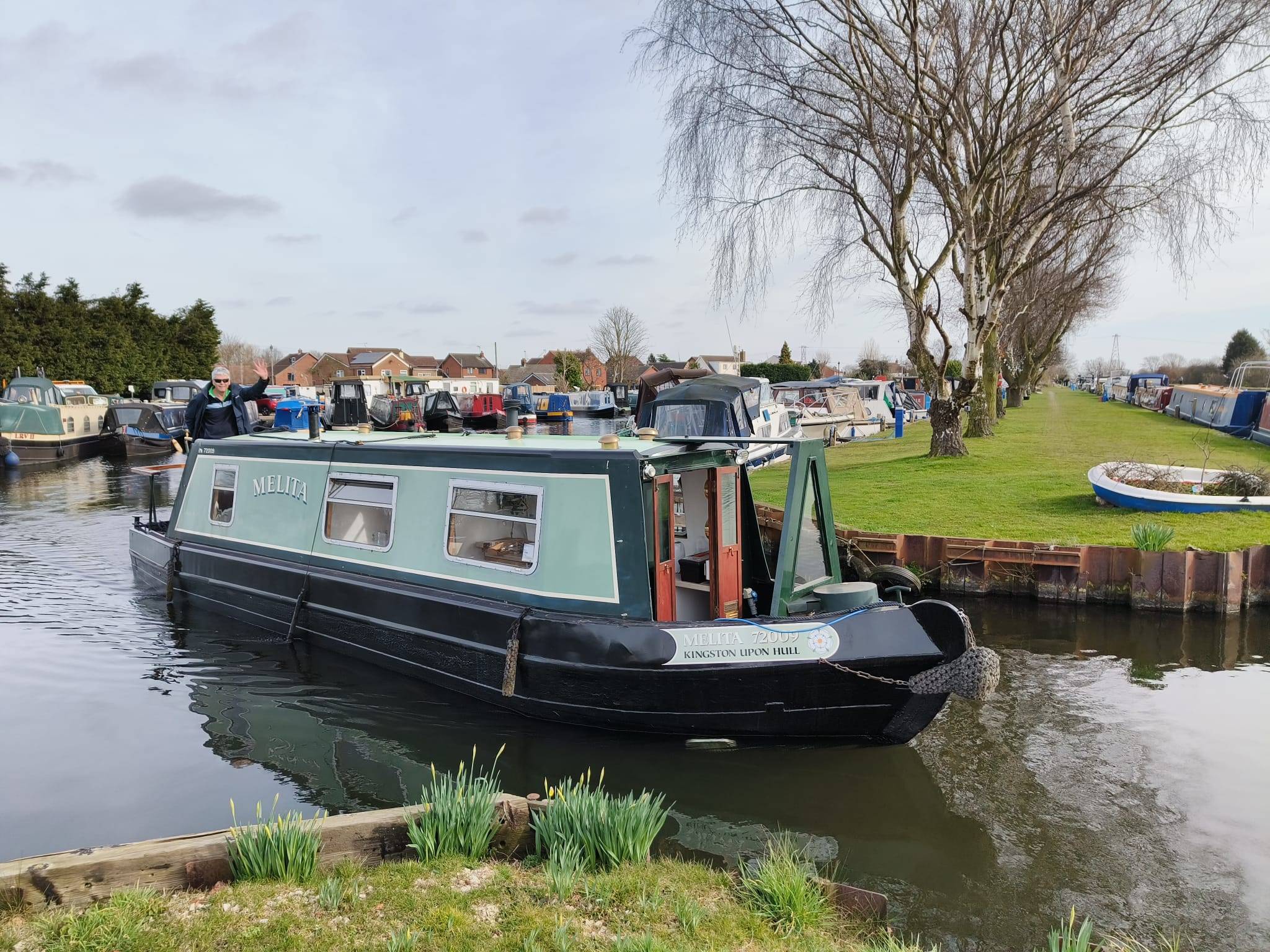

  6. 41 foot cruiser stern, very easy to handle, can turn in many places others can't, gets into those small mooring places too. Perfect for single handing in any situation.
