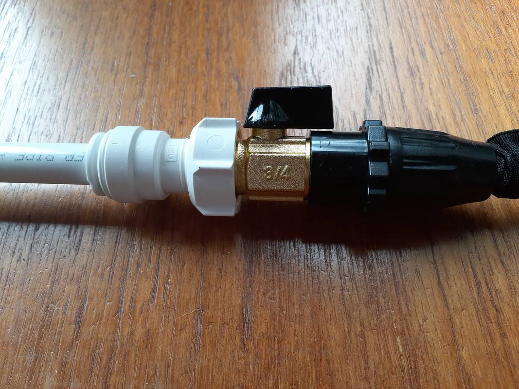

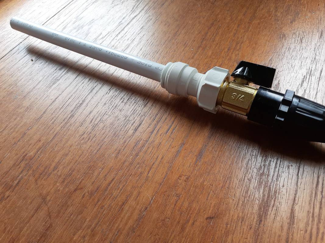

Standard Hoselock type  fittings are versatile and there is a good variety.
Should you need bespoke, If you have half-inch hose a piece of 15mm copper pipe can be inserted and retainex by a jubilee clip.  You can then fit a 15mm compression lever ball valve to the copper pipe and another piece of pipe to the valve.
The last piece of pipe can be modified to suit the tasks you have.  Open end fits in the tank filler,   Small holes drilled along the pipe give you a sprinkler, for example.
Note the advice above regarding  stop valvves and water pressure.

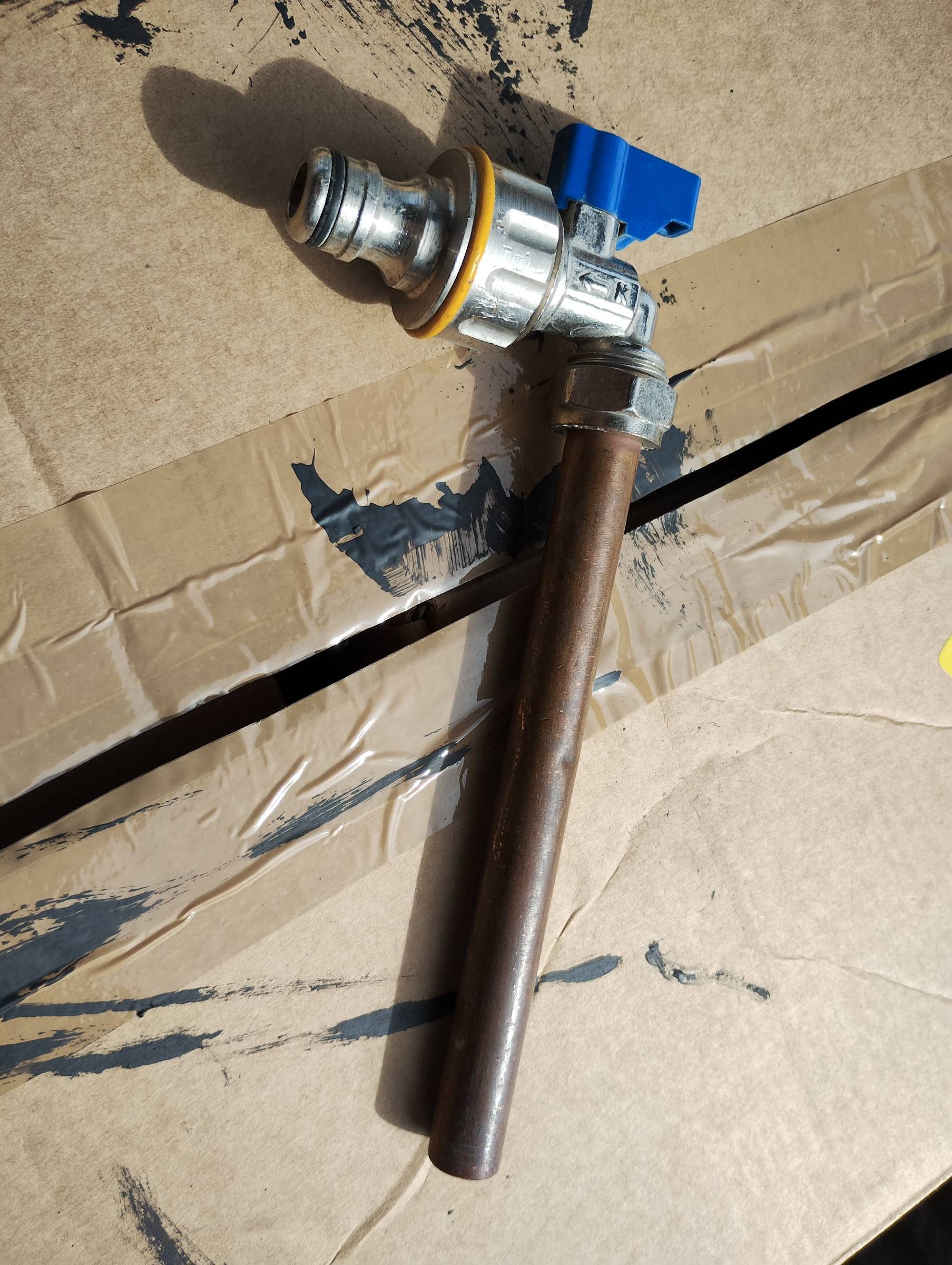

58 minutes ago, Alan de Enfield said:
Does it work OK ?
The direction of flow 'arrow' shows you are actually filling from the wrong end.
Yes. simple ball valve 👍
Indeed, but only relevant if you want a reliable long term complete seal when the valve is closed.

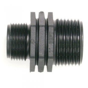

1 hour ago, Clanky said:
one these screws into your tank 1 1/4” to 3/4” bsp reducer then screw a hose lock adapter on the small end, when the tank is full and starts running out of the overflow turn the tap off, no need to sit and watch the tank filling.
I've got this setup but in a  plastic waste fitting end cap with the quick hose fitting glued in the end 👍 works great.
