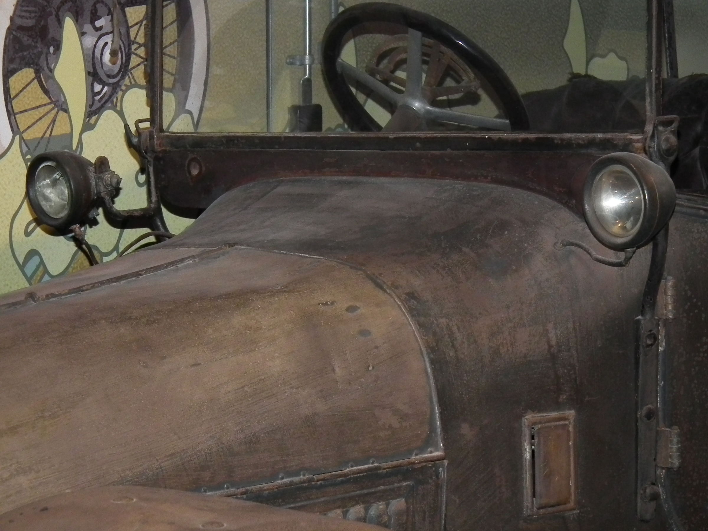

It was originally a sidelight from a 1914 Humber tourer, no I didn't nick it from the motor museum.

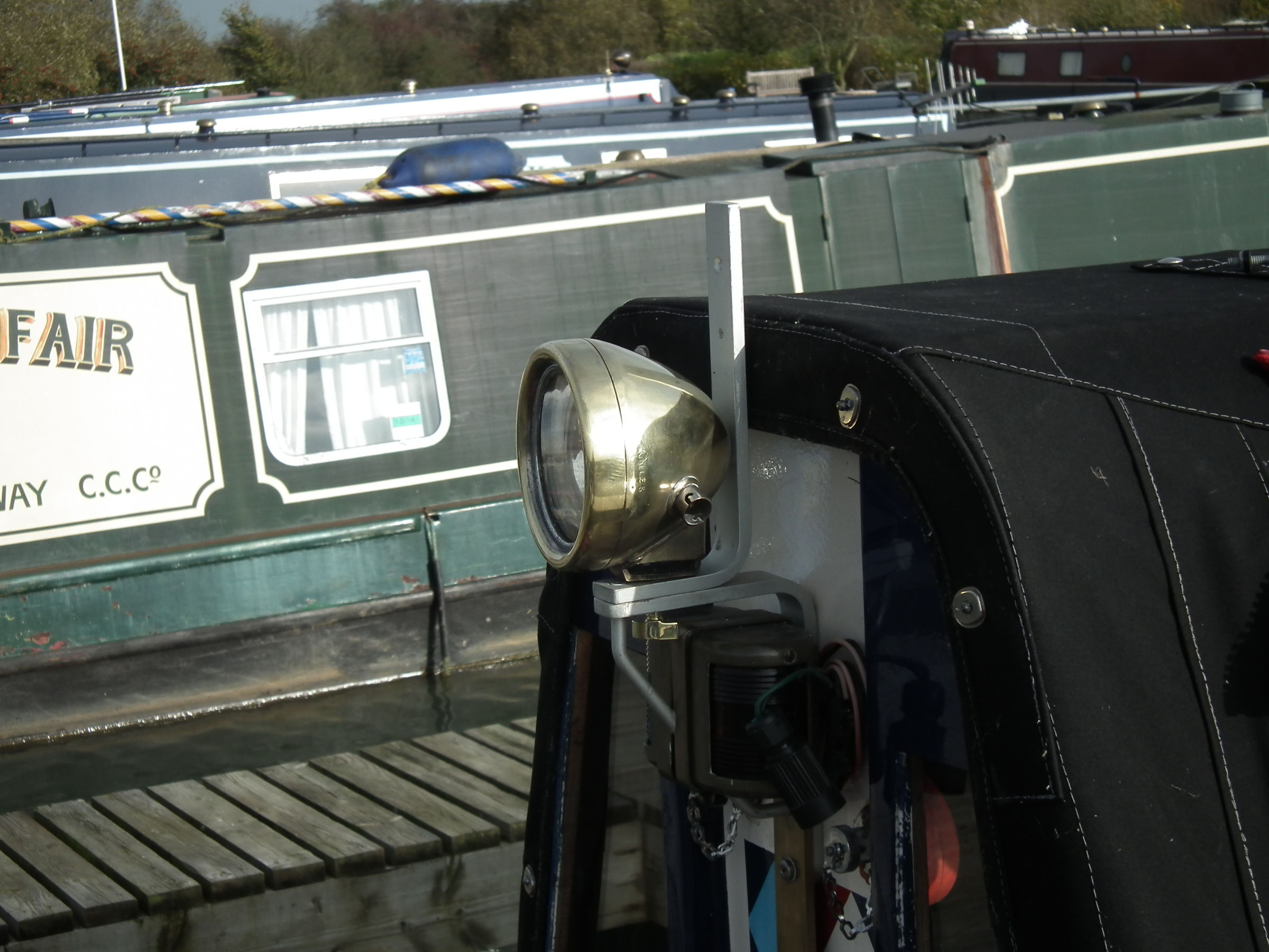

I'm with Ray here, all you need is a low power lamp, the one on Helvetia was a 1930's Lucas King of the Road fog lamp bought in a boot sale for a fiver.  Originally a 6volt unit, I modified it to take a 12volt 45watt tungsten bulb. Ours was angled upwards so that it shone on the tunnel roof, and was more than adequate.
