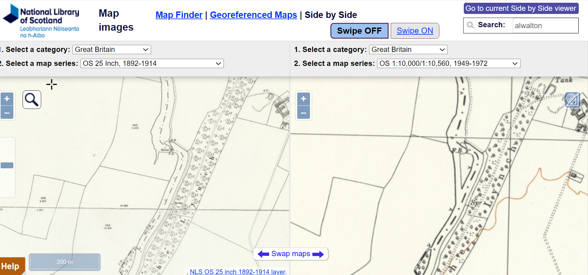

This is the one I had in mind at Alwalton - a new stretch of river was built to take out the kink! https://maps.nls.uk/geo/explore/side-by-side-old/#zoom=15.8&lat=52.55889&lon=-0.32293&layers=168&right=193
I think that's a flash lock, ie just one guillotine gate. When a boat wants to transit it is lifted and the boat either zooms downstream or is winched upstream as the levels equalise. I have seen photos of a very similar structure on the Brandon Ouse, near Hockwold. The remains of that are just about visible. I think one can also see the old lock structure downstream of Awalton, though I may be imagining that. One certainly can just below Lower Wellingborough lock (which looks like a 1970 structure rather than a 1930s one).

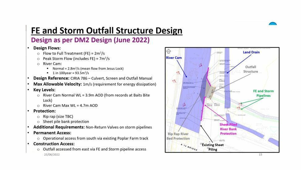

Helen is of course, as Chief Executive, representing the views of the Conservators (who employ her). I do think this subject has got somewhat garbled in the press coverage. There is no intention on the part of AW to "stop navigation on the Cam". But (as I said earlier) there is more to do to understand the precise impact (if any) on navigation of the proposed works, during construction and then permanently, and to ensure that the legal powers granted to AW are no more than are necessary. The other point I should add is that there are of course lots of other impacts of the project, for example on water quality and other environmental aspects, but these are primarily a matter for other agencies rather than the Conservancy. -
Anglia Water trying to Stop Navigation on the Cam
Scholar Gypsy replied to matty40s's topic in General Boating
I hope I can offer some reassurance here, as I am a Cam Conservator. We have been discussing this a lot for quite some time (and certainly since I joined in January 2023), to understand the nature of the structure, and the impact on navigation a) during construction and b) when built; and what that means for the powers AW are seeking. We have submitted lots of questions to Anglian Water, and as you can see from this article the Planning Inspector has just held the initial scoping meeting at the start of the process of approving the works. The Environment Agency will of course have a major interest - we are just the navigation authority. Here's a drawing of the proposed outfall - on the opposite side of the river to the existing one which will be removed. It does involve works to protect the bed from scouring, but the bulk of the concrete structure is actually behind the river edge. We are also interested in the rest of the project, which collects sewage from as far down as Waterbeach and pipes it south (upstream) to the new STW. This means that a number of smaller existing works (Waterbeach, Horningsea) can be closed, and a new tunnel built under the river between Bottisham lock and Clayhythe. PS The subject of this thread is somewhat misleading, IMHO. PPS here are some photos of Jesus Lock, currently with no gates ... https://scholargypsy.org.uk/2023/10/26/jesus-lock-cambridge/ -
