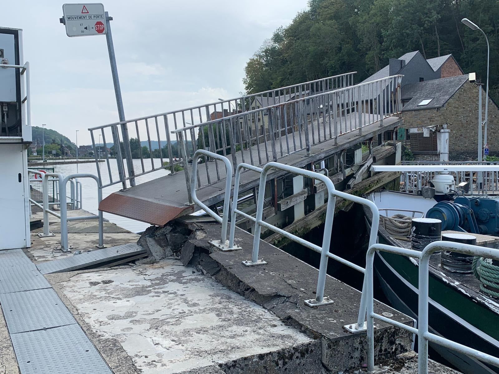

What happens if you push to hard (before any one tells me in this case boat appears to have caught under walkway as it rose in the lock, they never ever touch the gates here unless the locky opens the paddles too soon, the River Meuse was shut for 4 weeks)
