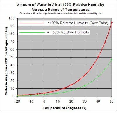

Murflynn Posted November 19, 2018 Report Posted November 19, 2018 On 16/11/2018 at 18:50, Naughty Cal said: We have all of our windows and hatches cracked open when we are on the boat and never get any condensation. It is never cold either. your boat is currently moored in Grand Canaria, right? ................ condensation in an unoccupied boat is almost inevitable unless you have plenty of ventilation - same as in a car parked outside in the colder months. Use the car, introducing warm air at a typical humidity of perhaps 50% on a relatively warm afternoon, then allow the air to cool overnight by perhaps 15C bringing the temperature below the dew point - the moisture in the air will begin to condense, first on the cold windows - and then everywhere else if you do not ventilate, so everything on the boat will go mouldy. It happens.
