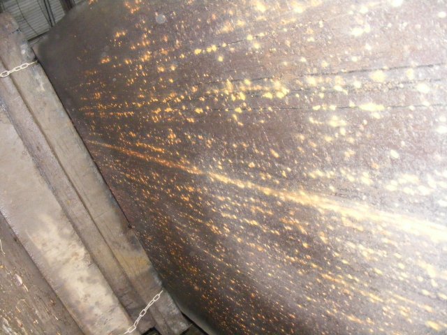

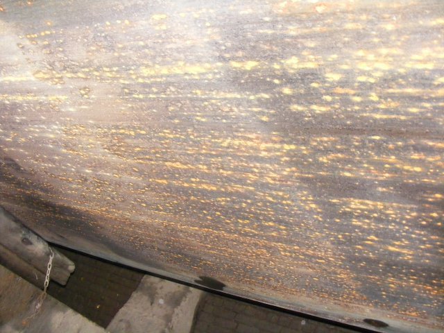

This was the bottom of Harnser when I was in Middlewich dry dock last autumn, I put the camera under the boat not my head. The boat was blacked underneath by Fox's on the ML back in April 2012 and they only use long handle rollers to do it. The interesting point is I have anodes half way down the sides of the hull and they line up where the bostock is and you can see a difference in the bottom in that area. You can also see how much of that black has been scraped off in five and a half years.
