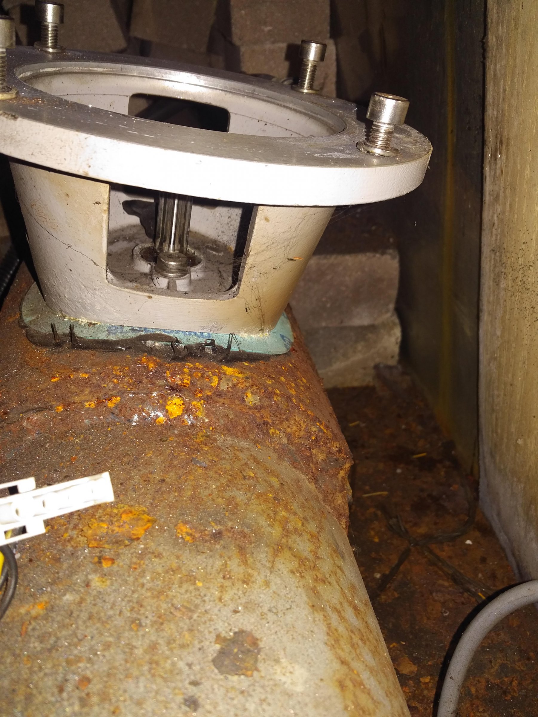

Haha. Fat boat, no weed hatch and mounted in the middle. How much wronger could it be. Anyway have welded in a nice high bulkhead now so when it eventually pops at least we don't sink -
Is this really how a bowthruster is fitted?
man1nvan replied to man1nvan's topic in Boat Building & Maintenance

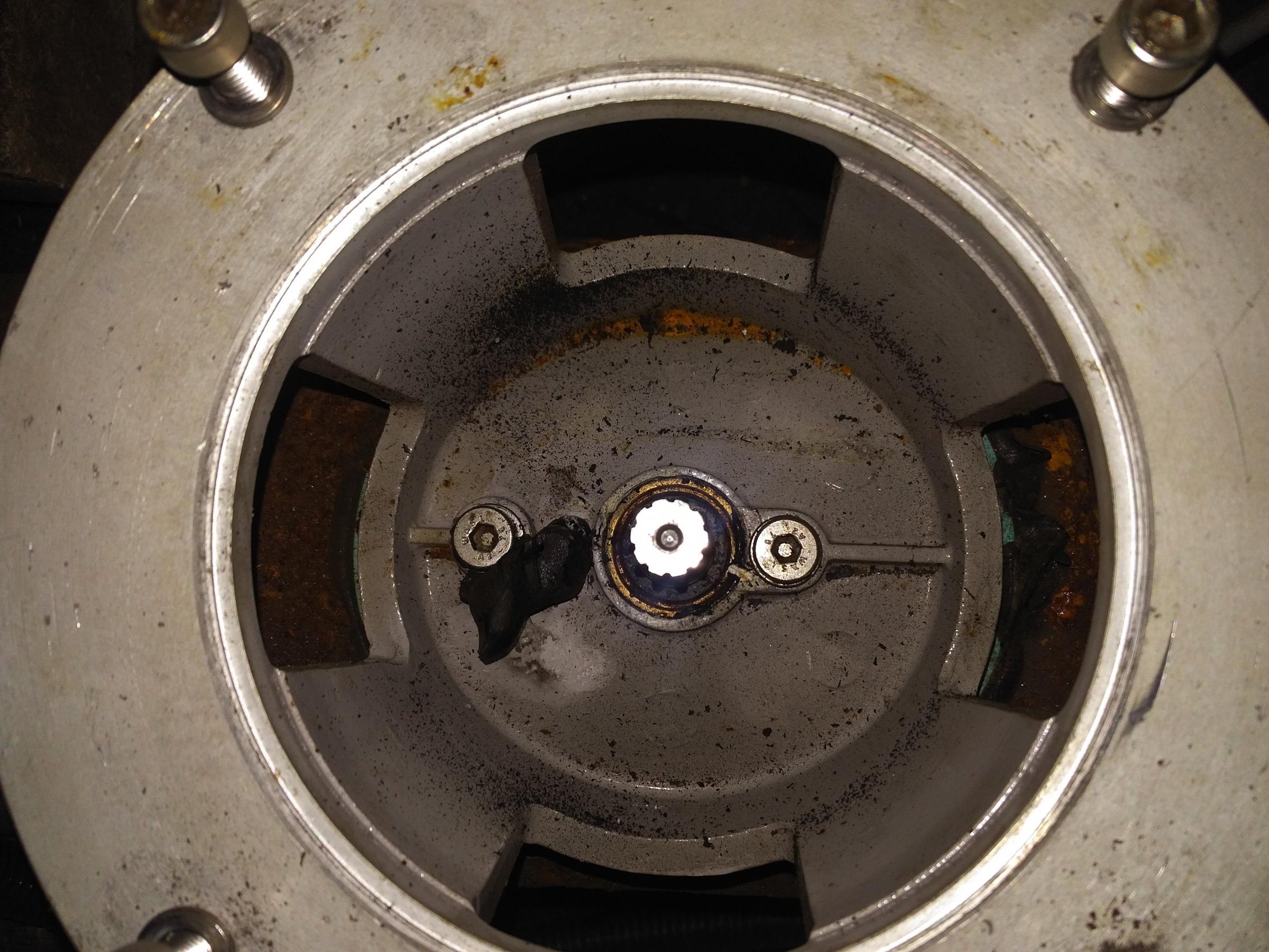

A bit of googling and that is just how they are. Have spent the rest of the afternoon welding in a bulkhead hopefully will finish tomorrow. I did want to remove the prop to clean the tube properly but I am a bit nervous about breaking the seal, if it ain't broke etc If you did pull the prop assembly out it looks like a bit of a game to get it back in again though -
Having cut an access hatch to get at my bowthruster (it must have been fitted before the deck!) I am a bit concerned at what is in there. Having removed the motor, the flange it bolts to appears to be held on to the tube with plastic and not much else. Is this normal? The view from the top shows the only bolts involved in the process I was expecting to find that the flange was welded to the pipe! On top of this there is no bulkhead behind the tube either. One solution is to weld the tube closed but I would like to keep the thruster since it is already there Advice welcome
