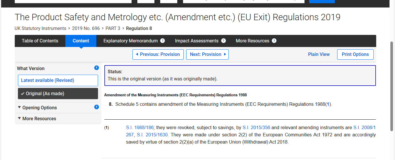

59 minutes ago, system 4-50 said:
Nowhere near half a gallon (and it was a metric toilet anyway🙂).
Obviously built prior to the (2019 Brexit)  revocation of the 1988 requirement to use metric measurements.
Edited by Alan de Enfield
3 hours ago, system 4-50 said:
I used the minimum flush on my Jabsco Deluxe Mascerating Flush for pees and a slightly bigger flush for bigger efforts. Nowhere near half a gallon (and it was a metric toilet anyway🙂).
Next he will be quoting pump out prices in Shillings or Guineas.
