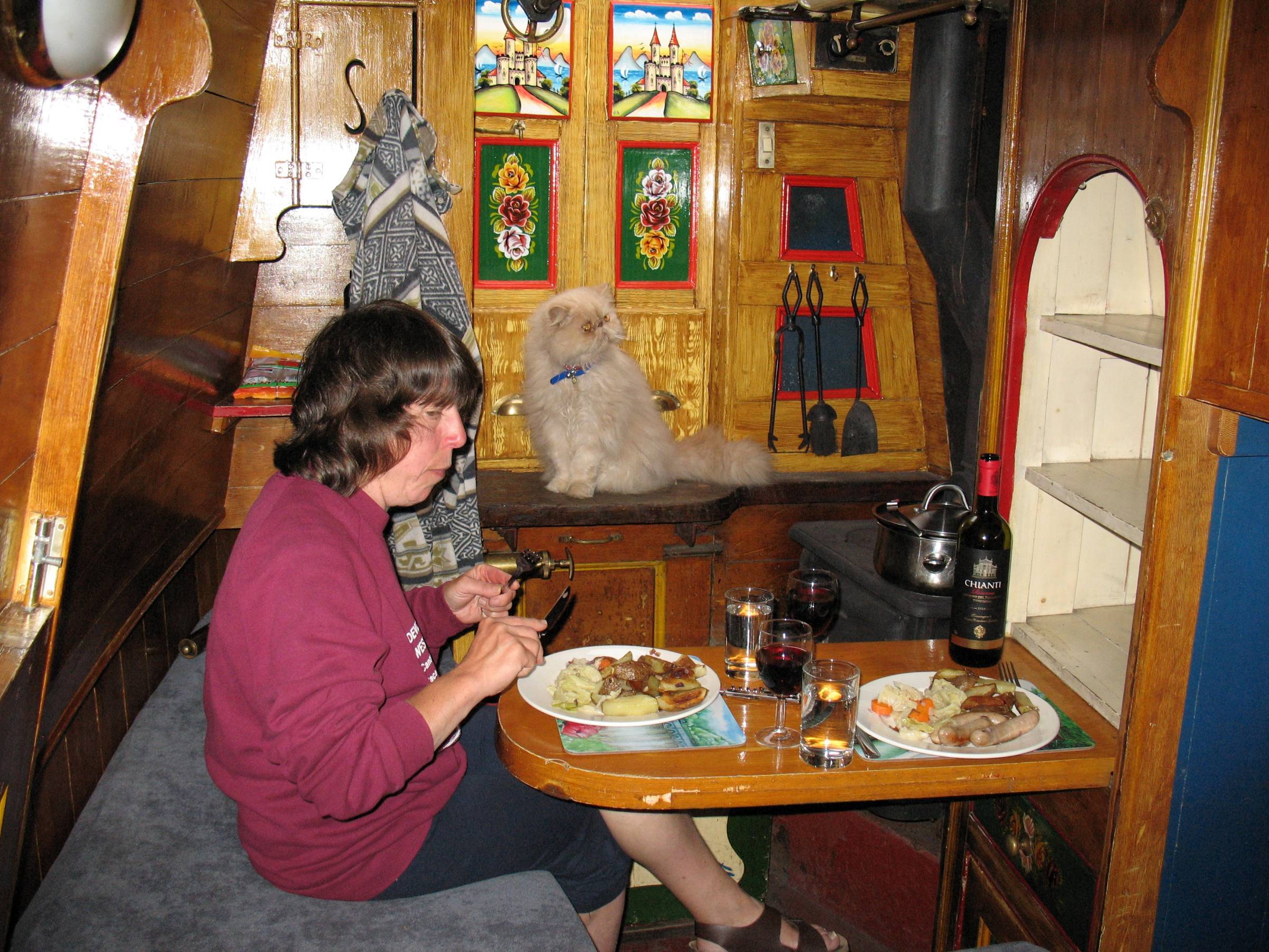

4 hours ago, Ken X said:
Indeed, this is us tucked up for the night after a days winter boating. Everything to hand and very warm when winter boating. Llangollen1.thumb.jpg.d44f81d1b2f031b7d26f37df4763339b.jpg
I'm a bit worried about this photo. Where's the GRAVY????!!!!!!!!!!
Can you not see, the cupboard is bare, there is no food. A far more worrying situation.
