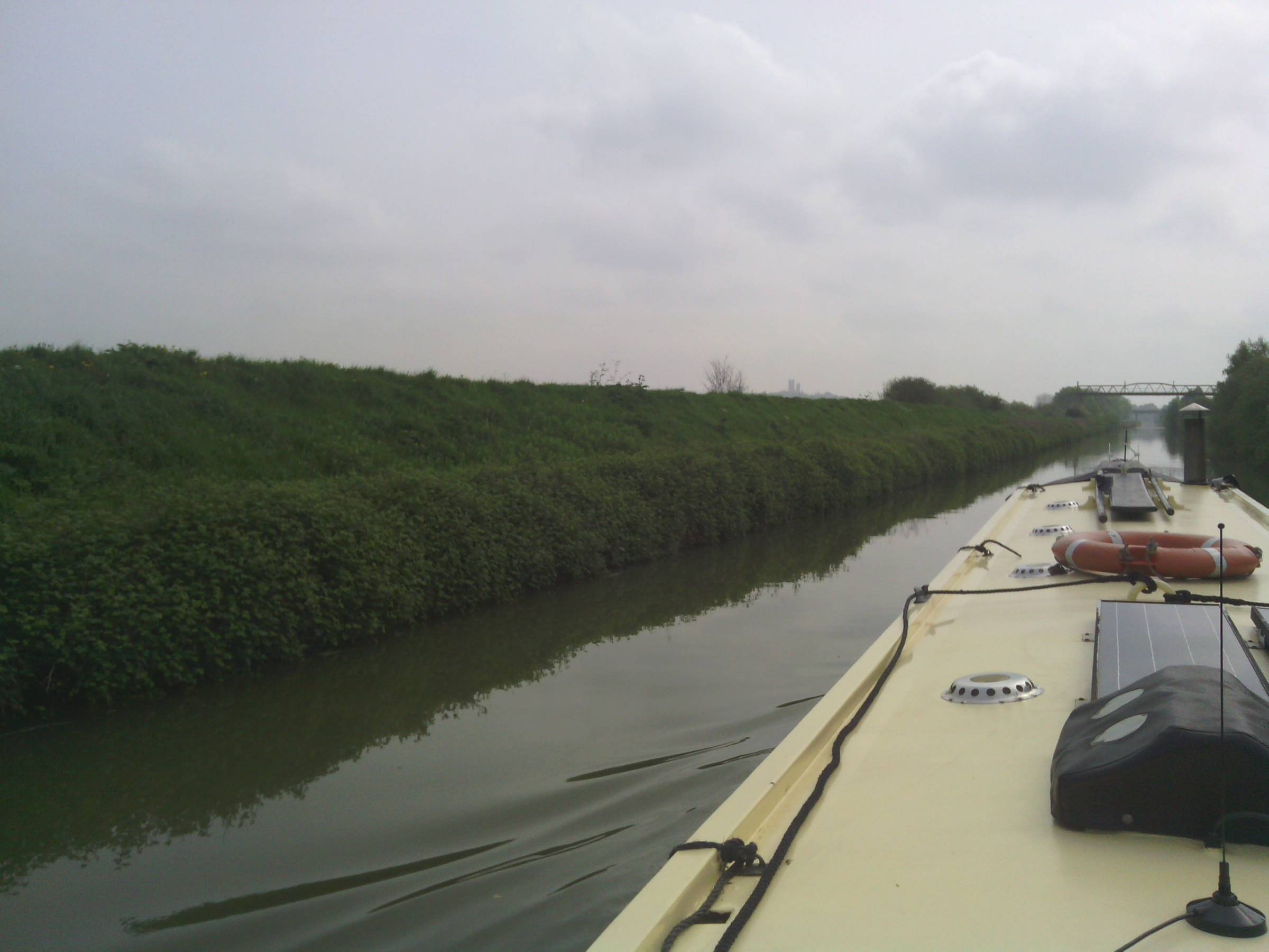

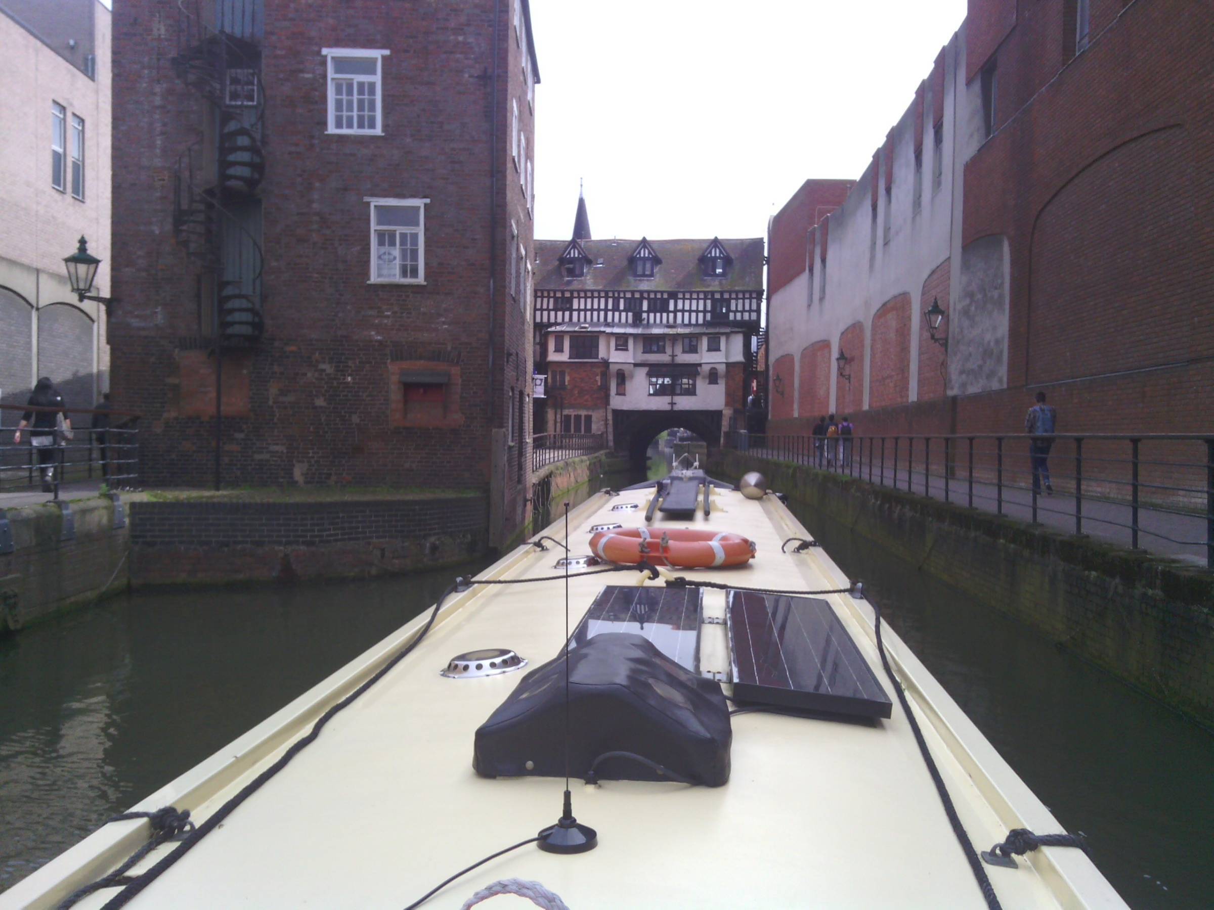

Lol, I didn't realise they custom made mini solar panels, very smart, and  extra tripping lines from roof to gunwales!

Is that Lincoln or York in the photo?
2 minutes ago, Alan de Enfield said:
The glory hole - Lincoln, and the Foss-ditch

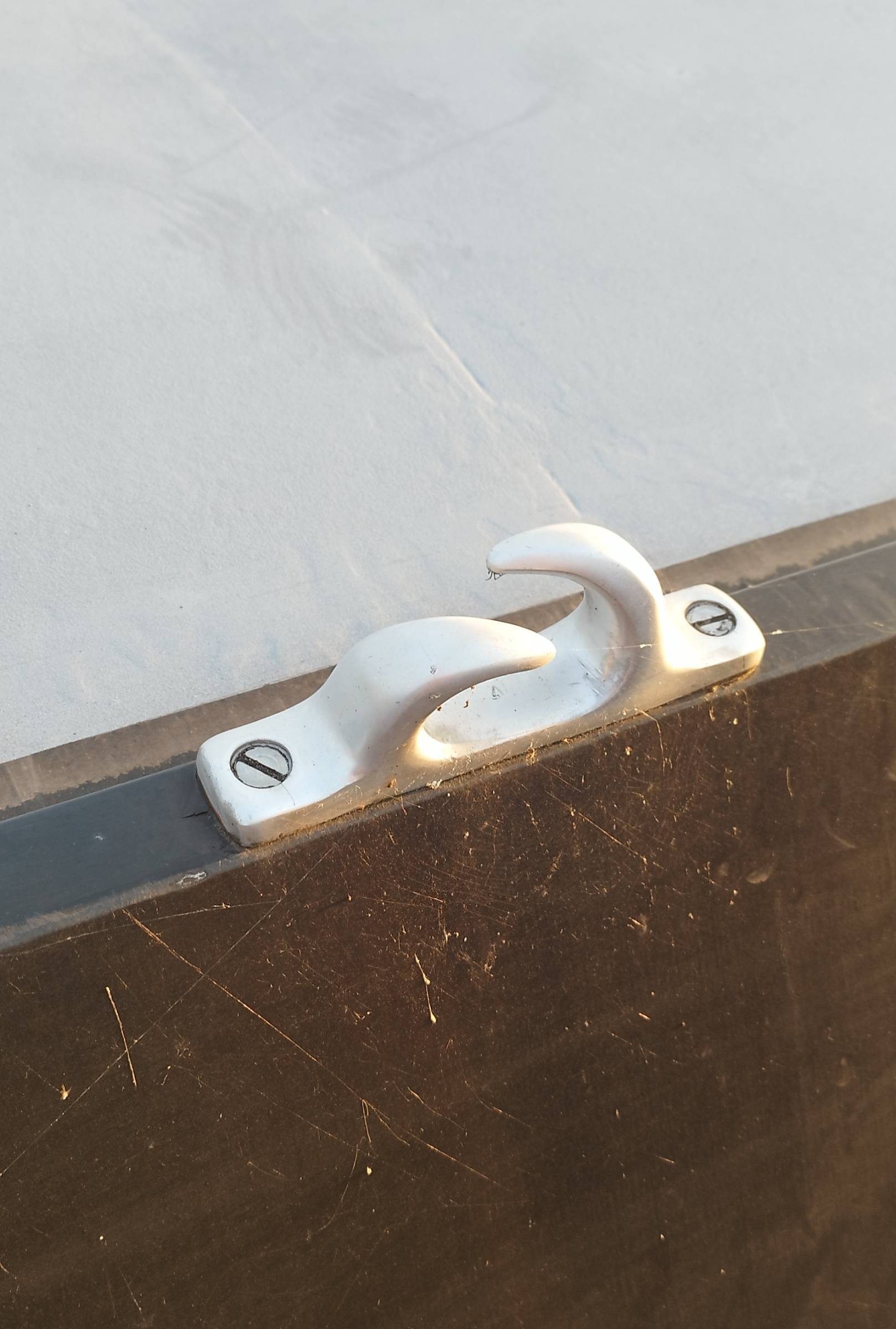

Wait until your see a fairlead ping off when the 5mm screws fail where they are tapped into 4mm steel
Fairleads are OK on a relatively light GRP cruiser, especially if they're bolted through to steel backing plates to spread the stress because GRP is known to be relatively fragile.
For a narrowboat weighing typically 18 tons the forces when strapping it to a stop are much higher, and the fairlead attachment -- as @ditchcrawler said -- is often pretty feeble.... <PING>... <AARGH>
Yup, I was once nearly hit by a flying one.  Not on my boat I hasten to add!
