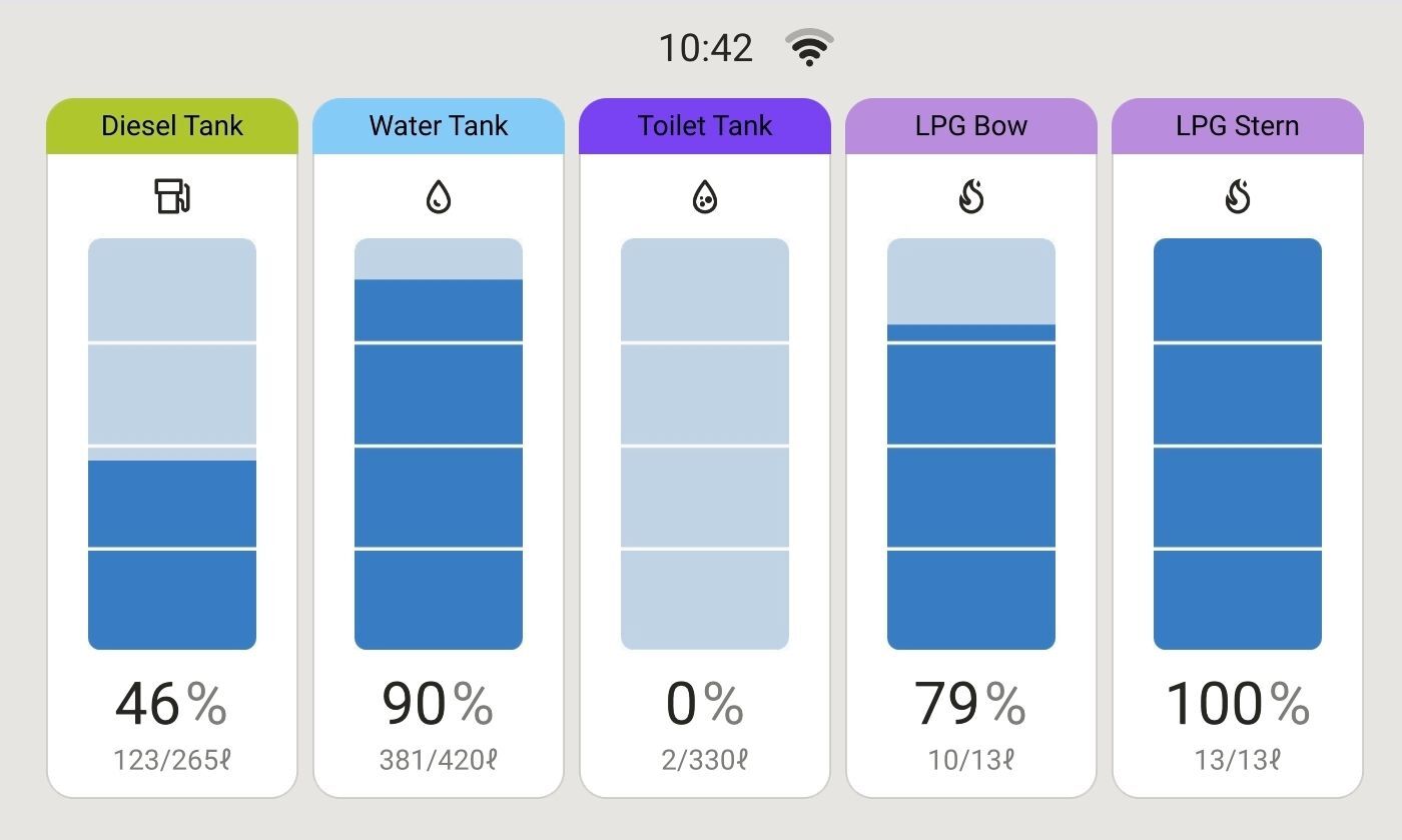

  5. I have fresh water, black water and diesel gauges from MCS. However, these are voltage based senders and to get them on the Cerbo GX you need the Victron GX Tank 140 accessory. The other thing you might he able to do for fresh water if you can access the top or bottpm of the tank is a Mopeka Bluetooth sender, but these need to be close to the cerbo as Bluetooth does not travel through steel bulkheads, or use a Bluetooth dongle on an extension USB cable. https://www.mcsboatproducts.co.uk/ https://mopeka.com/shop-our-products-mopekaiot/
