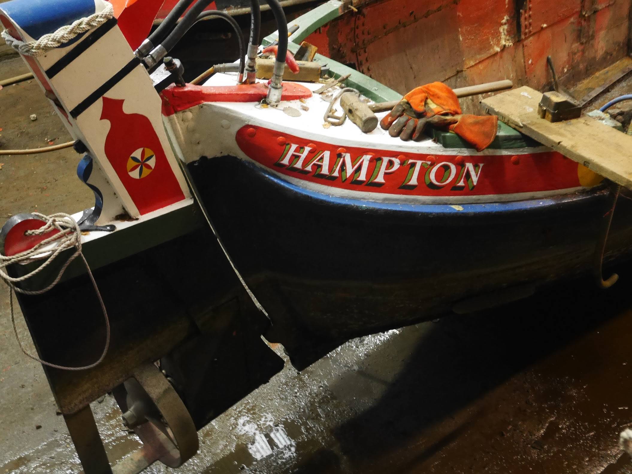

This is what we've done to Hampton with a hydraulic motor in the ellum.

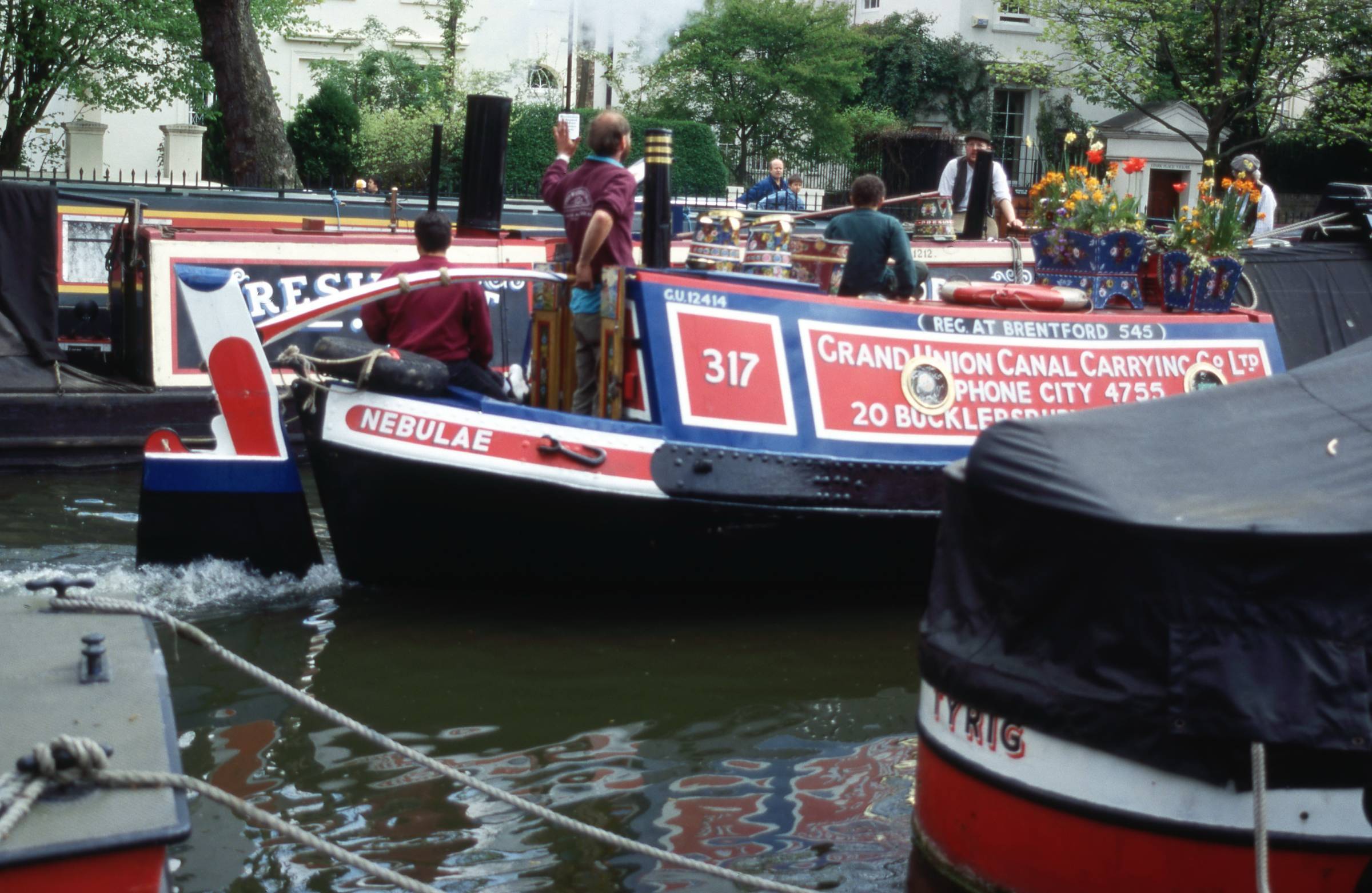

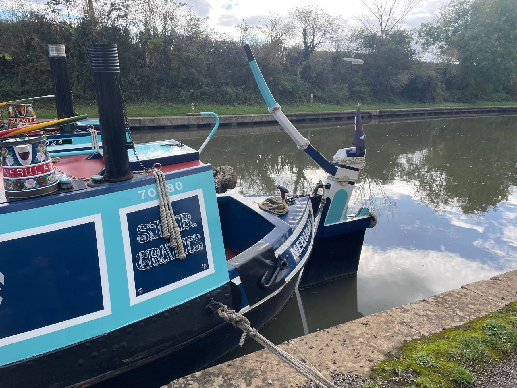

Theres Nebulae which I believe is now motorless but was fitted with one in the past. I suspect the current owners may have some before pictures that are needed here?

Nebulae at Canalway Cavalcade in 1996
A few more here:
317 Nebulae
Tim
Edited by Tim Lewis

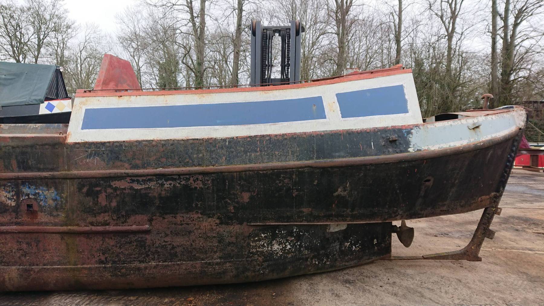

Hagley has the cavitation plates and stern tube fitted, although it has never actually had the engine installed. @Ben Jameson may well have photos. I based them on the ones on Samson which I have photos of if you would like them, although it is a former horse-drawn ice boat rather than a butty.

CAPELLA had an inboard engine with hydraulic drive to the stern. Don't recall the details but 'Admiral' will have them.
Capella was fitted with the hydraulic drive in the ellum by WFBCo.  Hampton was also fitted with the same system a few years later at WFBCo.  The replica steel rudder was fabricated by Ken Freeman.

I'd be very interested to see what Nebulae looked like below the water line.  How much of the stern was cut away to accommodate the propeller?  Did it have anti cavitation (ventilation) plates, I wonder?

Sue Cawson or Judith Clegg  may well have  some photos of 'Renown'.  That has a stern tube and ventilation plates with an SR3 under the hatches.  I think it was lifted more than once as part of the Aylesbury lift-outs,  so there should be photos of that around

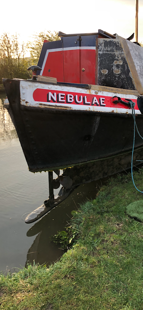

Here’s the best picture of Nebulae’s swim I  can find. The stern tube is not longer there and has been welded up, the swim remains.
It was motorised using a 4 cylinder Perkins positioned in the port rear side of the hold with hydraulic drive to the stern gear which has now all been removed.
