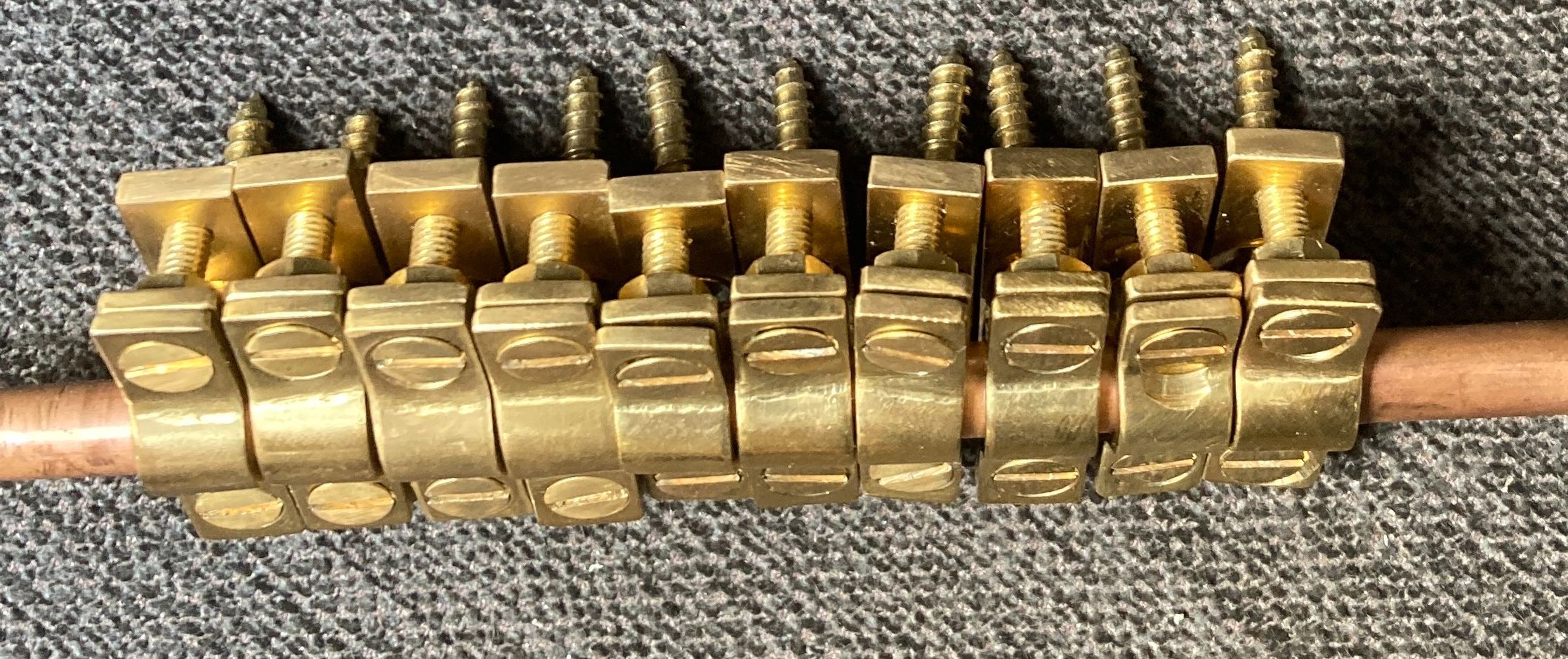

agg221 replied to Captain Fizz's topic in Boat Building & Maintenance
Took a bit longer than a day to fettle these, but I started installing them today. You would think you could buy 8mm stand-off pipe clamps, but apparently not. Alec -
