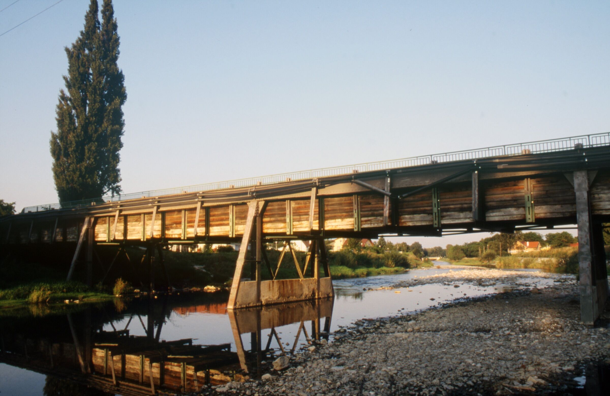

The Schwechat Aqueduct on the Wiener Neustadt Kanal, seen here in 2002. The canal was partially restored for powering turbines in some of the locks. -
