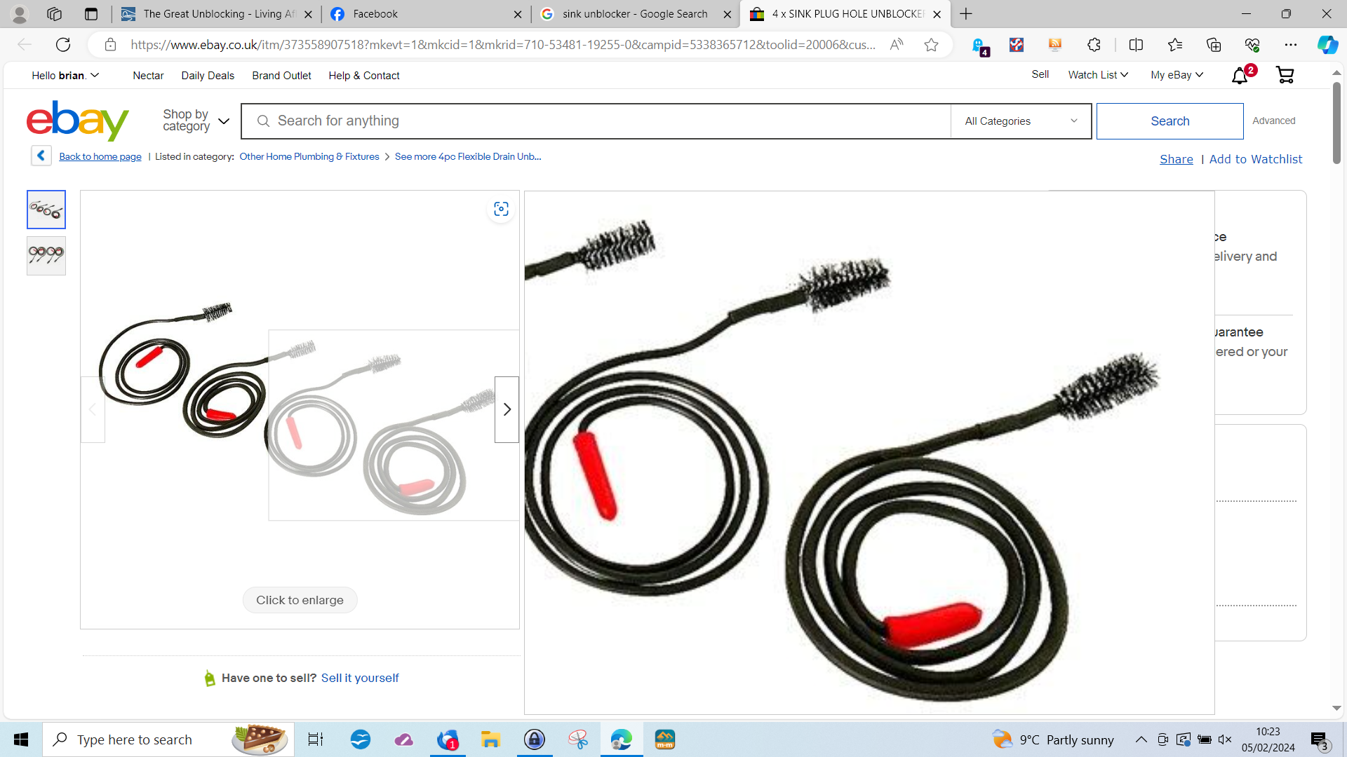

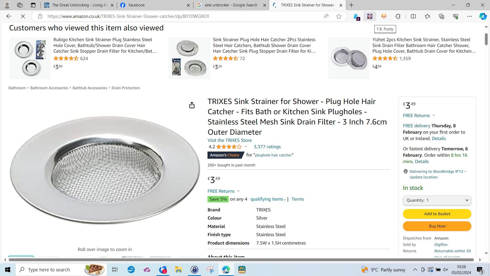

ditchcrawler Posted February 5, 2024 Report Posted February 5, 2024 (edited) 13 minutes ago, pearley said: When we had a share in Sundowner I think I was the only one who cleaned that cylinder of wire, the filter. Was always blocked with hair. I found that to be a weekly job when we had a share boat, now we have a filter in the plug hole is 40 minutes ago, pearley said: One of these is good for pushing up the waste pipe from the outside. Do it with a tap running and you can see the muck coming out. Also useful for cleaning deck drains. https://www.diy.com/departments/120cm-long-flexible-radiator-cleaning-brush/5060507281079_BQ.prd?gad_source=1&gclid=CjwKCAiAq4KuBhA6EiwArMAw1GAcIuTyYw3jKi_YvZ9-QZauKNoYyKnSW4GwdpZUoo6q23w47-pE-xoCqfsQAvD_BwE&gclsrc=aw.ds This is what I use Edited February 5, 2024 by ditchcrawler
