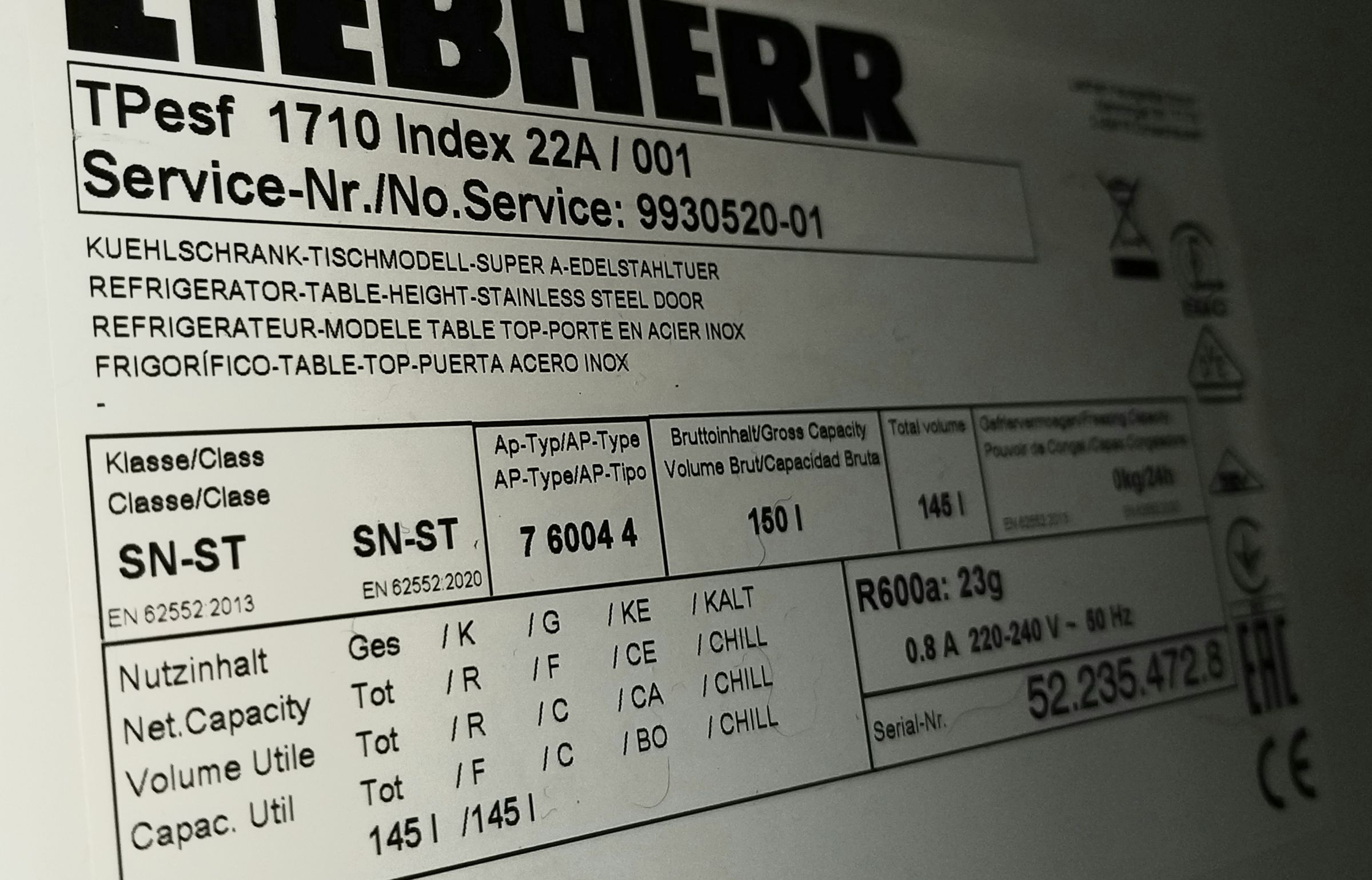

I personally cant fault this one...20221019_193106.jpg.28c5e4b718030dc657ce1838c65324da.jpg
Installed 18 months ago to directly supply a Lieberhh1710  150 litre capacity fridge. Hasnt missed a beat, even in this years record temperatures, and we were within 0.1c of the national record breaking temperatures 2 days on the trot.

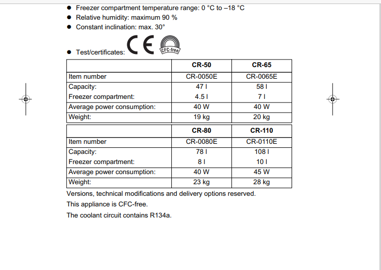

3 hours ago, jonathanA said:
50w seems unfeasibly small to run a compressor in a fridge are they really that small ?
No, its actually more than 20% higher than most marine fridges.
Mine is 40w. (CR80) and has a measured <30Ah per day.
Yes but we were talking about mains fridges running off inverters.
I have the CR65 and a total freeze 45 fridge/freezer and that is 45w.
So I suppose mains fridge compressors could be the similar.  So quite surprising that fairly large inverters struggle with them...

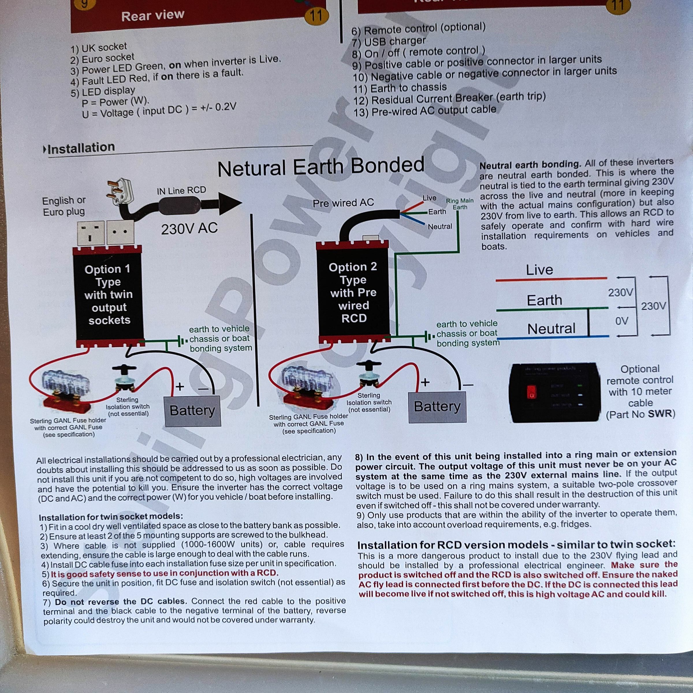

Pay attention to the earthing arrangements of the inverter. The cheap ones on Amazon and eBay tend to have a floating earth. What you really need for a boat with a mains ring, consumer unit and breakers is neutral-earth bonding otherwise your breakers won't work in the event of an earth fault.
I recently sold my Sterling 1800w MSW for £50 and replaced it with a Sterling 2200 SB (R) PSW model (£500 from Cactus). Both inverters are N-E bonded.
I previously bought an 2000w inverter from Renogy for £250 not realising it wasn't N-E bonded. When I asked them if the output could be bonded they told me it couldn't so I sent it back. In my opinion it's criminal that the specs on so many of those cheap inverters don't detail the earthing arrangements. It could end up killing someone. If you can't find it in the product specs assume it's floating earth.
From my new inverter manual.
