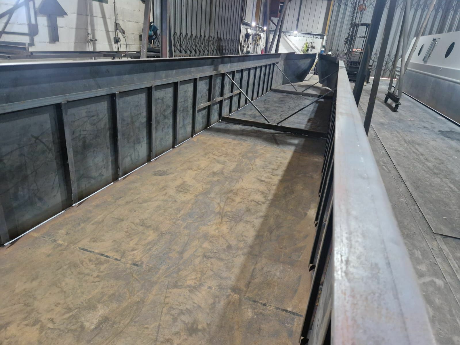

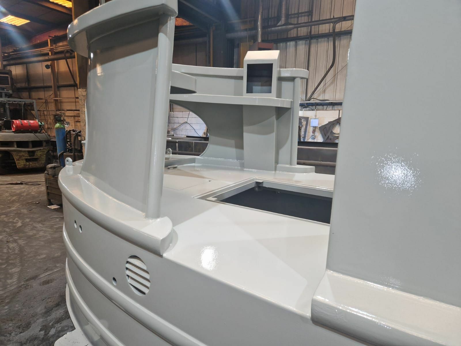

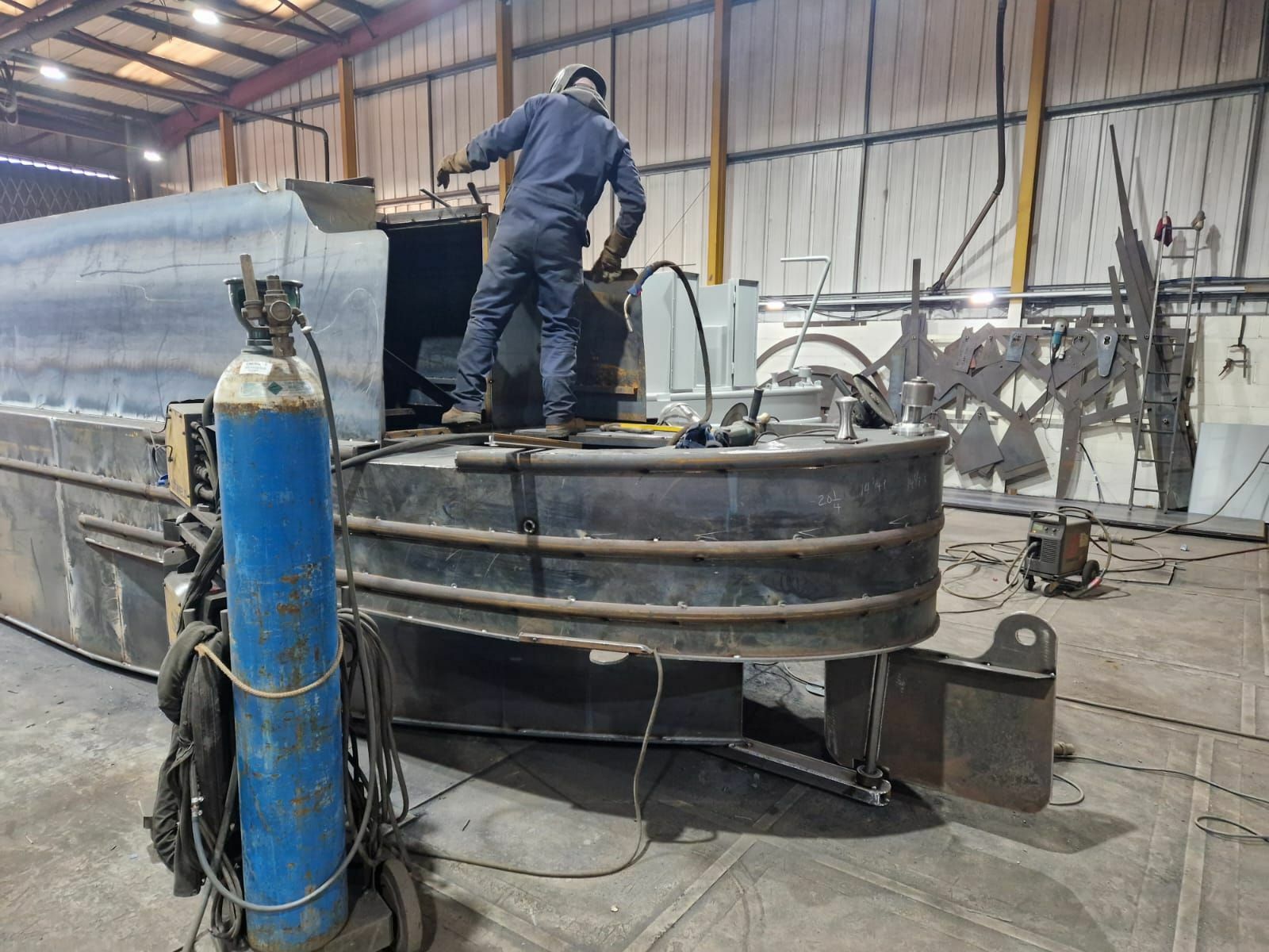

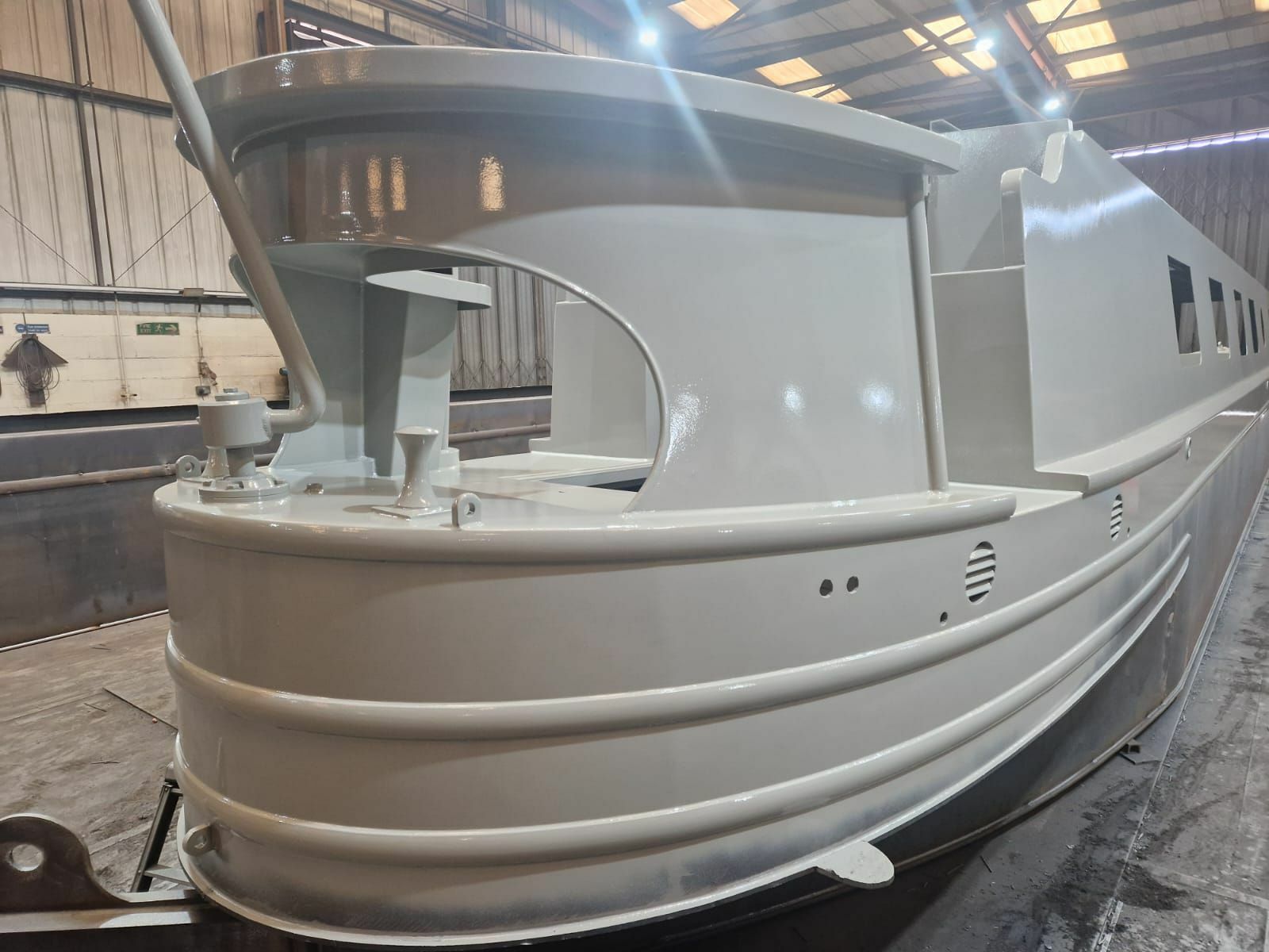

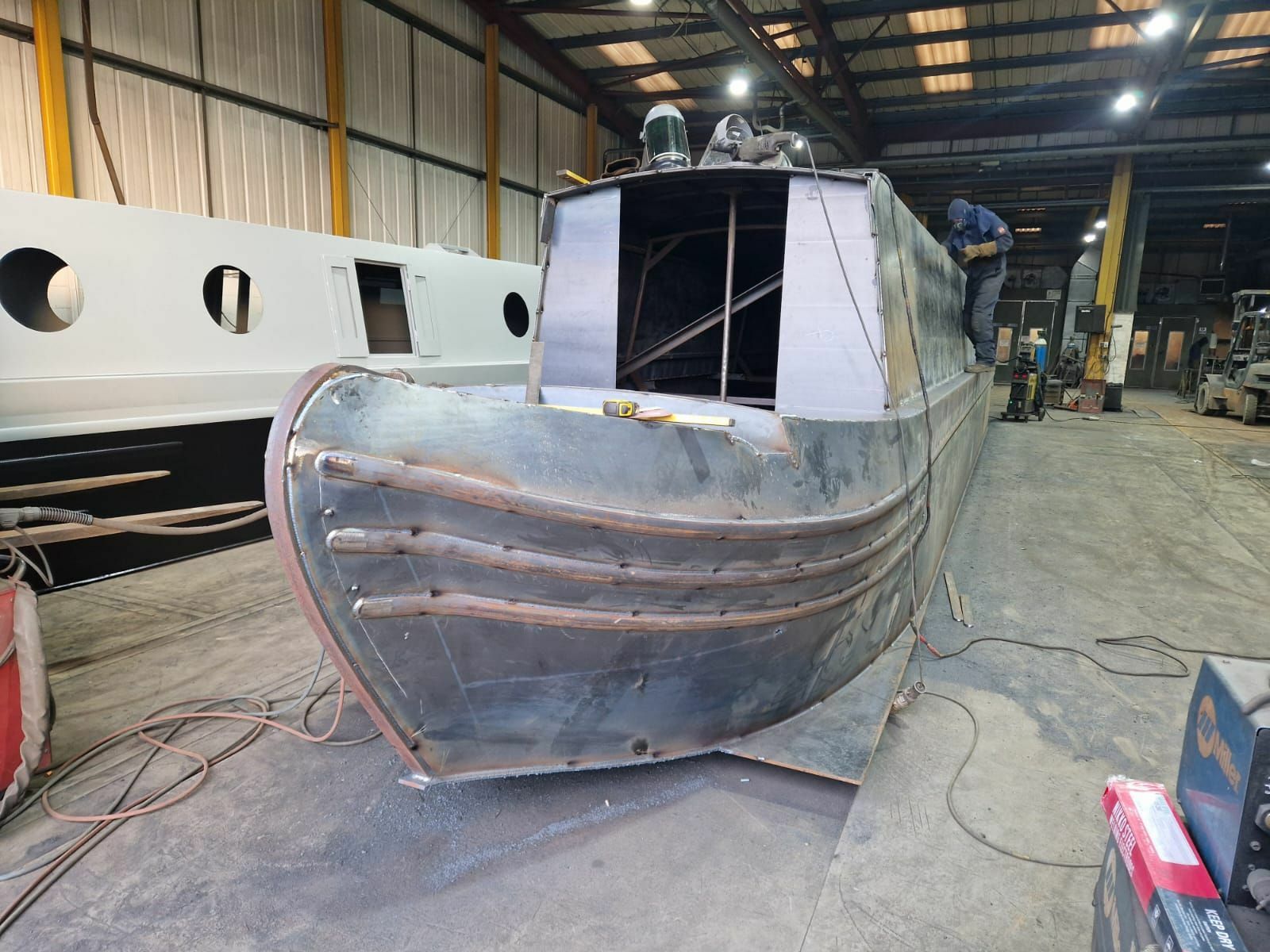

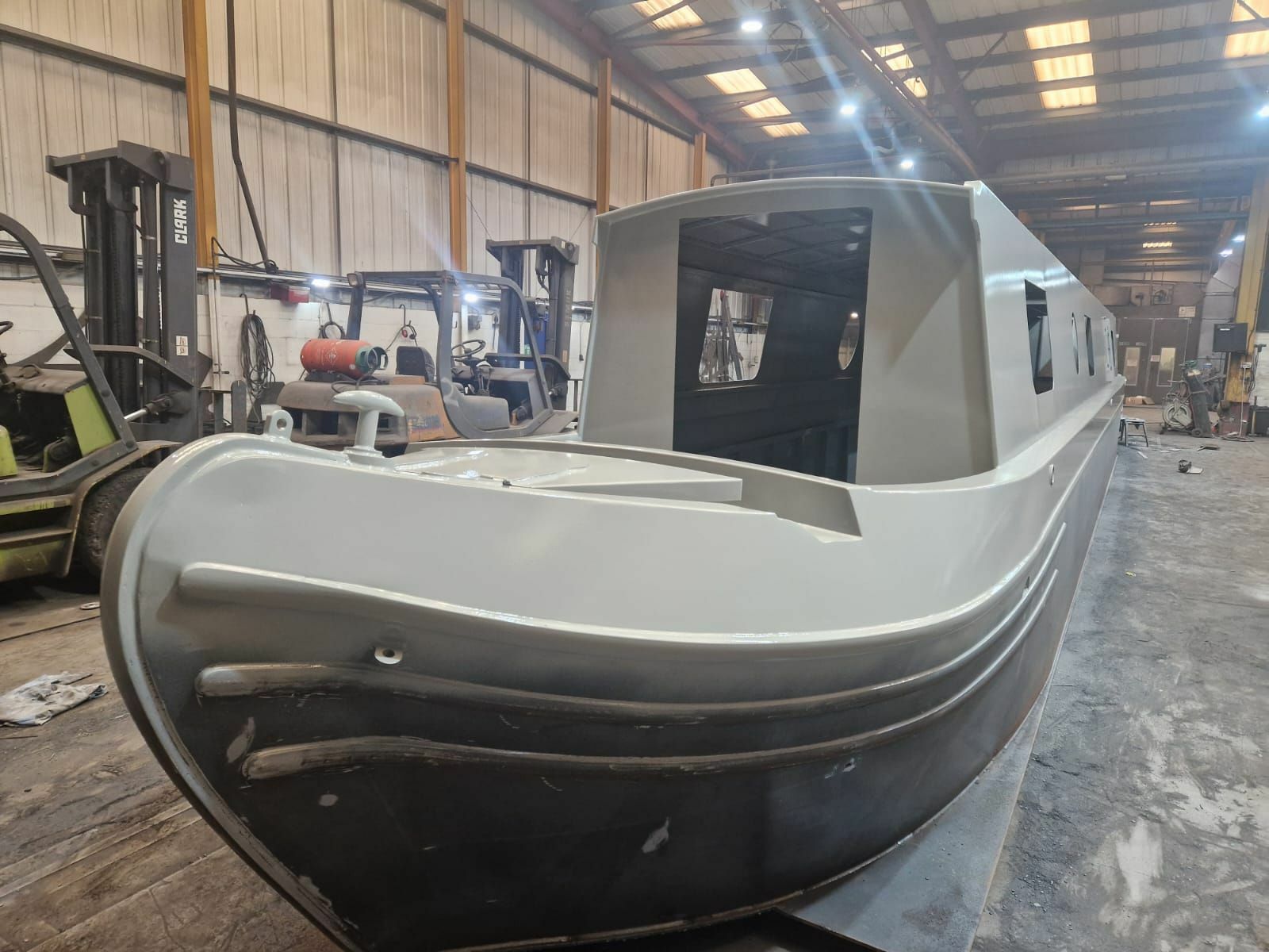

After over a year of planning and research. Finally started the new build. It will be a 60ft cruiser with reverse layout. Hull by Tim Tyler with Lymm Narrowboats getting it to sail away with some extra bits done for me such as the eberspacher and calorifier.
