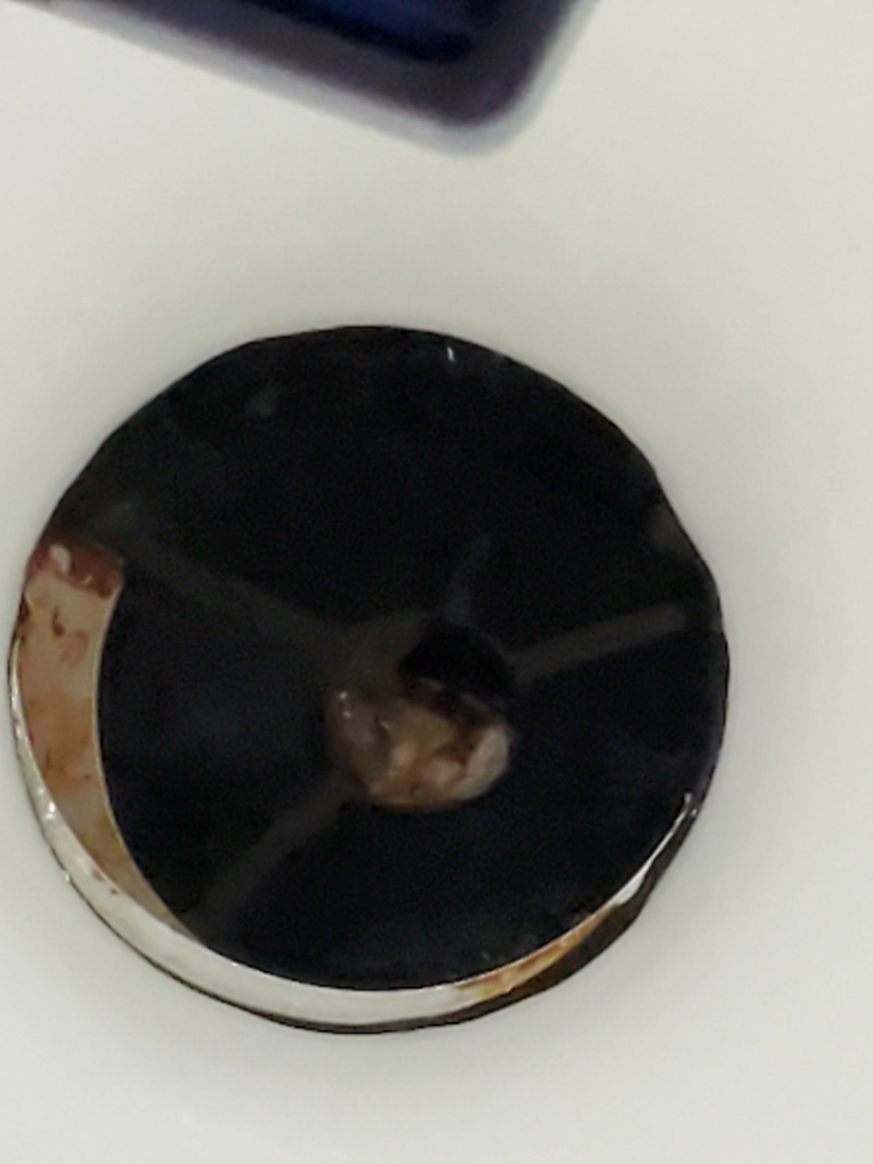

Hi all
Thanks for all the tips. Finally got a photo from inside the loo. A bit obscured as when I push the lever water flows which affects the camera focusing.. A boater moored near me suggests it might be a macerator but I really still don't know
#42
That looks like a dump-through with the pedal pushed down because I can see part of the semi-spherical "flap".  However, to identify the toilet we need a view of the front of the toilet and whatever you push or pull to operate it.
