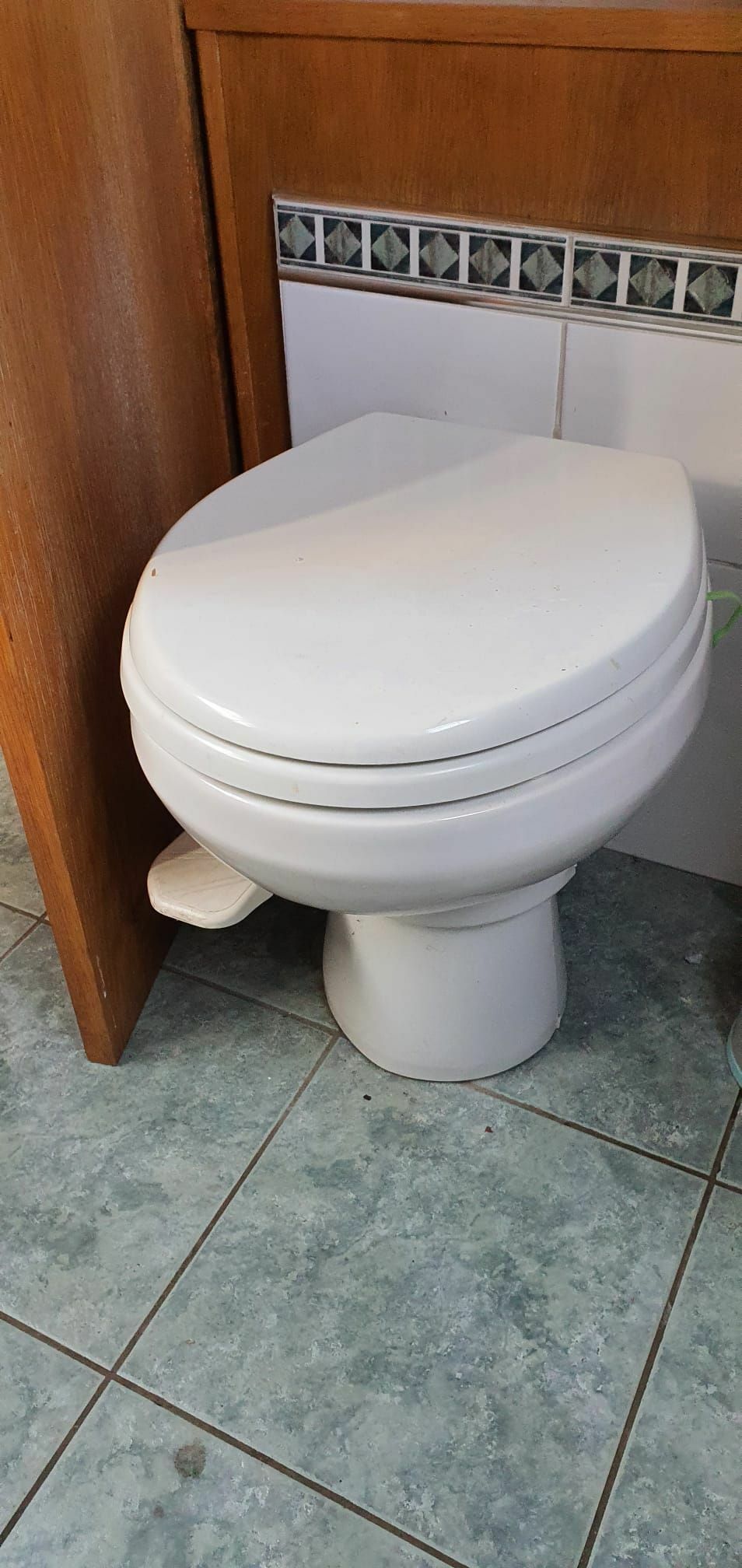

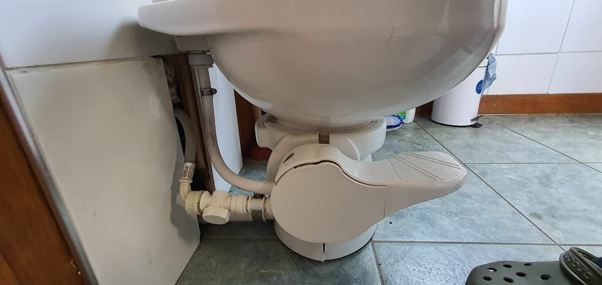

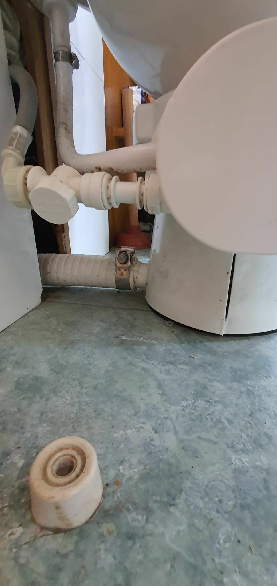

Anyhow the photos have finally arrived you'll all be pleased to know
Well, its not what I would call a 'dump-Thru' (where the toilet sits directly on top of the holding tank)
The "output" is piped away from the toilet to a tank hidden away somewhere.
I don't think it is a dump through because of that big corrugated plastic hose. Dump troughs do not have those. The base looks rather small to contain a macerator and motor so probably a vacuum toilet. If any effluent lies in that hose you are likely to gets smells through the hose wall and thus inside the boat and the first photo you put up showed effluent and paper lying below the bowl.
