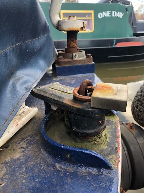

My boat has a pokey out fuel cap(technical term), it is currently only tightened with a wrench which obviously isn't very secure. I've been looking online for clever solutions and I can't find anything off-the-shelf that will work. I found a boat with the same design as mine as they have got a lock on it, any idea where I can find these? Or any better ideas? picture below for guidance

We had a short length of chain welded to the top of the cap, drilled a hole in the raised lip and used a decent padlock.
Passed any subsequent BSS inspection.
Won't stop the "professional" but will the "opportunist."
Edited by Ray T
We have the same except chain is padlocked to the stern fender chain so could be undone by a thief but would require all 4 fender fixings being undone.

This is our fuel-cap lock.
Can be cut off with a battery angle grinder but is sufficient to deter anyone not 'equipped'.
I've got something very similar. It won't deter any serious attempt at theft but at least I will know.

The easiest and cheapest way is to drill a hole through the cap and threaded upstand and then fit a padlock with a long shank.through the hole you have drilled. I done that on my boat . One thing to remember is place a magnet near where you are drilling to collect the swarf.  A small amount is bound to  get in the diesel tank but will sink to the bottom and in the unlikely event of being picked up will be caught in the fuel filter.  Obviously a really determined thief with a cordless grinder will soon cut the lock off . Screwfix or Ebay  should be able to provide a suitable padlock .
I made something very similar.
The hasp is fixed to the raised lip which diverts diesel spillage over the edge using a couple of m8 bolts and shear nuts.  Not impossible to undo, but as they are under the hasp difficult to get at.
The cap is drilled and tapped and fitted with an m8 bolt from underneath with a bit of epoxy to make it gas tight and to stop it from undoing.  Onto this a screwed an m8 eye, sized to fit the hasp. The bolt protrudes through a bit which I bashed with a hammer and chisel to to prevent the eye unscrewing.
The eye can rotate about one turn, which means that when the hasp comes over the eye can rotate to line up with the slot, so no worry about alignment.  The eye itself will not rotate when the hasp is in place, and rotating the cap tightens the eye onto the cap, so reasonably secure against simple tool and brute force opportunist attack.
I also used a new stainless cap, as the mild steel cap used to get a bit rusty inside and would bind to the inlet pipe.
So far (10 years) I have not had any diesel theft.
Edited by Chewbacka
