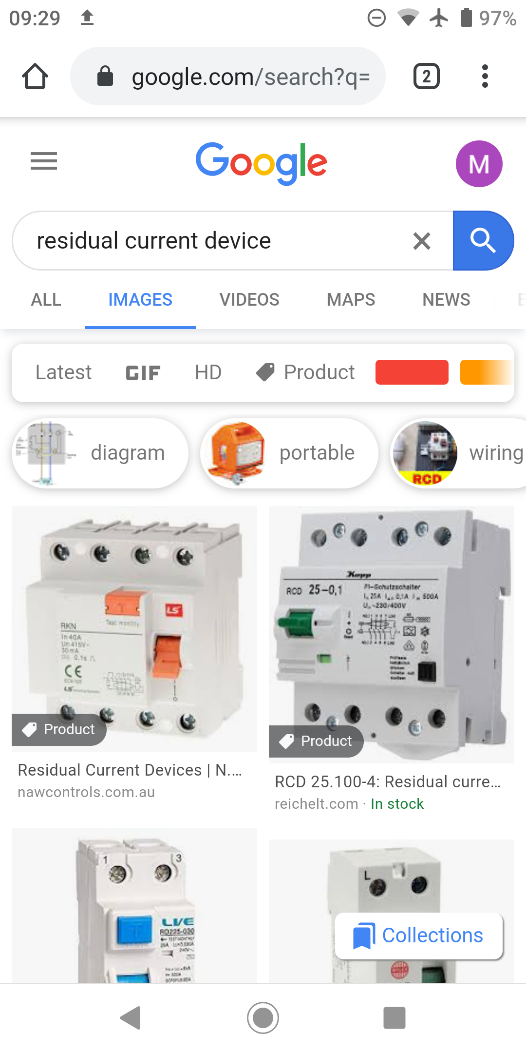

blackrose Posted November 9, 2019 Report Posted November 9, 2019 On 08/11/2019 at 09:17, Alan de Enfield said: Jen makes an excellent point, and one to which you are probably thinking "what the hell is the RCD". The RCD is the "Recreational Craft Directive" which is a set of standards and specifications to which leisure boats should be built (everything from the type of engine to the type and size of electric cable to the number of people that can stand on one side without it tipping over. There are 1000's of pages of specifications. There is an exemption (as Jen mentioned) for Home build narrow boats but the law states that if you have not built it and certified it to the RCD then you cannot sell it for 5 years after completion. If you need to sell it then you 'should' have a post construction survey and any non-compliant items replaced / corrected. There are of course some who don't worry about the RCD (either as buyers or sellers) and the cases of going to court for selling without an RCD are few, but they do happen. I purchased a boat (market value of £250,000) which hadn't sold because the RCD documentation and the VAT Certificate of payment were 'not available'. I made an offer of £180,000 and it was accepted. Paperwork is 'valuable' to some and ignored by others - you can only make up your own mind which camp you fall in. Just done a quick Google search and here is one example : He didn't use the correct safety glass in the windows, he didn't screw the stove down & he was fined £2100 and now has a criminal record. Serious non-compliances can result in a fine of up to £50,000. https://www.boatingbusiness.com/news101/industry-news/narrowboat_builder_fined_for_rcd_offences The other option is just to buy one and install it on your boat. Much simpler and cheaper. When the inspector asks to check your RCD you just show him one of these. 1
Alan de Enfield Posted November 9, 2019 Report Posted November 9, 2019 5 hours ago, blackrose said: The other option is just to buy one and install it on your boat. Much simpler and cheaper. When the inspector asks to check your RCD you just show him one of these. I'll take that in the spirit intended - BUT - I will suggest that it is not a particularly useful post to a newby who hasn't got a clue what will be involved, the use of the correct terminology, or the forum humour.
