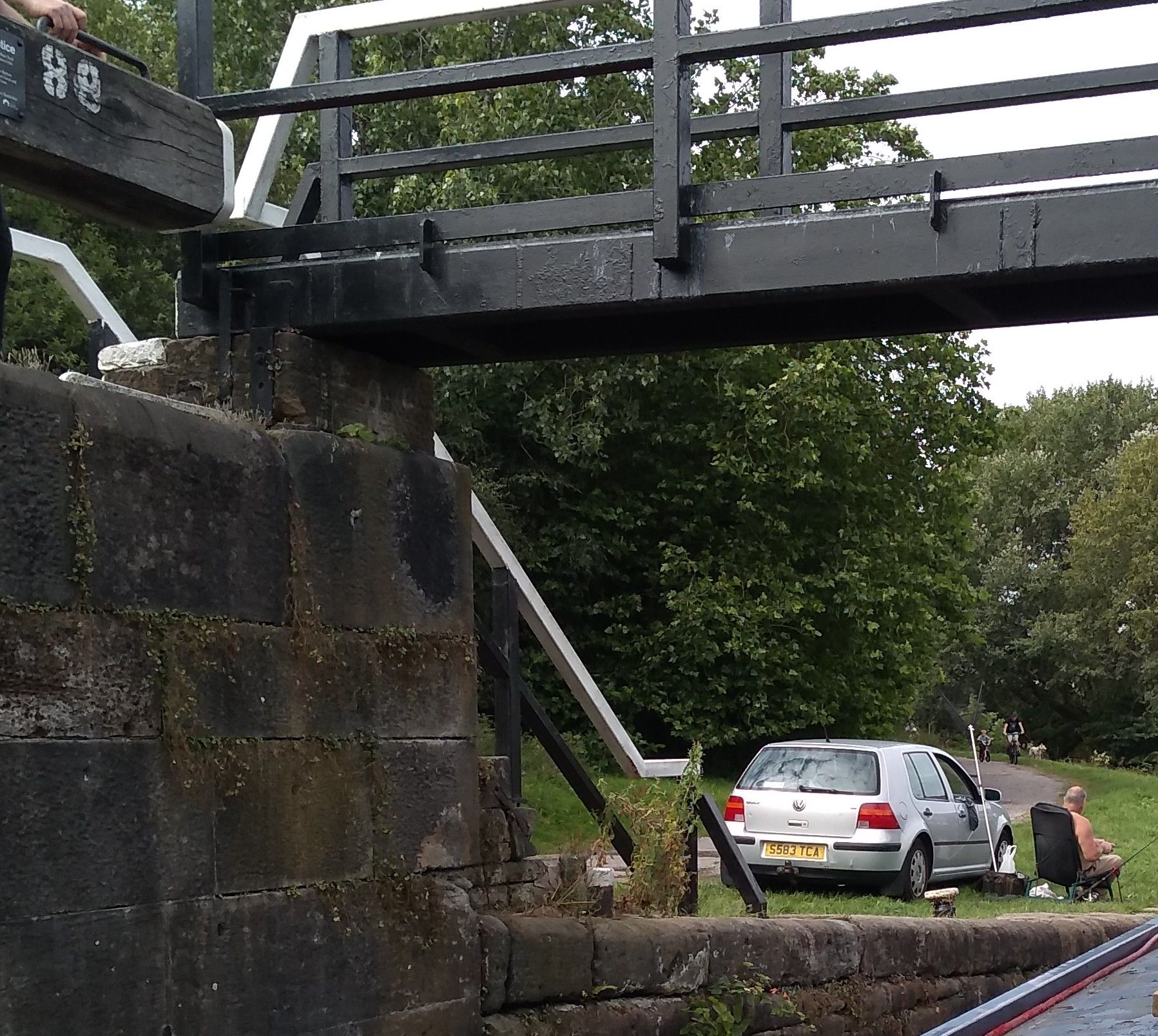

  31. And then there are the less considerate ones ...
