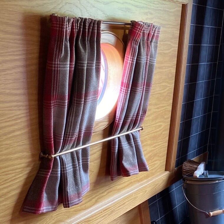

A lot of older boats have brass rods above and below the window, rings on the top rod to accept standard curtain hooks, curtain tucks behind bottom rod to keep it flush to side of boat.
If you're having to start from scratch this soon gets expensive as a quick look at Midland Chandlers website will tell you.
Something from this selection
So thats two rods and four end posts minimum per window, all depending on window size. Plus suitable rings and fittings, plus curtains.
Whichever way you go, they definitely need to stay flush with the side of the boat somehow.
Added pic of one of ours as example from when J made new curtains.

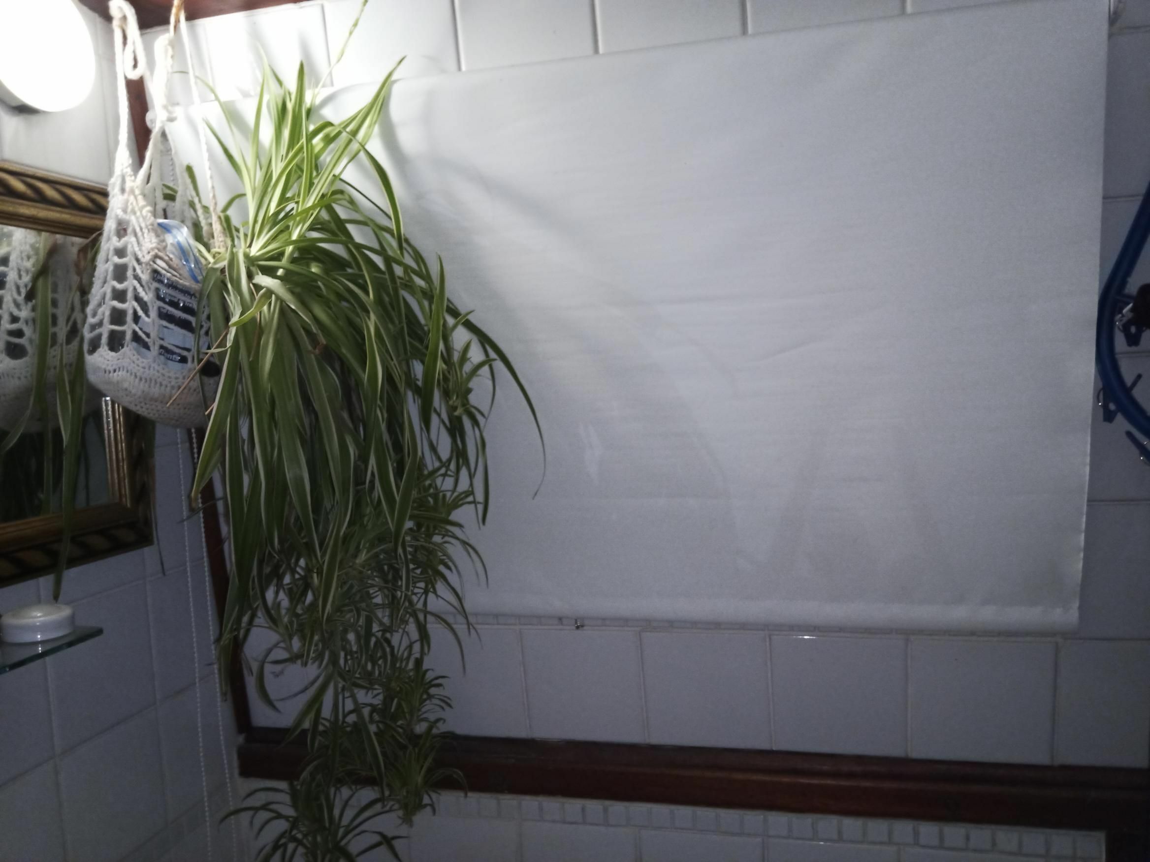

My boat originally came with curtains over the windows. These were tucked behind a horizontal rod across the bottom of the windows. The curtains were very mouldy in the folds of the fabric.
So I decided to go for blinds. I have a roller blind in the bathroom, held flat against the wall by a single tiny screw-in hook and eye, which is quite subtle.
And there are wooden Venetian blinds in all the other cabins. These are held by 2  of the same tiny screw-in hooks on the bottom window frame, lined up with the vertical threads running through each blind. The threads loop over the hooks and these hold the blinds parallel to the wall and are hidden by the lowest wooden slat. The slats still twist open and closed without having to unhook them.
A cheaper version for the rods would be dowels. They could be threaded through round wall hooks (circular closed cup hooks) or hung on cup hooks. As the dowel will bow you will need a centre support which can be quite small. Not as neat as brass rods but very affordable.
An easy solution to hold curtains in at the bottom is dowel for wardrobe rails with the associated fittings. Available in all DIY stores.
5 hours ago, blackrose said:
Nice, but a tad excessive for a window that small. I would have just fitted a porthole bung.
You're assuming i had a say in the matter :D It's also not as tucked back as it can be as pic was to show new curtains to family
We have bungs in the bedroom and bathroom, she's currently working on replacements (we're on the third fabric choice). Foam was bought from a supplier cut to shape, i then had to refine the size and create a jig for the bandsaw to cut it correctly and provide a hardboard template for fabric cutting (glad that bit is over with). I think J finds half the fun of it in the shopping :)
