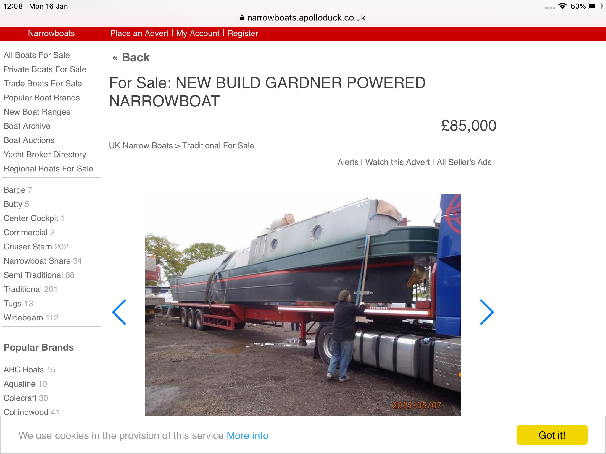

Yes if the original poster isn’t careful could end up with something like this on their hands
To be fair, those wheels could be a bonus come summertime when the next drought hits ;)
That's an interesting boat, I am sure I have passed that moored between between Chester and the Port. Interesting bow
