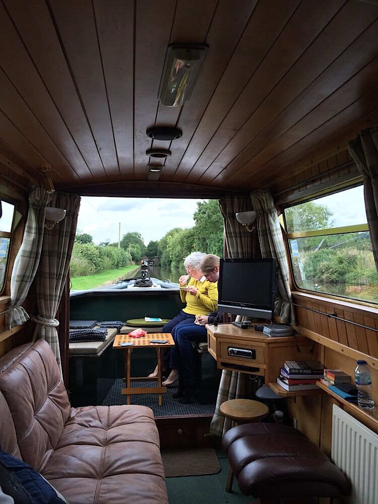

Guest Posted August 22, 2021 Report Posted August 22, 2021 2 hours ago, TomIre said: Thinking of doing away with cratch board and cover. Here's my thinking. I will have a full pram cover on my cruiser stern. So I will have a large sheltered space for muddy boots, wet dogs on bad weather days. Doing away with the cratch and cover means access on and off the bow will be easier. I suspect if I have a cover I'd just end up using it for "junk storage". Am I missing anything? When we had crew on the boat with us they used to love riding in the front well deck, if it was raining they would part open the cover but keep dry sitting on the opposite side. Perhaps a minor consideration though.
Chagall Posted August 22, 2021 Report Posted August 22, 2021 12 minutes ago, The Happy Nomad said: When we had crew on the boat with us they used to love riding in the front well deck, if it was raining they would part open the cover but keep dry sitting on the opposite side. Perhaps a minor consideration though. Not really a minor consideration imho, someone once described it to me as the nearest thing to feeling like you are on a flying carpet....the cover at the side shielded the engine noise as to be almost non existent. Why take it away? you can roll up the sides and fasten if you mostly want to use it as an entrance way. The comfort for your passengers will be appreciated. 1
