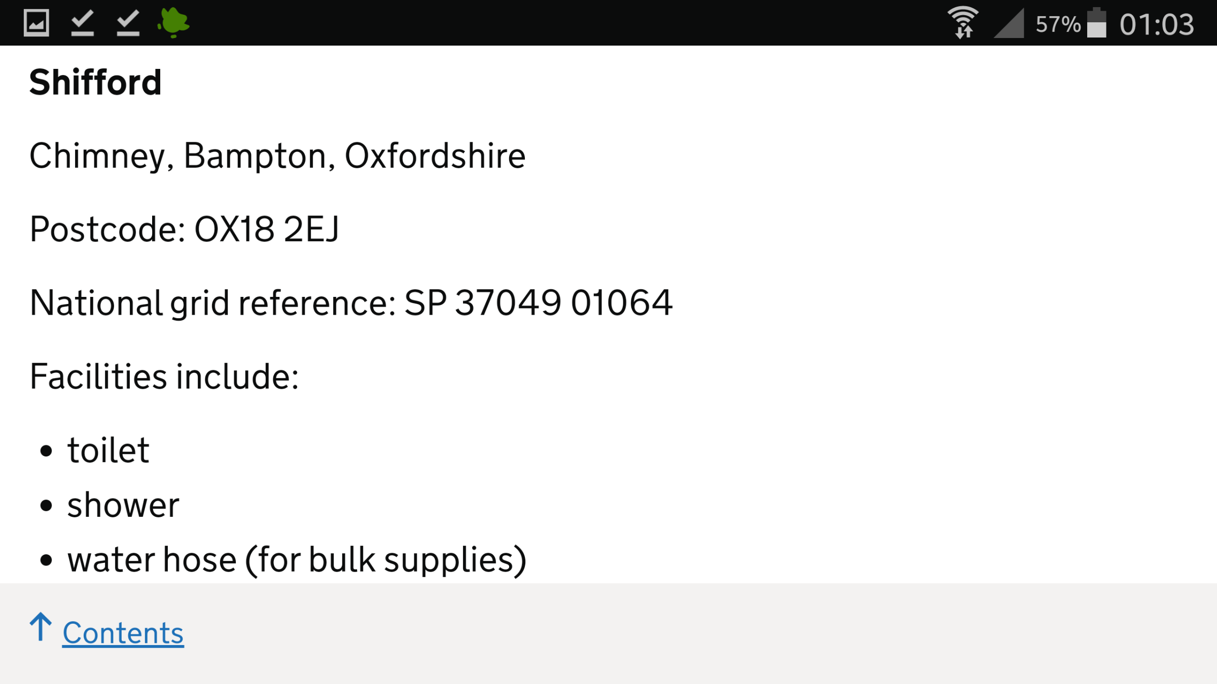

Interesting to note that the later Government leaflet dated April 2021 linked in the earier notice dated March 2021 of the first post, lists a number of locks which have hoses for bulk supply as well as taps. Right hand not knowing what the left hand is doing, or  change of heart?
https://www.gov.uk/guidance/river-thames-locks-and-facilities-for-boaters
for example
Edited by Ronaldo47
link added
for example
Government publications about the Thames are invariably out of date.
As reported (complained about) elsewhere ALL the water points AND the hydrant type facilities have bee replaced by (stupid) garden hose fittings. The hydrant hoses have been removed.
The small water taps fitted on many locks were never intended to be used as bulk water feeds but more for cans / kettles / w.h.y. Methinks the shouldn't have been replaced with hose fittings....
However the cabined based hydrant fitings were always intended as bulk supplies, thus it's a shame that they have been emasculated by fitting garden hose type equipment. But there you are..
EA Thames management have been replaced in recent years by box tickers with no real knowledge of how the River works, those lockies who knew anything are reaching retirement or have already retired - theus a pool of knowledge is drying up.
Boaters from the canal system come on to the River in the depths of winter when lock staff are reduced / on holiday and then whinge about unpleasant it is.
