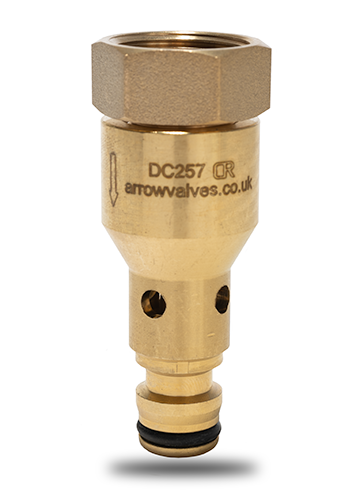

All the above will result in back pressure being created. This will cause water to be vented out of the supply
tap before it enters the hose.
Yes. Sounds like they've fitted a PRV to the tap that will release water if the back pressure in the hose is much above the pressure drop of an ordinary 7m hose.
Looks to me like a recipe for lots of water wastage as people try to get away with longer or expandable hoses.
Big cork anyone to bung up the vent?

21 minutes ago, Paringa said:
Not seen one yet myself to confirm, but this is believed to be the wee beastie...
Pipe Interrupters Type DC257 - Arrow Valves
DN20F. The link above has a couple of installation and use docs if you are interested.
The description attached to that picture states:
Pipe Interrupters are intended for open outlet applications and must not be used for washing machines, upstream of hose union taps or any appliance that has a control valve or restriction
