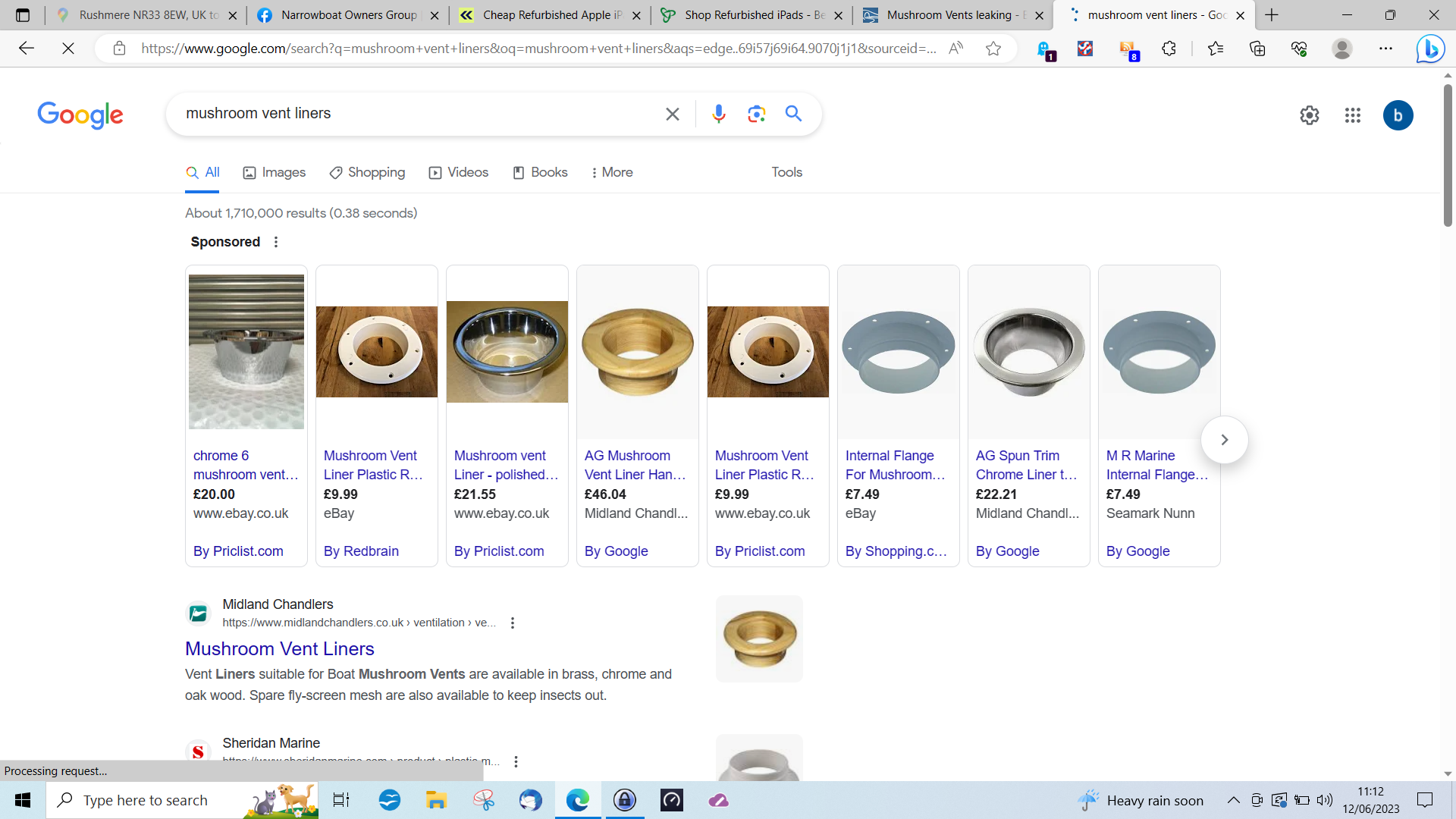

You can buy liners to bridge between the ceiling and the brass mushroom
But those liners just tidy the appearance seen from the inside. They don't seal against the cabin roof plate or mushroom vent tube. The design of some ensures that any water running down the side of the mushroom vent tube enters the roof void rather than falling into the main cabin space.

They do if you put sealant round them
The brass spun liners I removed from Belfast were tapered down to about 3" diameter at the top which sat inside the 4" diameter shaft of the mushroom vent. The 1/2" gap all round would have been hard to seal, and would really need the mushroom top to be removed so you could see what you were doing when placing the sealant. As it was any water coming down the gap would end up in the roof void.

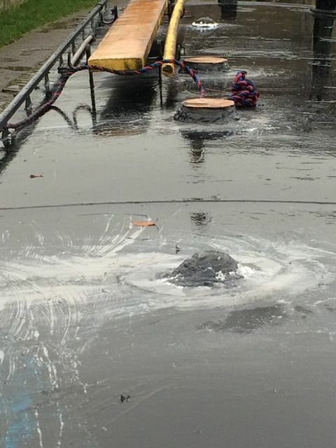

Yep! Hail stones :
You could use those square sponge washing up cloths. Cut a hole in each cloth approx the size of the mushroom upstand and stretch it over the dome onto the roof (or take the dome off and put the hole in the cloth over the upstand). When it rains heavily the energy of the water droplets around the vent will be absorbed and they won't bounce. You wouldn't want to leave the cloths there all the time as eventually they'll lift the paint underneath (and they look a bit naff too!)
