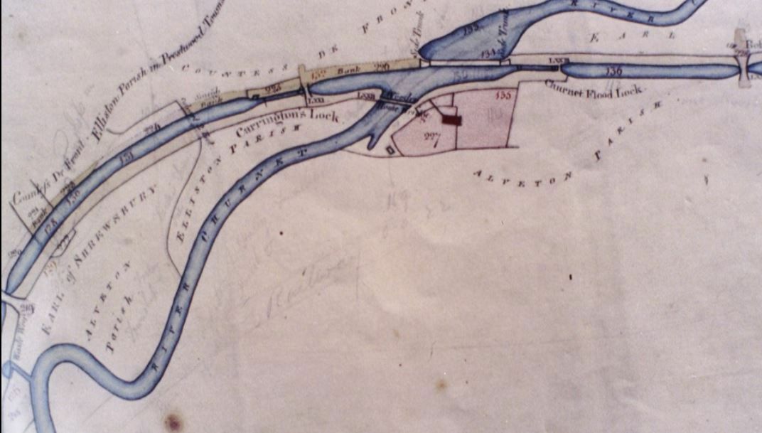

Yes the Derby Canal did cross the Derwent, at Derby, and this link had locks on both side of the river and what is credited with being the first iron aqueduct over the mill stream south of the Derwent.
The Churnet was also crossed by the Caldon Canal in a similar fashion to the Uttoxeter although the engineer was different. With the Uttoxeter the engineer was John Rennie, senior and with the Caldon the final credit is best placed with Hugh Henshall and his staff.

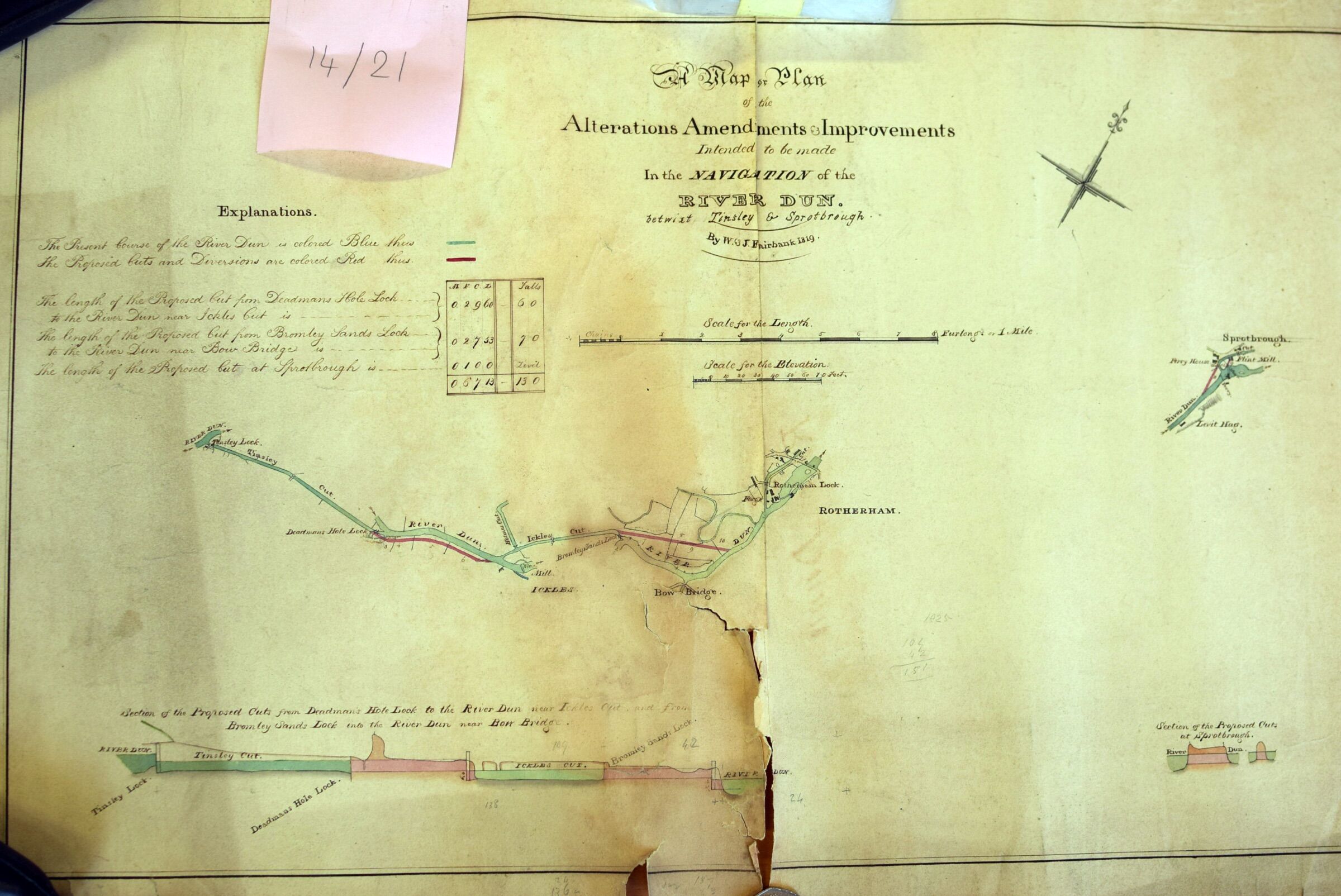

Between River lock and Jordan lock on the Sheffield and South Yorkshire. Again, a longer stretch of river between the locks, but functionally identical.
https://canalplan.org.uk/place/q2ob
Historically that was more or less a crossing, the canal downstream of Tinsley was on the other side of the valley.
Do you have a map of that arrangement? Would be interested in seeing it. The area changed a lot, as more canals were cut to make the river easier to navigate, then railway construction shifted the route. I know about the area further east, Iccles to Rotherham town and how the railway altered that, but not what is now the most upstream navigable bit of the Don, River Lock to Jordan. There would have been a wharf around there, before the Sheffield and Tinsley was built, but where, I don't know.
Edited by Jen-in-Wellies
36 minutes ago, Pluto said:
The section below Tinsley in 1819.
1819 BW14:21 Tinsley-Rotherham, Sprotbrough.jpg
Many thanks. I'd no idea it was like that back then. Hugely different from the current alignment.
