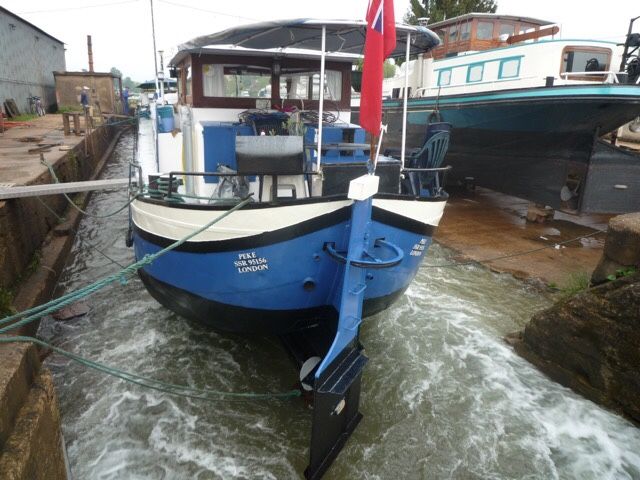

Dav and Pen Posted January 4, 2021 Report Posted January 4, 2021 I have only fallen in once and that was on New Year’s Day many years ago when I was breaking ice with a shaft around the cabin when I slipped off the gunwhale. I broke the ice and touched the bottom but rebounded straight back and up into the hold landing on the coal. I was now both wet, cold and black. Good job the bottom of Watford is shallow. On our barge in France to comply with the regulations there had to be a notice near the wheel with instructions specifying what to do if man overboard. First thing engine in neutral. I never fell off the barge but the dog did in the middle of a wide river and he swam back to the boat. I had to climb down the rudder and grab him but he was to heavy 25 kgs for me to lift him back whilst clinging on myself. We fashioned a rope sling and but it round him and with herself pulling and me pushing got him on board. I then heard clapping and looked round to see we had drifted back under a footbridge and had attracted quite an audience. Luckily the previous owner had had some rungs welded on the rudder. 1
Alan de Enfield Posted January 4, 2021 Report Posted January 4, 2021 7 minutes ago, Dav and Pen said: I had to climb down the rudder and grab him but he was to heavy 25 kgs for me to lift him back whilst clinging on myself. That just goes to show how difficult it is - multiply that weight by 3x or 4x and you have a serious problem in trying to lift someone back on board.
