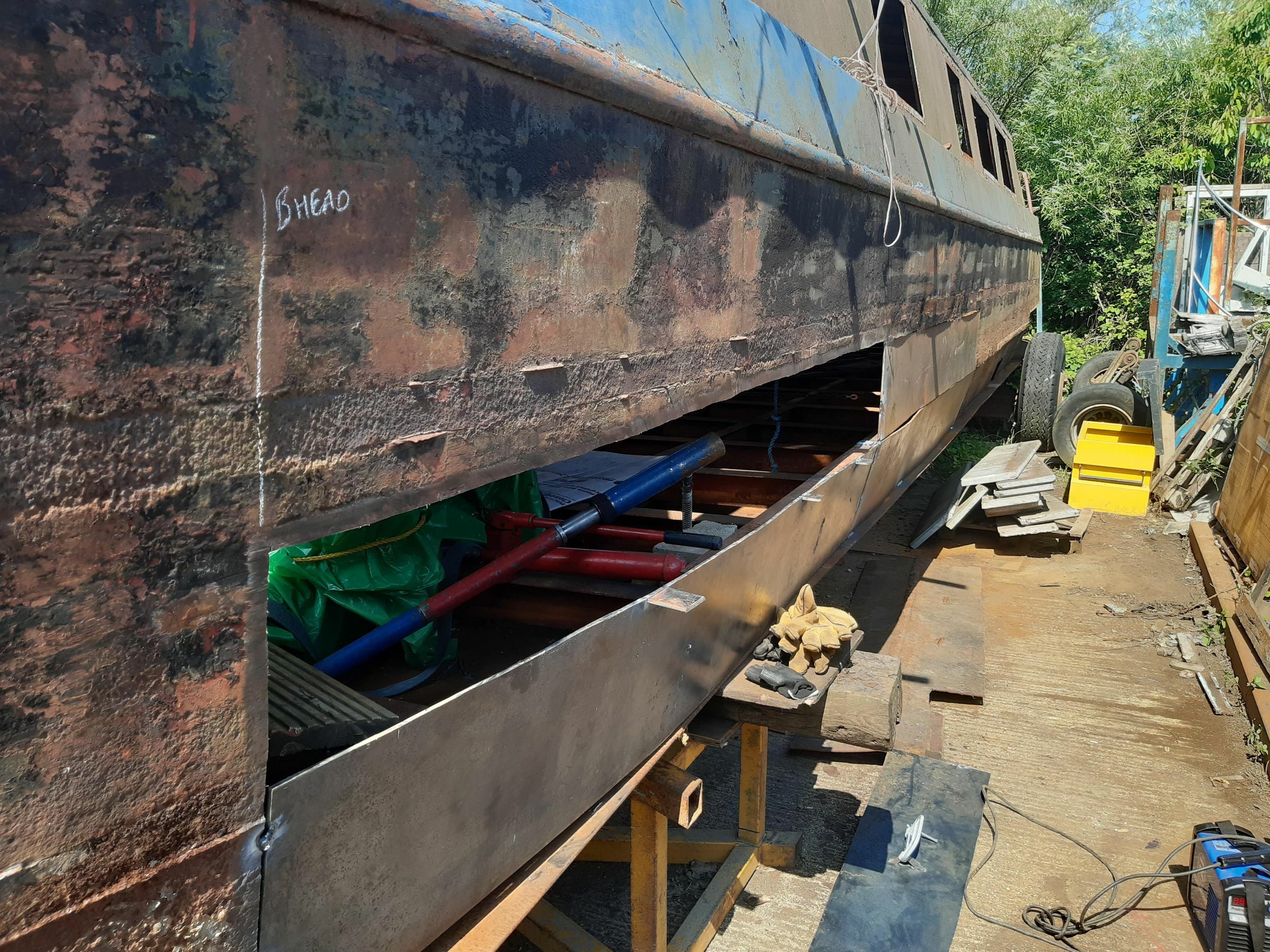

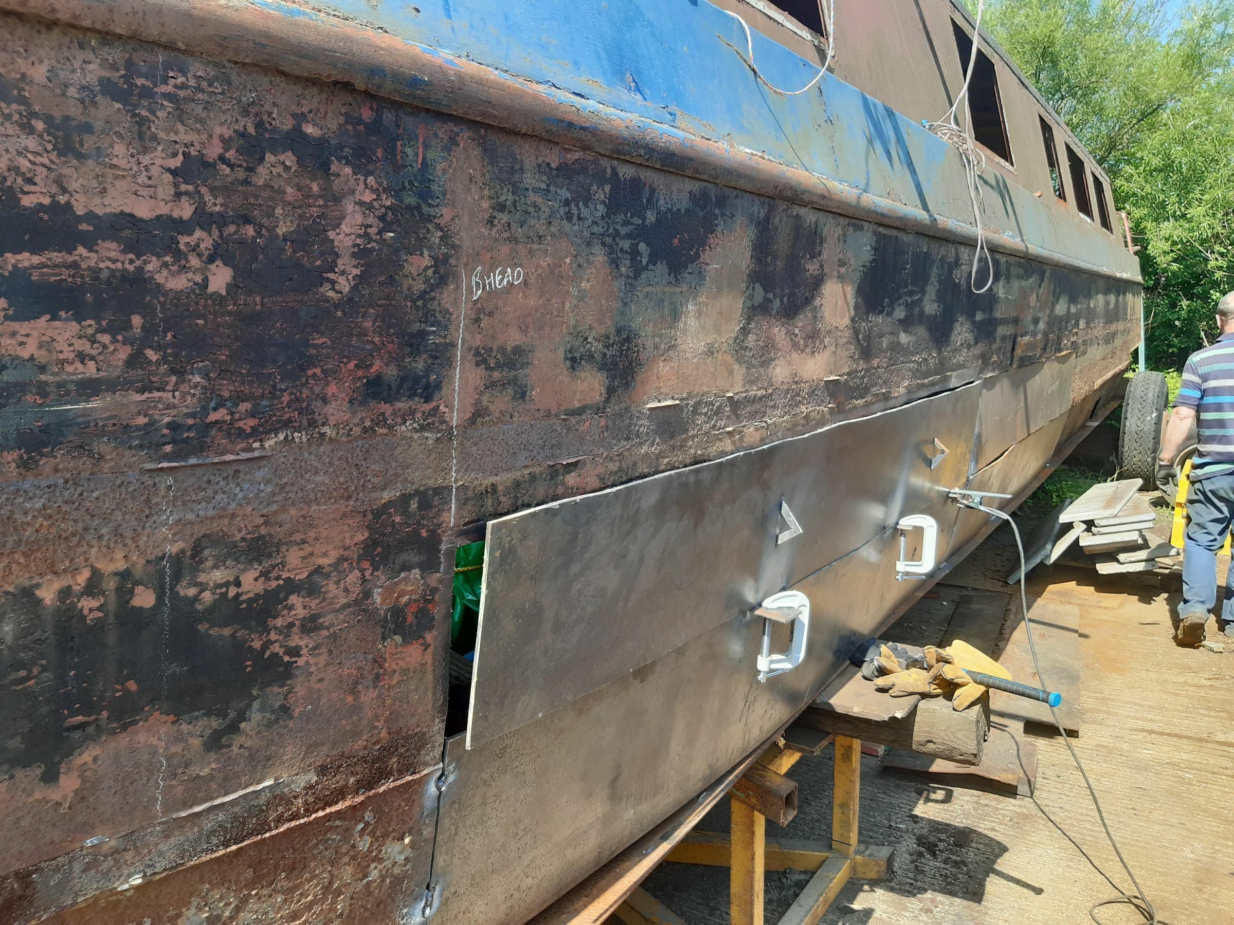

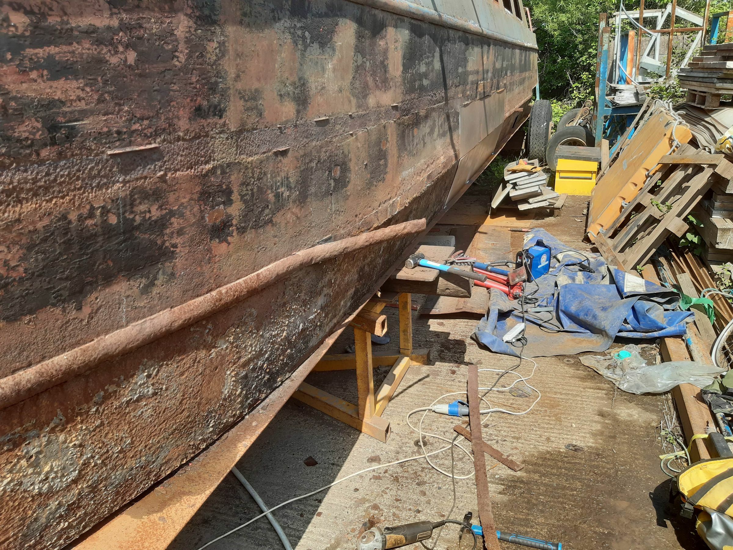

  8. Next was to move to the panel in front- it curves up slightly along the chine, so I took measurements from the baseplate every 30cm and plotted them onto the replacement steel, then joined them up by bending a waggly ruler between them. Quick zip along the line with a grinder and I had a bendy sheet. Tacked it in to the sheet that had been fitted behind, and gently bent it into shape by pulling it into shape from within the boat with a ratchet strap. Next was the piece above- I'd deliberately cut the "hole" in the boat not tall enough for the replacement panel, so that I could draw around it. This was a good idea in theory, so my Dad and I picked up the piece, attempted to hold it in place and draw around it. This proved to be an utter impossibility trying to balance it on edge and not drop it through the hole. Tea was consumed, heads were scratched and the idea of fitting tabs to the panel below was generated. Tried it, and it worked really well. The panel could be held in place with G clamps firmly enough to se the edge of the new sheet as a "fence" for the grinder Hole enlarged, tacked the panel in to the rear and pulled it in at the front as before. The boat has led such a hard life the side was badly dinged in places, so it didn't meet very well in the "inny outy" axis, so the existing hull had to be pulled out to meet the nice flat new sheet

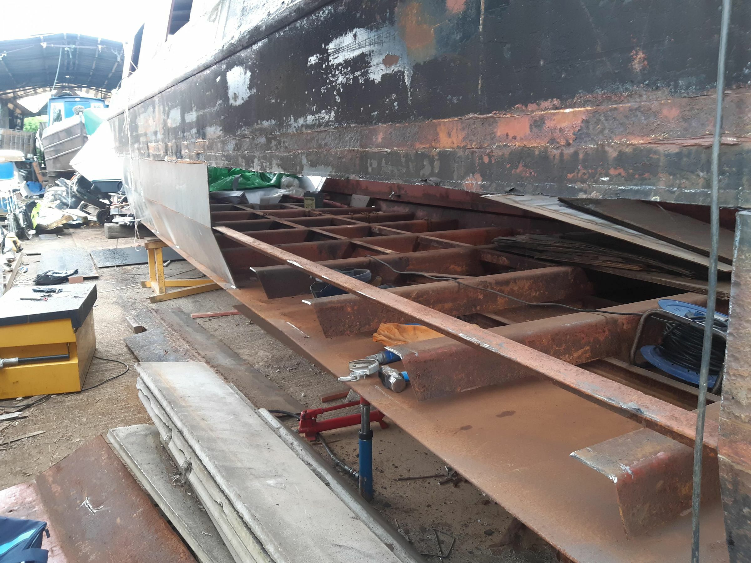

  25. The third chapter of the Bank Holiday- We'd really saved the easiest bit until last- the panels to the rear of the panel put in originally. Nice and easy, nice and flat, plenty of things to line them up off. Chop chop... (Because this panel was as far from the stands holding the hull up as possible, not the portapower ram underneath the baseplate to stop it going all floppy) And steel tacked in. Much much faffing around then occurred as I pulled and pushed and levered the fresh steel into place. This involved a lot of nipping in and out the boat to put a tack here and weld an eyelet on there, which the little RTech was mega useful for. While I did that "the apprentice" was given an angle grinder and set to cleaning off areas of the swim so that they could be ultrasonically measured. There's about 4 garden pea sized pits on either side, but the rest measures 5.6mm and above, consequently i'm not going to replace the steel there, just weld up the pits. Result! Which hopefully fills in the blanks leading up to the image posted originally

  49. Bank Holiday weekend seems like a lifetime ago now, but here's the first of the updates on what happened To fast forward to the end result (Like you did when asked to read a book in school but couldn't be bothered), here's what we ended the weekend with; I say "we", as I had my dad on the job, which was enormously helpful to have a 2nd pair of hands, even if neither of us had any experience of replating a narrowboat! This was achieved in sections, as described previously. I was very conscious of learning from the mistakes of the previous owner, and not cutting out more than the new sheets would replace. Consequently the new sheets were rested up against the side of the hull and drawn around, to ensure good fit up. In order to do this the D iron needed to be removed. As it wasn't fully welded, this was relatively straightforward- just zip through the tacks with a 1mm disc in a grinder and get the bolster chisel behind it When replacing it i'll definitely be fully welding it on- water has become trapped behind it and caused some spectacular corrosion in points. Another point to note for prospective boat builders More soon, but i've reached the post image size limit
