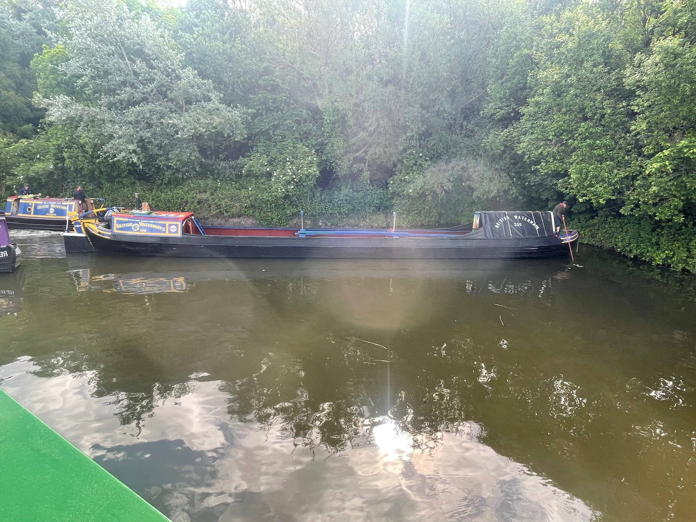

David Mack Posted March 13, 2025 Report Posted March 13, 2025 9 minutes ago, Wafi said: I'm still trying to figure out whether the rudder on my narrowboat has any effect at all when the engine is in reverse. Definitely! I can steer both Fulbourne and Belfast backwards when the conditions are right, and the boats do steer in reverse, albeit not as well as when going forwards. Once the boat is moving backwards there is a flow of water over the rudder which is all that is needed for some steering effect. Having quite a large rudder is probably beneficial.
