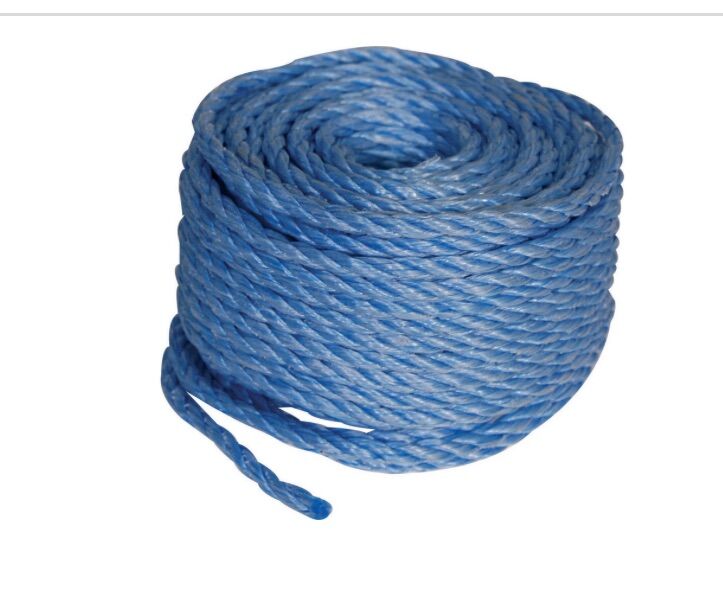

50 minutes ago, Goliath said:
30m x 6mm for £5.18
toolstation
Polypropylene? No thanks.
I'd go for polyester every time. It won't go stiff with exposure to UV like nylon and won't go nasty and brittle like polyprop.

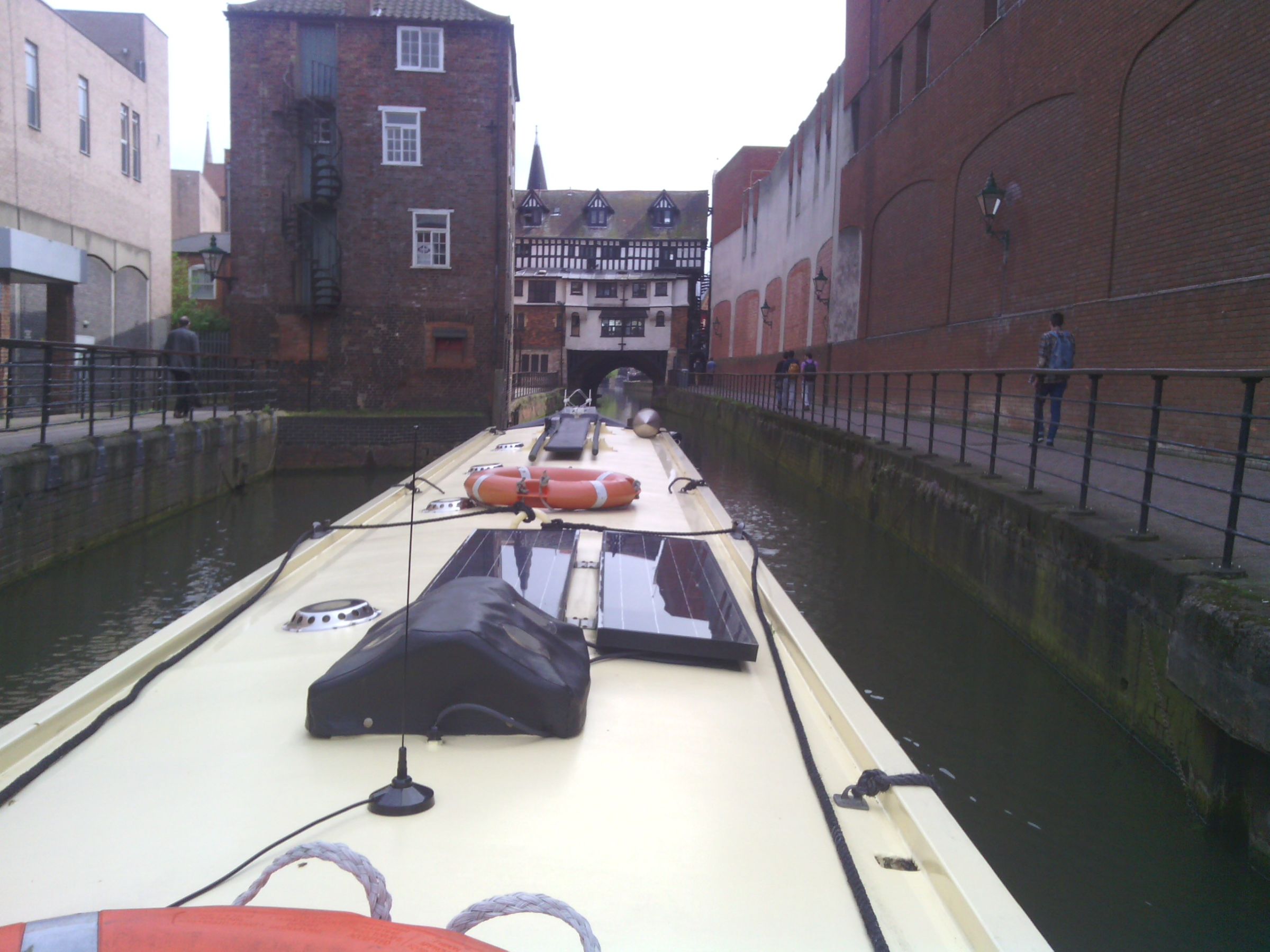

I have two centre lines, much easier but I also keep a fairly clear roof.  These are 12mm but I would go 14mm when I replace them.IMG_20220420_133147987_HDR.jpg.0b182894d4d50d6ba27bb15c073706e1.jpg
I have the same/similar set up.
Not a neat roof like yours mind.

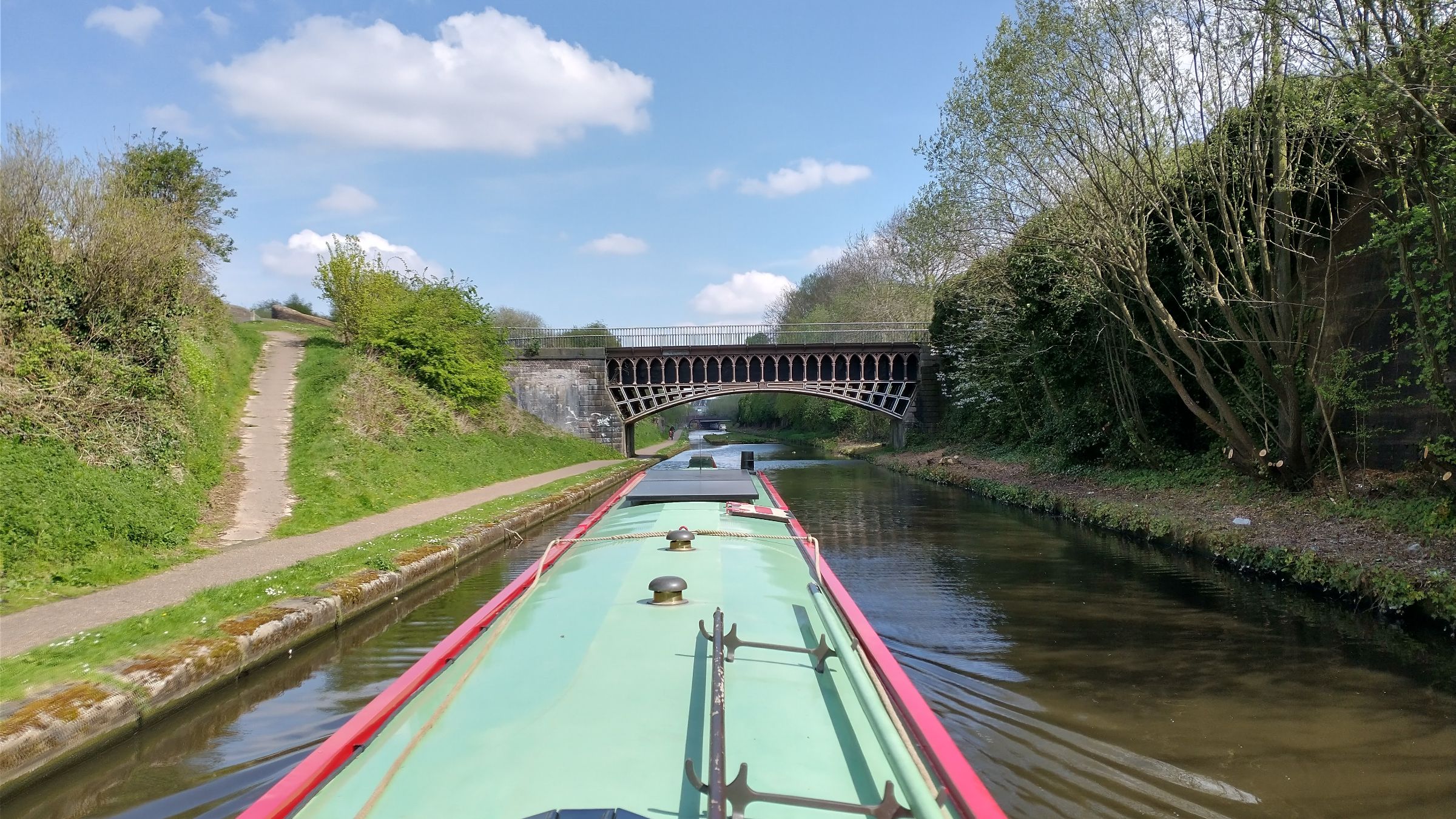

Just measured my rope and it’s 12mm
The mooring ropes are 10mm.
(main line going under Engine Arm by the way)
