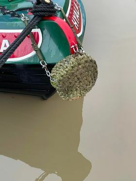

Is there a traditional method, rope material and/or knot for securing fenders to the boat? I am thinking particularly how the fender chains are extended to the fixing points in the photo.

Both my bow and stern fenders are attached by cords, only one link of chain outside the fender and non on the boat
#3
Rope shackles is what I use to secure all the bow and stern fenders

Using metal links like that at the boat end is likely to lead to damage to the paint underneath and eventually rust.

I believe that there is a case for a weak link, just in case the bow fender gets trapped. Just how one determines how or if this will work has so far defeated me, I only use two of the three embedded chains, but then get people telling me my fender is insecure.

I have seen turnbuckles/bottle screws and cable ties used. I'm not sure that counts as traditional though.

It is generally accepted that fenders should not be fixed in such a way that if they get caught or hung up in any way, they could affect the stability of the boat - they need to be 'breakable'. Hence the open hook in a chain, and the string on the outermost fender, the one that is most likely to get caught in a closing gate or under a gate cross beam, fore end or aft.
The 'traditional' description, should really relate to the best and safest practice.

The hooks are designed to 'open out' under extreme tension. The strings to break. Most are no longer available (such types of hooks that is) so chain is used, but the outermost should always be string.
