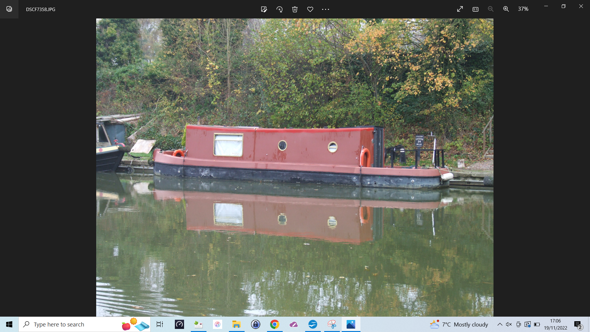

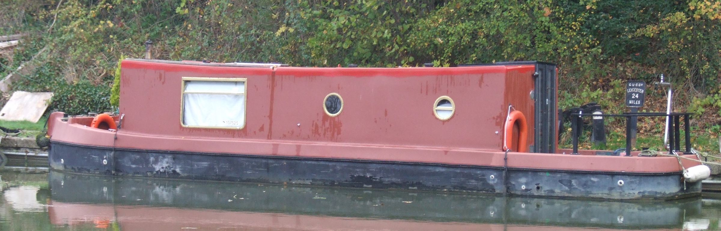

ditchcrawler Posted November 19, 2022 Report Posted November 19, 2022 10 hours ago, Tracy D'arth said: What happened to the GRP ones that were built?
