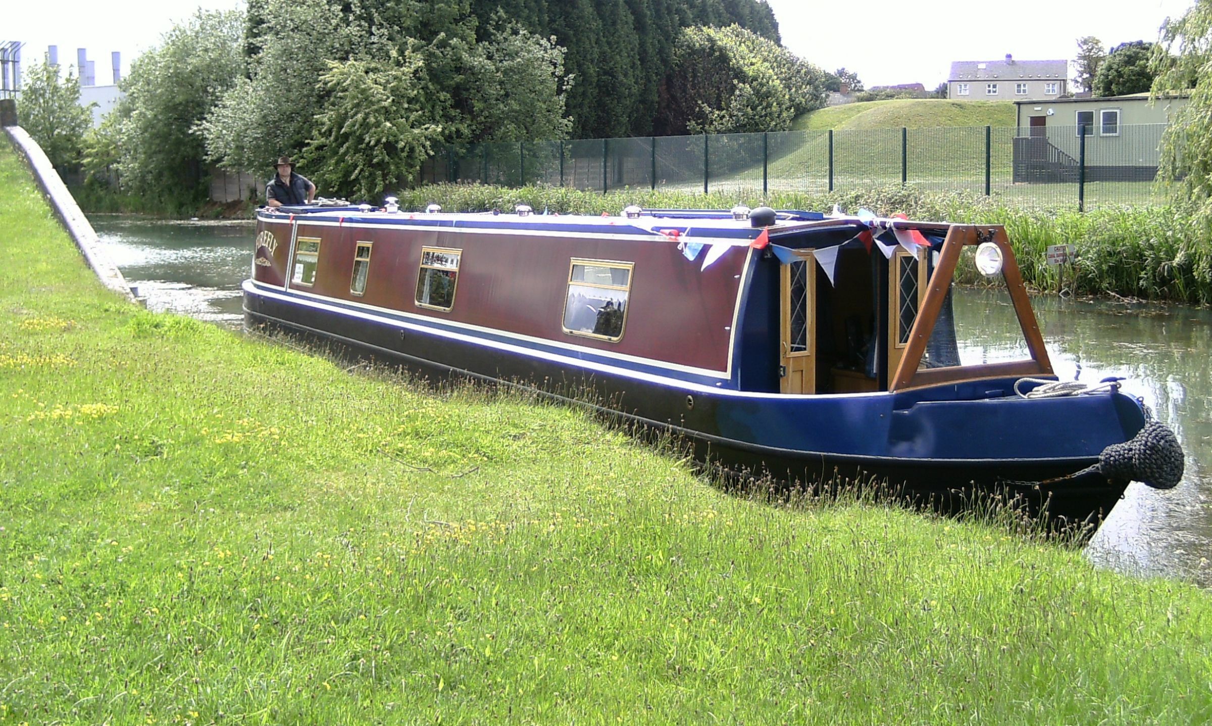

john6767 Posted April 26, 2022 Report Posted April 26, 2022 our boat had a dent is a similar location when we bought it When it was repainted, Rose Narrowboats cut the area out, bashed the dent out and then welded it back in. I was not possible to just bash it out in place. Post repaint. 2

tove Posted April 27, 2022 Author Report Posted April 27, 2022 23 hours ago, john6767 said: our boat had a dent is a similar location when we bought it When it was repainted, Rose Narrowboats cut the area out, bashed the dent out and then welded it back in. I was not possible to just bash it out in place. Post repaint. Thanks for this. I've sent you a message about it. Hope you don't mind.
David Mack Posted April 27, 2022 Report Posted April 27, 2022 23 hours ago, john6767 said: When it was repainted, Rose Narrowboats cut the area out, bashed the dent out and then welded it back in. I was not possible to just bash it out in place. Why not just weld a new flat piece in? Less work than bashing out the dent.
john6767 Posted April 27, 2022 Report Posted April 27, 2022 59 minutes ago, David Mack said: Why not just weld a new flat piece in? Less work than bashing out the dent. It might actually have been a new piece when it came to it. The main point was it was not possible to knock the dent out in place.
