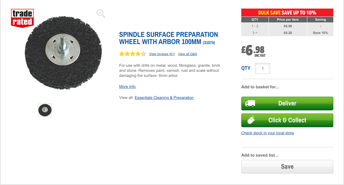

Slow and Steady Posted April 21, 2022 Report Posted April 21, 2022 (edited) These are good for paint removal - poly abrasive disc. 1/2 a day: IMO it's faster in the long run to take the lot off and get a level surface to paint on... unless it's just a few rusty area. I found once I started looking more closely there would have been more removed than left so I went for it. Edited April 21, 2022 by Slow and Steady 2

Floaty Me Boaty Posted April 22, 2022 Report Posted April 22, 2022 (edited) 17 hours ago, Biggles said: Hello All So its been 10 years since the roof was painted and now it needs a strip off completely. This is not optional! Really it's not! I can get a lot of it off by just scraping and the rest I can get with angle grinder. I'm not going to get it back to bright shiny blasted metal I know so I am looking for advice on treatments ready for the top coat. The surface will be lightly pitted. Suggestions please. This is cheap and cheerful, Edited April 22, 2022 by NobbyHall

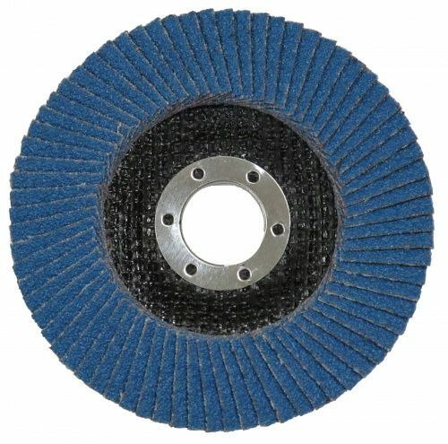

bizzard Posted April 22, 2022 Report Posted April 22, 2022 (edited) Flap discs on an angle grinder will also make short work of it. Aldi do good ones Edited April 22, 2022 by bizzard
