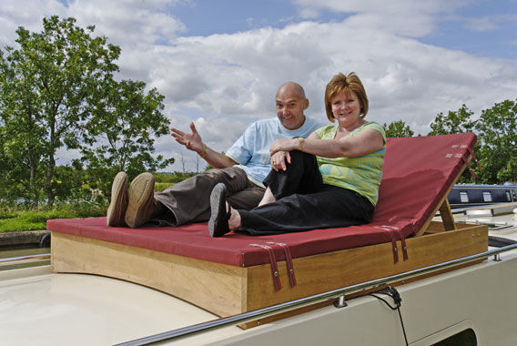

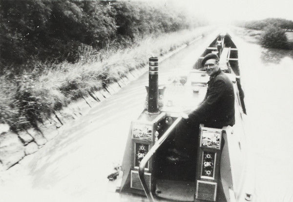

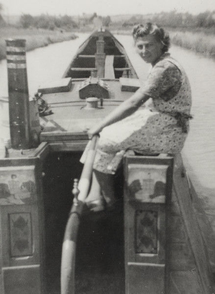

Alice Collins and Bob Grantham.
Pictures from CRT Archive.
Edited by Ray T
I suggest the OP looks at this idea and ignores the "roof bed" concept that you have also posted ?
................Dave
Matty’s idea to put a seat on the roof. I just provided an example. Not my concept at all.
