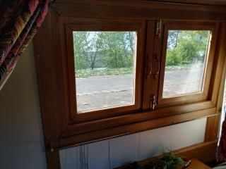

Sorry, I must have missed at least one email alerting me to new comments.
The whole job was done by Martin - measuring up, manufacture of hatches, fitting which I'm sure included adding some insulation, wood lining. The steel was supplied with a coat of gloss and professionally painted within a few months when the rest of the boat was painted; the woodwork had three coats of exterior varnish added by ourselves very shortly after fitting.
I might take some more pics tomorrow if people would find that useful. Someone (MtB?) made mention of the strange size and shape of the hatches; that's because they're designed to fit an existing window opening (they replaced two normal windows).

Hmmm thanks for the photos, they give a much clearer idea of what's going on.
I have to say it all looks very nicely done and nicely painted and looked after, and had it been me that made and fitted them I'd be all over this wanting to work out how came to leak. Not just because you are a dissatisfied customer but so I could avoid it happening to other customers in future.
I'd say this can only be a design flaw (can we see some pics from the outside, of the frame, with the hatches OPEN please?) or an installation flaw, or a combination of the two. Its disappointing that Martin is not interested, never mind whether you are 'out of warranty' or not.

I'd want to work out exactly where the water is coming in. So I would remove the horizontal wooden trim above the stained white panel - it only seems to be screwed on. That should help identify whether the rain is coming in between the doors and frame, in which case weatherstripping the joint is probably needed, or if the leak is between the frame and the cabin side, in which case Captain Tolley might be a quick solution.
I was thinking that too. I'd be dismantling the interior so I could get a really good look inside with a torch and a mirror. Especially given current circumstances where we are all stuck inside with not much to do. If the interior panelling will come off, it will probably become fairly clear where those black runs originate.
Fair comment. and including those by MtB removal and investigation is the answer, having found this, perhaps include Mr K and ask his opinion...........tracking leaks on my boats and houses over the years have taken up lots of time over the years. The worst was Cockroaches and water from a Chinese restaurant above our office in Oxford.

Removing a few bits of the panelling ought to reveal more about where the leak is coming from.... hopefully it's within reasonable DIY capabilities.
