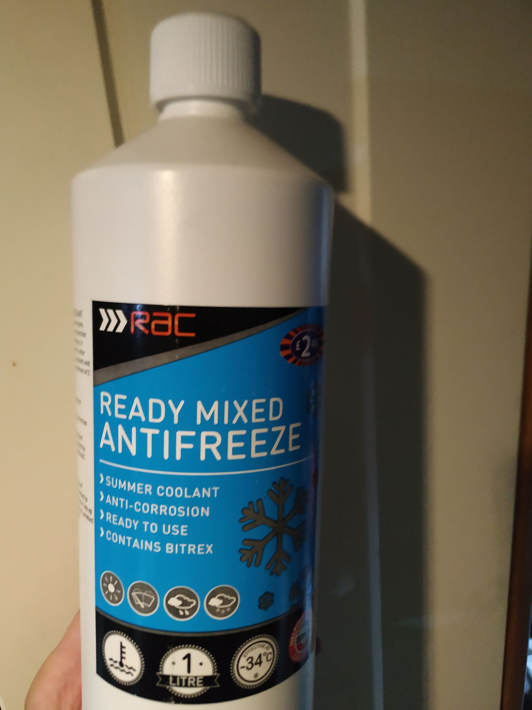

Thanks, I'm glad I asked! It contains mono ethylene glycol, and that's all I know. A quick Google doesn't provide much in the way of a definitive answer - I think it's the type called 'universal' but still not sure about mixing?
Hopefully this is a simple enough question... I normally buy pink OAT ready-mixed antifreeze from Halfords, but today I'm stuck with this from B&M. No mention of formulation but it claims to be 'suitable for all engine types' so I guess it's intended to be a 'universal' style. Is it going to be okay to mix with the OAT already in my central heating header tank?
