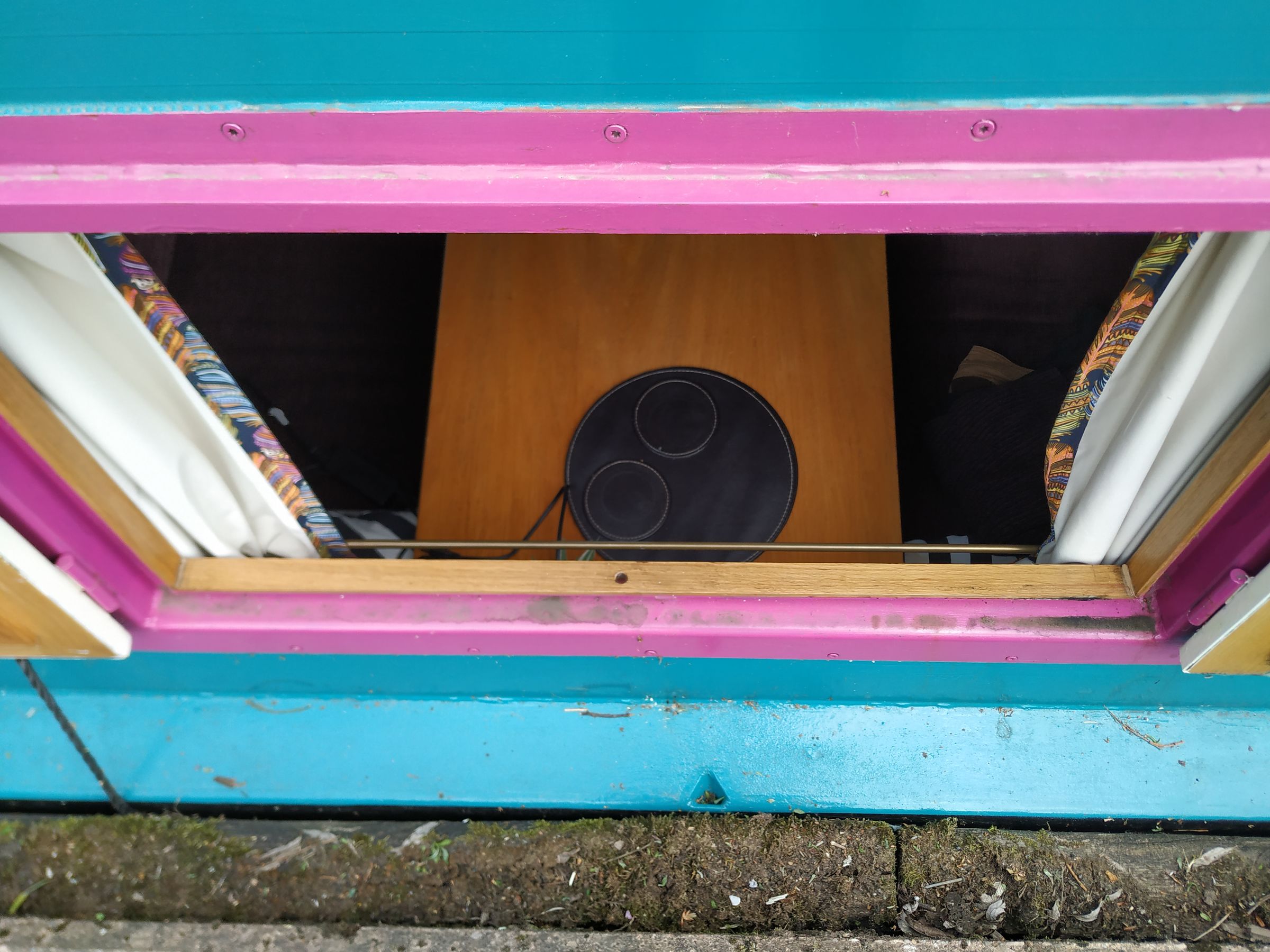

Kedian side hatches/doors 1 yr on (not impressed)
magictime replied to magictime's topic in General Boating

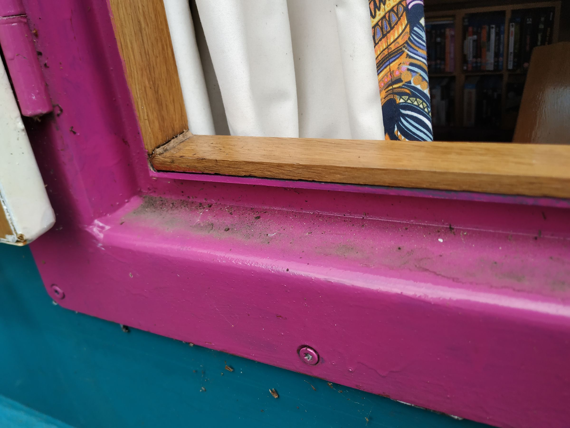

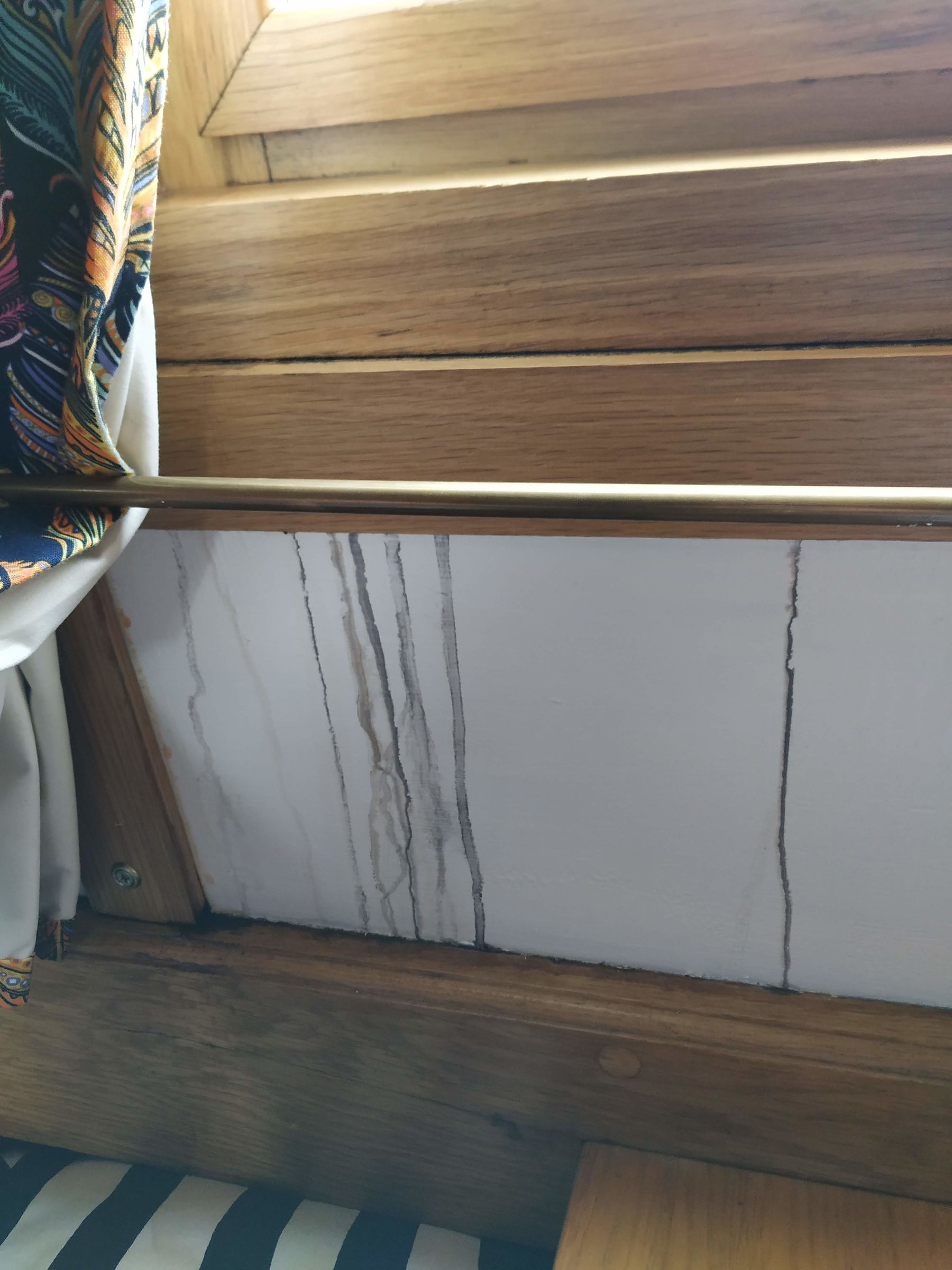

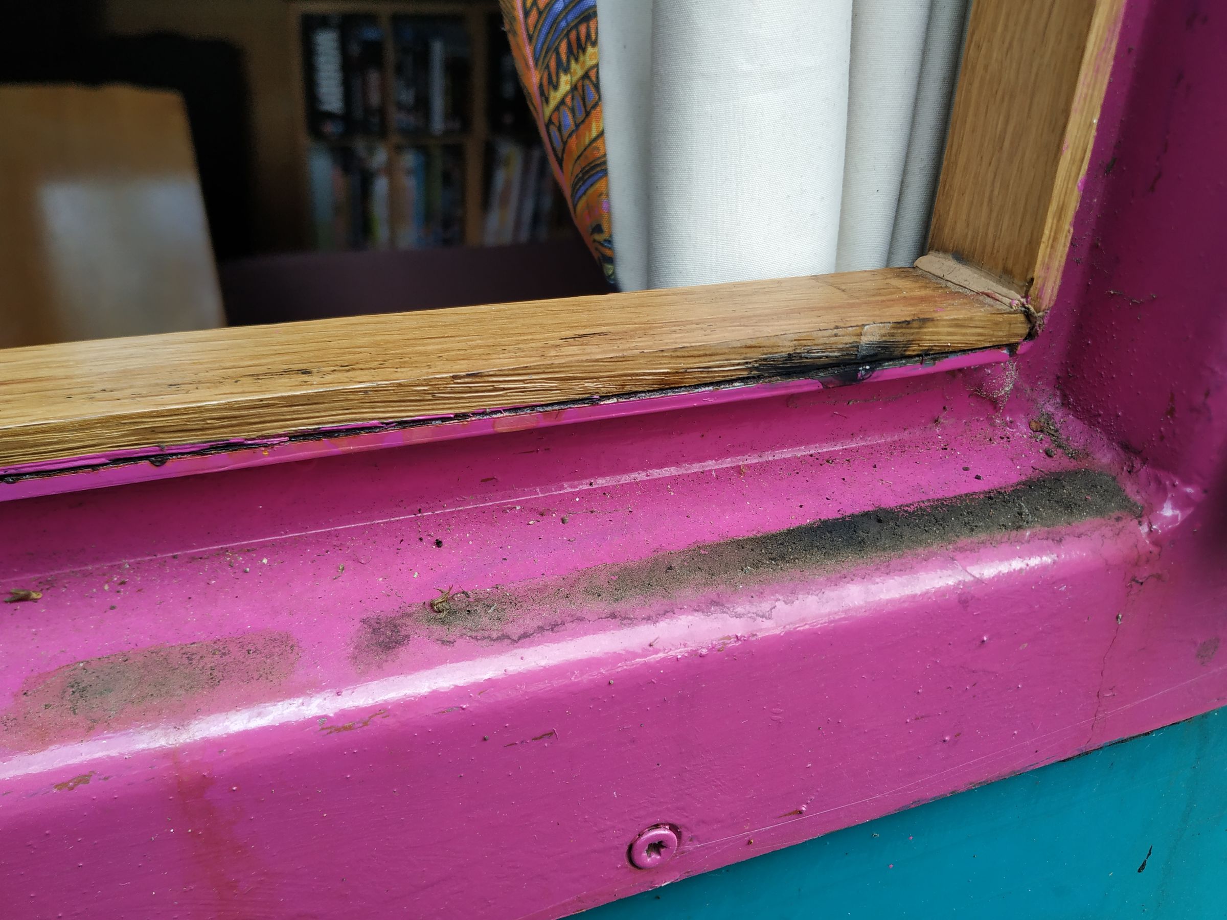

Interesting, thank you. It might (might!) be that the staining there is a separate matter from the leakage, then. However, that staining is cosmetic and not my main concern. My main concern (to reiterate) is that water drips out below gunwale level on to the dinette cushions after heavy rain (mostly below the opposite corner of the window, the bottom right), which suggests to me that quite a bit of water is finding its way in from outside and staying mostly out of sight between the steel cabin and wood lining. How very dare you! -

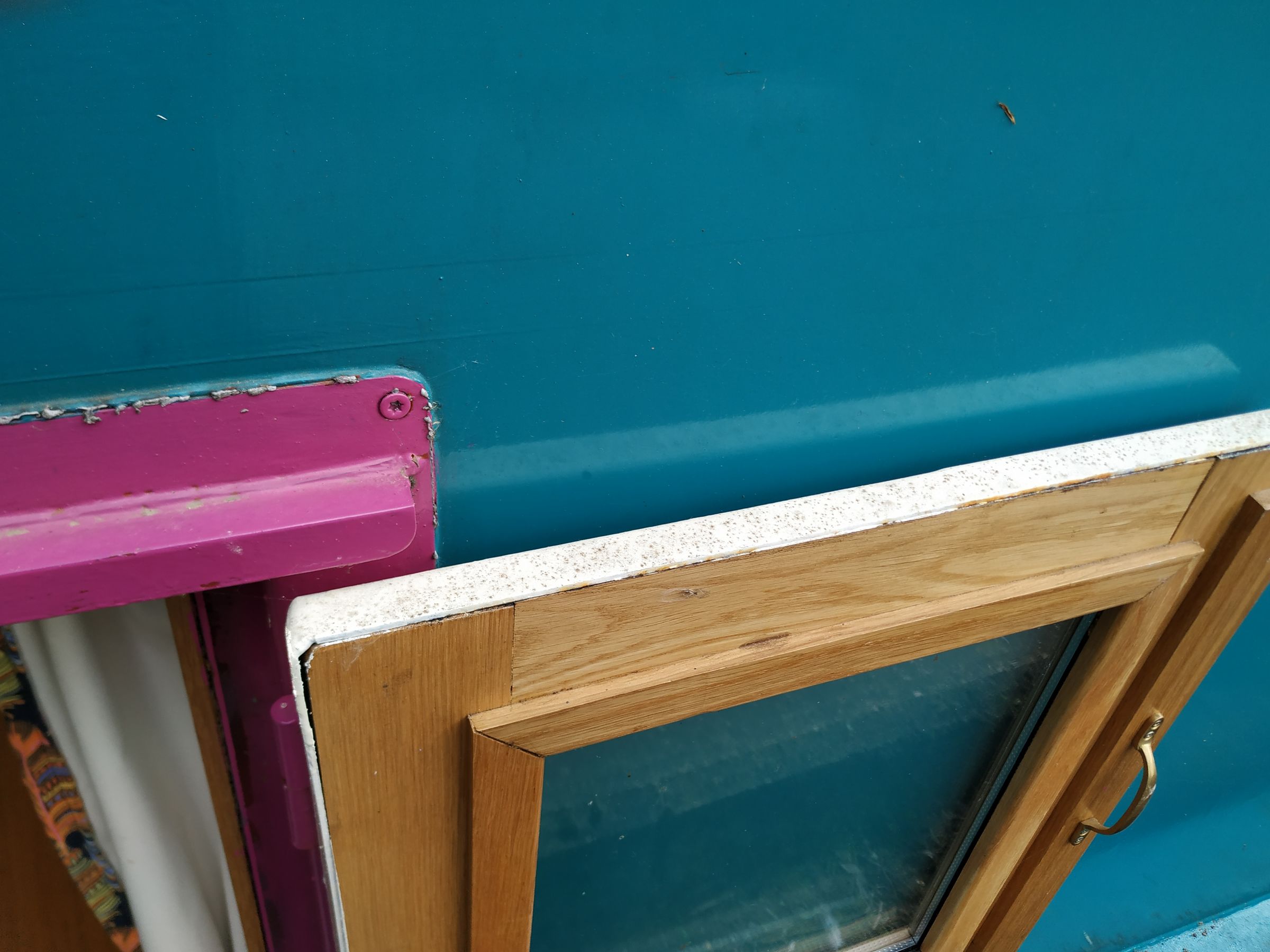

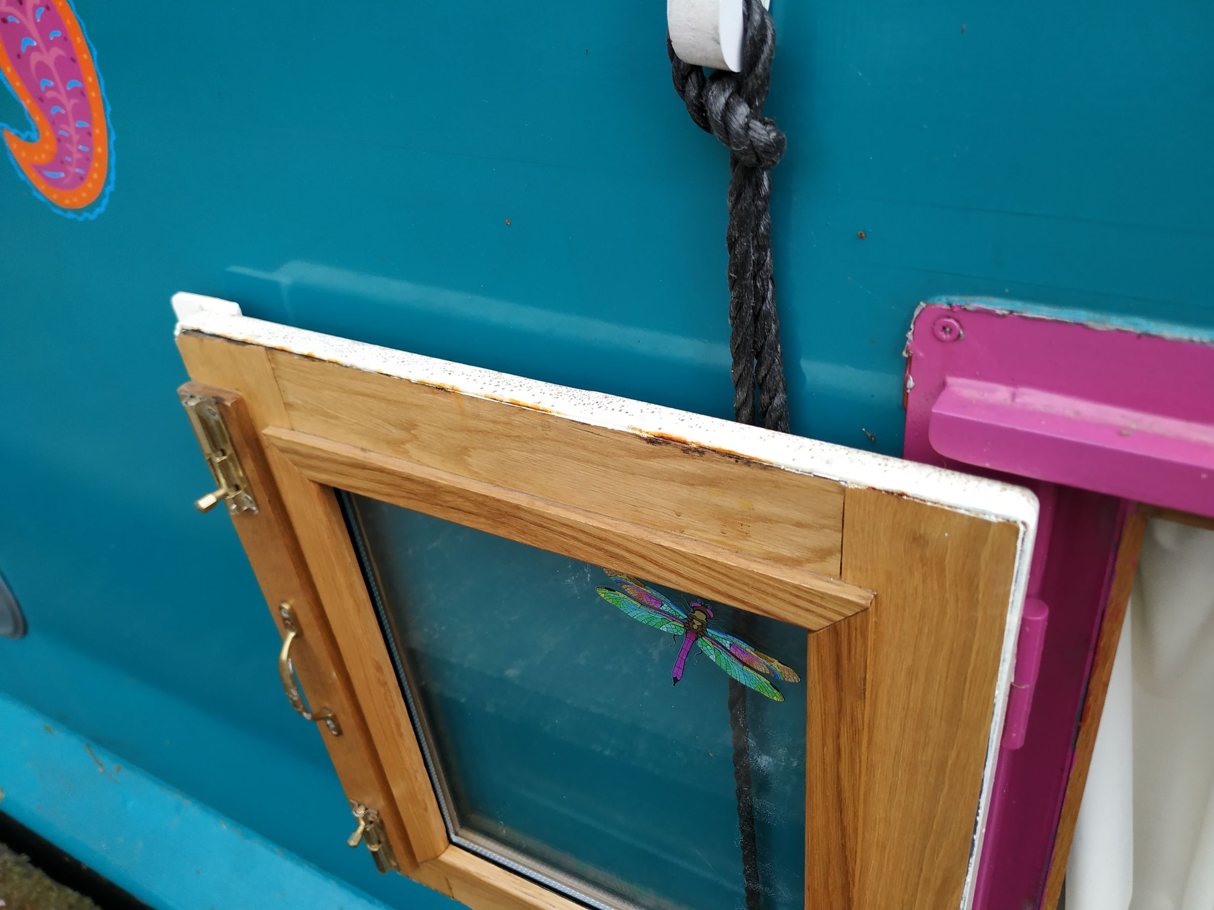

I understand the concern and I hope I've been quite careful not to go beyond the facts of the matter, and to be quite clear that this is only one person's experience. But at the end of the day, it's just a review, of the sort that any small business must surely nowadays expect to be out there on the internet somewhere (if not on their own Facebook page!) There's a consumer perspective here as well as a business perspective, and I've essentially posted the comment I wish I'd seen before spending £2000+ on these things, under a title that would have drawn my attention to it. -

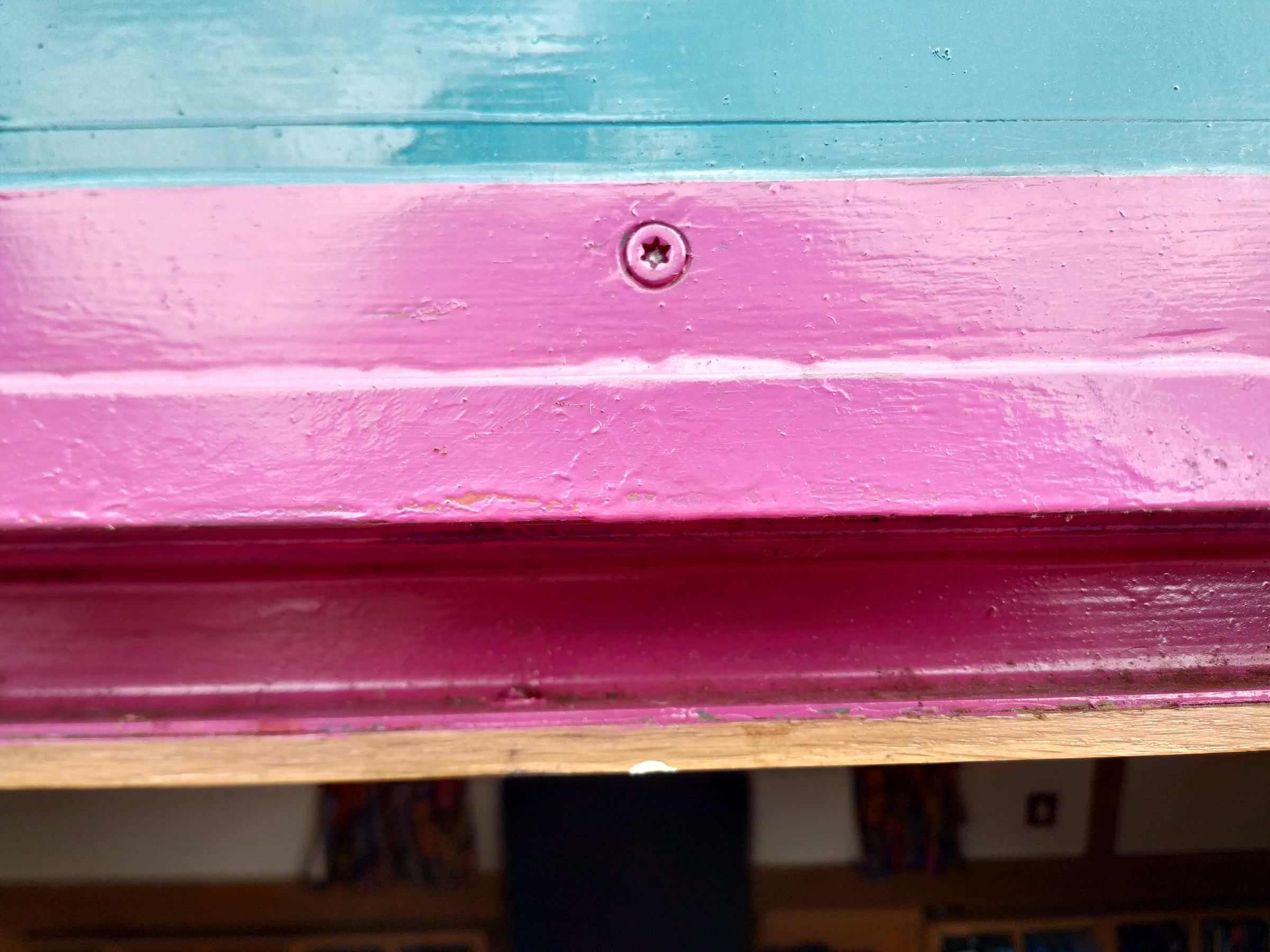

How odd that older rain deflectors were closed and newer ones are open. There must have been some logic behind the introduction of this 'flaw'! Anyway, the consensus seems to be that the issue is most likely a poor seal between wood frame and steel, rather than between steel hatch and cabin, so that's a step forwards. -
