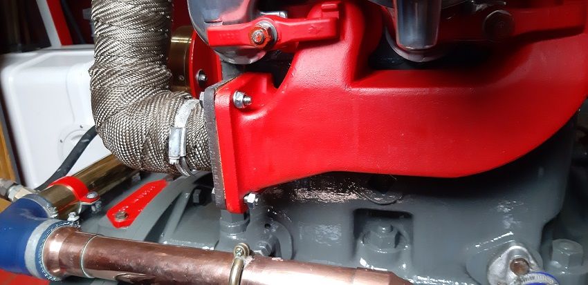

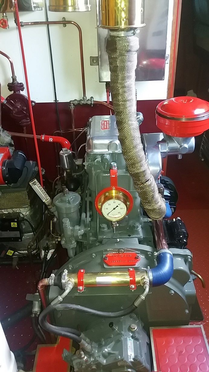

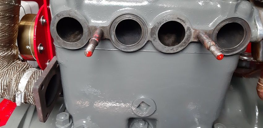

mark99 Posted April 10, 2020 Report Posted April 10, 2020 (edited) Remove flaking paint, degrease, wirebrush, wire wool degrease again and slap it on. (Proper engine paint, exhaust paint for exhaust header). bilge paint for bilge and raddle on undercoat for floor. Red hammerite for the tarty highlights. Hot, sweaty, fiddly, backaching, skinned knuckles and sweary. And that's with an engine in an engine room. Painted starter and alternator too. Edited April 10, 2020 by mark99 2

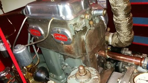

LEO Posted April 10, 2020 Report Posted April 10, 2020 41 minutes ago, mark99 said: Remove flaking paint, degrease, wirebrush, wire wool degrease again and slap it on. (Proper engine paint, exhaust paint for exhaust header). bilge paint for bilge and raddle on undercoat for floor. Red hammerite for the tarty highlights. Hot, sweaty, fiddly, backaching, skinned knuckles and sweary. And that's with an engine in an engine room. Painted starter and alternator too. Yo Mark, Looks good, shame original painting was so Skimpy!. No Boating for me - I broke my left Femur in early Feb. difficult repair as it was badly broken in 1966..........unlightly to be fully 'repaired' until mid July. Keep good. M.

Momac Posted April 11, 2020 Report Posted April 11, 2020 23 hours ago, mark99 said: Remove flaking paint, degrease, wirebrush, wire wool degrease again and slap it on. (Proper engine paint, exhaust paint for exhaust header). bilge paint for bilge and raddle on undercoat for floor. Red hammerite for the tarty highlights. Hot, sweaty, fiddly, backaching, skinned knuckles and sweary. And that's with an engine in an engine room. Painted starter and alternator too. Well done . A far higher quality finish than it ever would have been when new. Do you find it easy to keep ? I ask because I cleaned my engine bay thoroughly after I bought the boat and find a quick wipe over, little and often, keeps it nice ........other then a few areas that are very hard to reach.
mark99 Posted April 11, 2020 Report Posted April 11, 2020 10 hours ago, MartynG said: Well done . A far higher quality finish than it ever would have been when new. Do you find it easy to keep ? I ask because I cleaned my engine bay thoroughly after I bought the boat and find a quick wipe over, little and often, keeps it nice ........other then a few areas that are very hard to reach. Spot on Martyn. Wipe down regularly say every two cruising days. Clean leaves out of bilge etc. The halfords ultra high temp exhaust paint spray is not holding up too well. 7 hours ago, ditchcrawler said: Nicked from Facebook Blue and green should never be seen!
