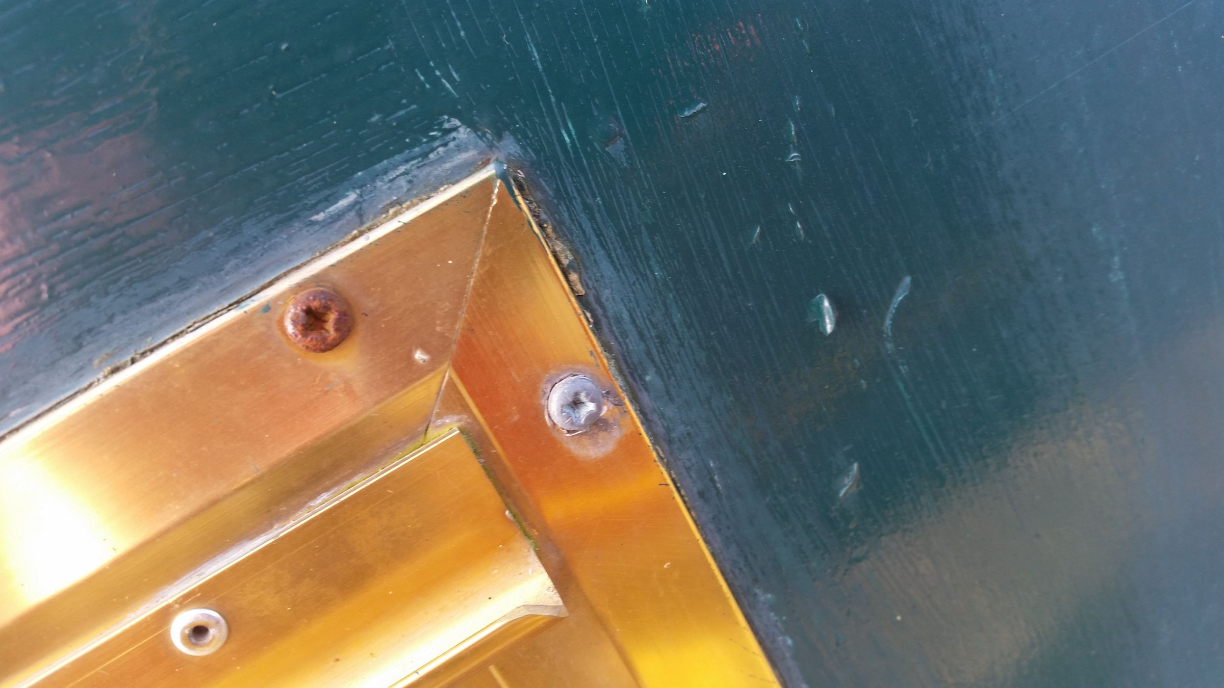

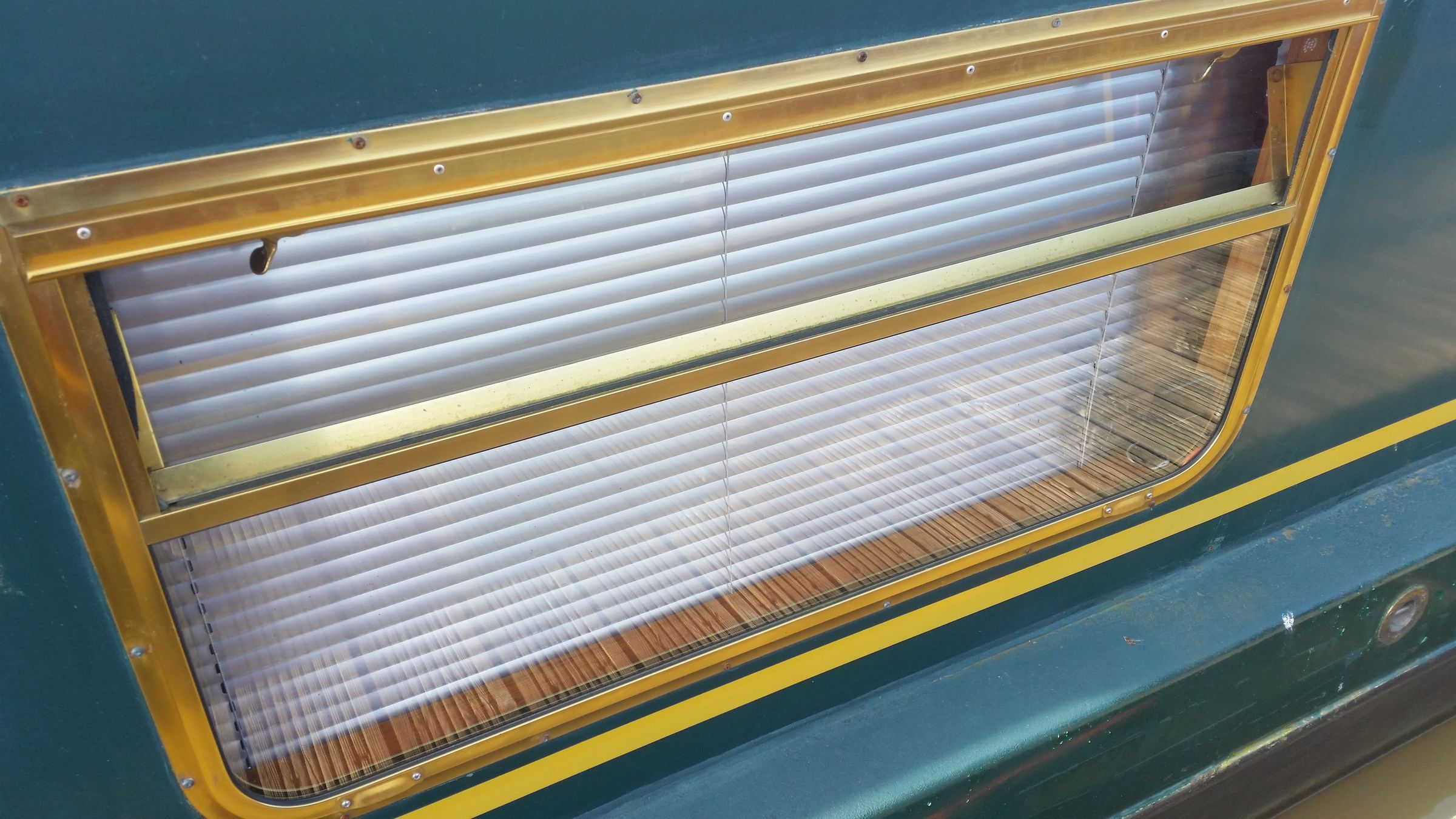

I have a small leak around one of my windows and am planning on taking the whole window out to reseal it.
Looking at the screws they could well be a bit of bu%%er to get out.
I guess that as these windows are quite common others may have encountered issues when taking them out.
Any hints and tips gratefully recieved.
I usually drill those type out and put slightly bigger self tappers in of stainless steel on replacement. You could also drill them out and tap the steel for stainless screws.
I used a Dremel loo0k alike to cut ordinary slots in the head using a pair of the abrasive discs on a single arbour. Then drove an ordinary screwdriver into the slot. All came out. Before I did that I tried all the usual tricks to free them without success. I think it was a combination of the heat and vibrations from the discs and the hammering of the screwdriver. I made sure the screwdriver had a hexagon on the shank for a ring spanner to get extra leverage.
Replaced screws with stainless steel.
Nice, like that idea, how do you get the drill started dead centre to prevent the bit wandering off ?
That also looks a good option but maybe more time consuming and risk of damage to the window frame with slippage of the cutting disk. Did you cause any damage on yours ?
It’ll do that all by itself by sitting in the centre of the cross. I’d start off with a 2mm or 3mm drill but let’s see what @mrsmelly has to say :)
I’d have ago at removing them of course. But Mr Murphy's law dictates that one won’t want to come out. But, you’ll only have to drill one out!

I've had recent problems with brass screws corroded stuck in my windows.  I've found that I can loosen them enough to use a screwdriver by hitting them quite firmly using a flat punch.  It seems to break the corrosion.  Then wiggle them both ways with a screwdriver and gradually work them out.
Yours look like Posidrive heads. Make sure you have a good, preferably new Posidrive screwdriver,  NOT a Phillips one.

This type of screw extractor work well on posidrive & phillips screws.  They will grip damaged screws where a normal screwdriver won't.  If you resort to drilling the screws out bear in mind that most modern screws are hardened and drilling can be difficult. Self tappers are always hardened.
In the middle of Lidl I saw a massive selection of screwdivers the other day. Two or three rows of them. Plus a selection of bits and a bit holder. Not a single posidriv among them.

I will start off with giving them a soak in "plus gas" then try getting them out with appropriate quality bits. If thats a no go then go for the extractor or drill out and finally will refit with stainless screws.
Another trick to loosen an otherwise tight screw is to give it a jerk in the direction of TIGHTENING it. This often cracks the corrosion (or gunk) making it easier to loosen in the correct direction without damaging the head. However a nice new well-fitting screwdriver is a must.
I doubt that they are wood screws into timber inside, they look like cheap self tappers.
Drilling hard self tappers is impossible. Try a new screwdriver, correct bit looks to be Pozidrive #2, give it a good thwack first into the head recess.
Else knock them about sideways with a cold chisel to loosen them.
As a last resort Dremel a slot or grind heads off completely.
Drill and tap the steel, if the holes are too big swapping the windows around  if they are similar may give you places to re-drill and tap.
Replace with dome head allen or star drive stainless machine screws, the bigger head will cover any minor damage to the alloy frame and they are easier to get out later.
Use sealing tape when refitting to cleaned surfaces. If you must use mastic, Sikaflex non setting and don't fully tighten till a week later.
PU18 will seal them for ever but you will never get them out again in one piece.
You can also get screwdriver tips that are diamond impregnated specifically for removing corroded screws. For the life me I can't be sure where I saw them but a company called Orbital Fasteners would be a goòd place to start looking. Sorry but I'm pushed for time so can't search on your behalf.
I've had success using impact drivers for removing stubborn screws (and bolts) - not in window frames though. They can be expensive for a one off use, I was lucky a friend has one. Make sure to use the correct bit and a good quality one. I agree it does look like PZ#2 would be correct.
