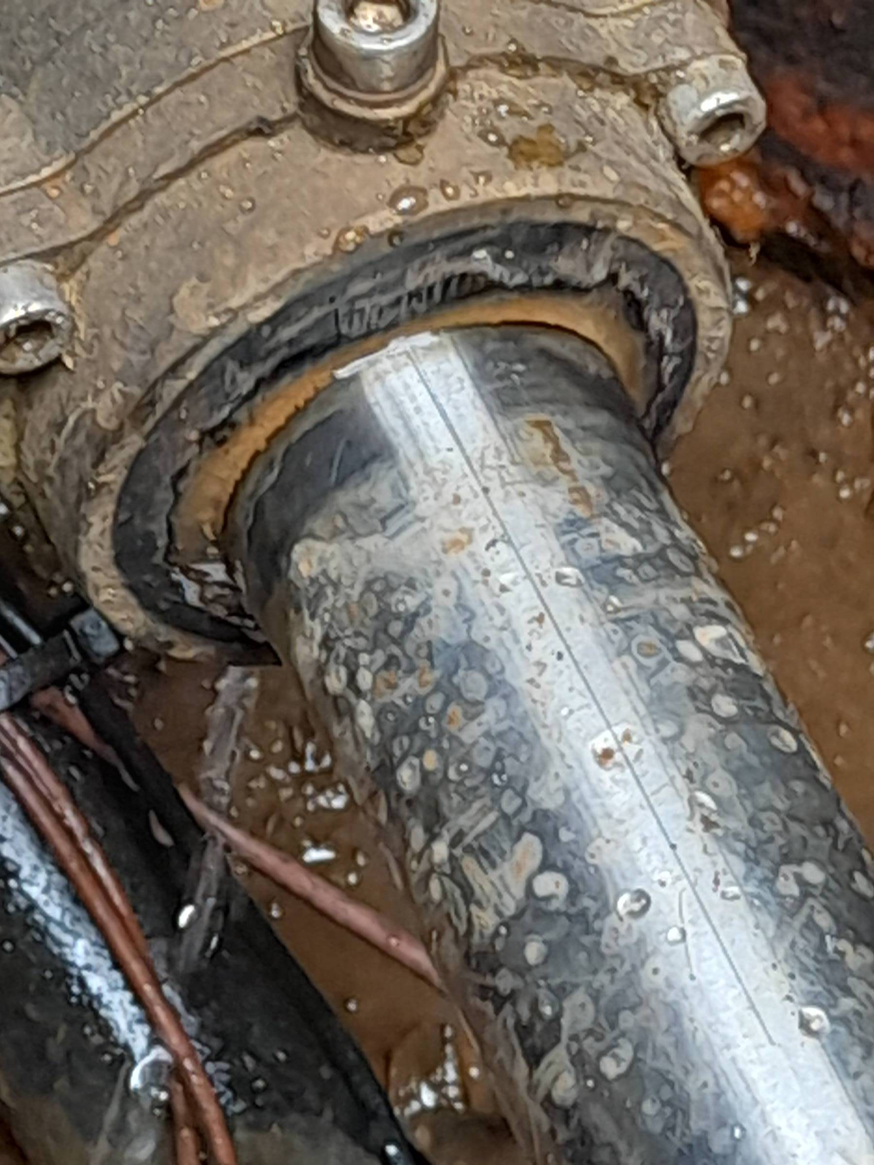

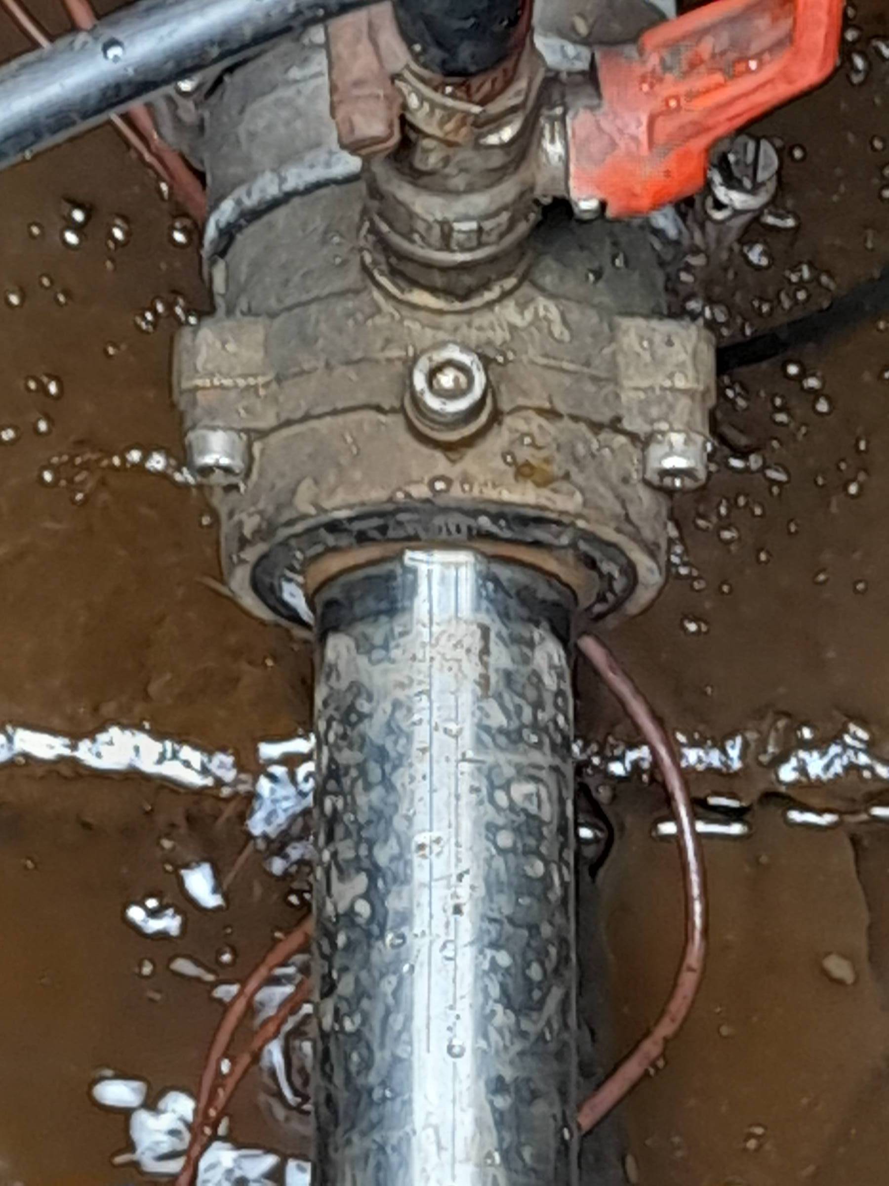

  1. All looks good at the moment , had a good run and so far no leaks. I will take a look next time I'm out of water for blacking.( if it lasts).
  2. Thank for the input , grease arrived. Checked prop and no damage , load of rope and fishing net around prop , cleared it all off , no movement on shaft so prop seems fine. Engine mounts seemed OK, no unusual vibrations or sounds. Shaft alignment looks OK. Shaft couplings and flexible joints all look OK. Took grease screw out and forced grease in past the jet of water spinning shaft by hand , that slowed the drip right down , ran engine in gear for 5 mins and repacked . Thankfully now no dripping at all . I thought about removing the front off buy was not brave enough , I thought water would piss in.
  3. I have ordered some vetus grease . I only noticed bilge pump turning on when leaving boat and had a quick look and noticed the drip , I started engine and mounts seemed OK, tried a quick nip up on bolts but then had to leave . Grease should arrive Monday so will grease and investigate further then , get a bit more hands on . Thankyou everyone for replies .
  4. It was fine until I hit a submerged object , it stopped the engine dead . This is the first time down engine bay since that happened a couple of weeks ago , I suspect that object has moved the shaft I will get some grease and try the top screw
  5. Anyone have any experience with this type stern gland . I have tried nipping up the 3 Allen bolts but still leaking.
