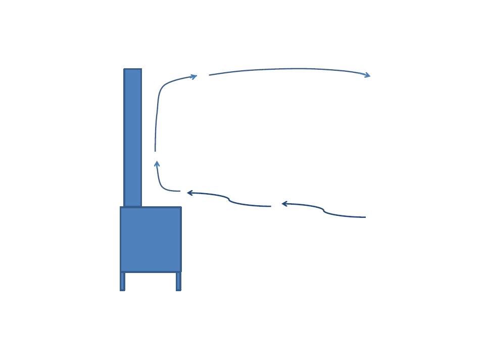

I was on a neighbour's boat today and noticed he had his Ecofan pointing the wrong way around - towards the flue.
When I asked him why he said that when his teenage son was on the boat he'd been burning joss sticks and he'd noticed strong natural air convection currents running from the floor towards the stove, going up parallel to the flue and bulkhead behind the flue, and then across the ceiling. He said if you use an Ecofan the normal way you're fighting against natural convection and it's better to assist the natural warm air currents with the Ecofan rather than working against them. He said his boat feels much warmer since he turned the fan the "wrong" way around.
I'd never thought about it before but it makes sense and I thought it was interesting. Or is this old news to seasoned Ecofan (or other stove top fan) users?
I'd not heard that one before!
It is interesting. On our bote, the low level flow to the stove is coming in at floor level not top of stove level so with the fan in normal direction you are creating a separate airflow out from the stove at face level (when sitting down). It may be different on a fat boat. Reversing the fan should increase the main circulation as you say.
One other benefit could be a faster fan speed. If it is pulling colder air in then there should be a bigger temp differential over the pleltier cell so more voltage???

Funnily enough I saw this on a friend’s boat for the first time last week. I guess it has been doing the rounds on social media.
My take is that yes this natural circulation does exist, however it results in layers of hot air at the top and cold at the bottom. Air is pretty good at flowing in layers and not mixing well. By having the eco fan as you suggest, you just reinforce that. By having the eco fan the “normal” way round you disrupt the laminar flow and help to mix up the air, which is a good thing!
I definately get this problem with much colder air around my feet.  I wonder if a slow moving battery powered ceiling fan would help?

My Ecofan is useless at moving heat through the boat. I use it because it is good at moving heat (close to the stove) from the ceiling to the floor. Without it I sit with freezing feet but nearly boil my head when I stand up.
I'm not sure. What my simplified drawing doesn't show is the warm air at the ceiling of the boat falling as it gradually cools and then returns back to the stove. Heat convection is a circular movement and if the natural convection currents are assisted and increased then the whole boat should warm up quicker. Anyway, my neighbour seems to think it works much better the wrong way around.
