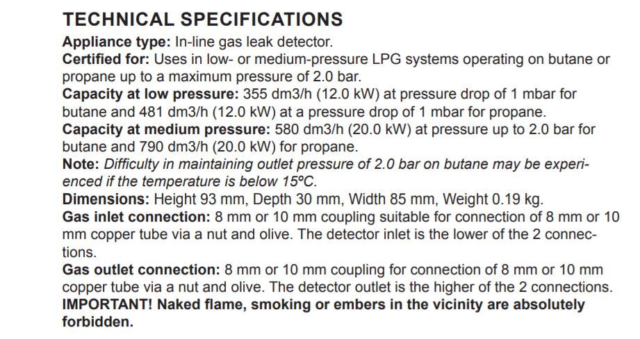

However, one of our team spotted a mention on the BSS website that it was "Strongly Recommended" that ALL boats are fitted with a bubble tester on their gas system. Now a recomendation is just that, we are not forced to do it BUT if it is highly recommended by BSS then one has the feeling that there is good reason for it and if it would help make any of the fleet safer then why wouldn't we fit one? After all it would give the volunteers the opportunity to test for gas leaks themselves at regular intervals rather than awaiting a 12 month gas safety certificate being produced.....
I had reason to speak to our surveyor about another matter yesterday and felt I wanted to run the bubble tester thing past him before we dash out and invest in several of the things.
He said he wanted to give me a strong recommendation on this - write to the BSS office and tell them to remove their strong recommendation -eh? what?
He pointed out that if a bubble tester is fitted then it must be fitted according to the manufactures instructions. He said that st present the higest rated tester is made by Alde and is rated at 20kw. He knows Python and her equipment intimately (he does our Gas Safety cert annually) He said working from memory our Morco water heater was a little in excess of 11kw. We also have a 4 burner gas hob, a grill and an oven. He suggested I get the model numbers of the other appliances and check the rating of each then add them together to get the total for the boat. He assured me that it was highly unlikely that with the appliances we have there is any way we can be under 20kw and so if we fitted a bubble tester it would be outside of the manufacturers recommendations and it could cause us problems with the efficient running of our appliances.
While I know that will not apply to a lot of boats I do wonder how many people actually check the total rating of their combined appliances to ensure a bubble tester is suitable for their boat. Perhaps they do but there is no mention of this on the BSS website. If they are issuing a strong recommendation to do this and yet there is no product on the market suitable for some boats to comply why?

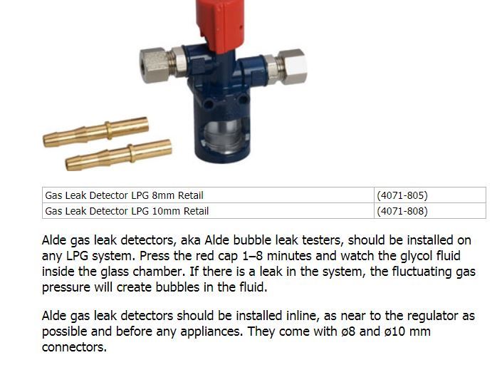

Hi
For the record, the maximum permitted throughput for an Alde bubble tester is 12kw, not 20kw; this is what Alde themselves state.
The device should not be installed at all if there is more than 12kw of appliances aboard unless the device is correctly positioned in a bypass set up.
A bubble tester can be fitted with a bypass valve that allows a larger flow rate to the appliances than the tester is rated for. Close this when carrying out the bubble test. This is mentioned on the BSS page for gas on hire, passenger and business boats.

5 minutes ago, keelingtom said:
Hi
Interestingly they also say to test for between 1 and 8 minutes, a long time to press the button down
