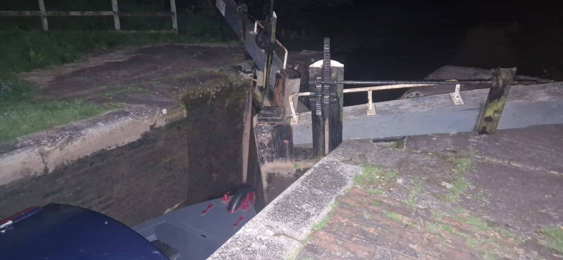

hider Posted July 31, 2024 Report Posted July 31, 2024 Ah, the boat in the lock is going down ( presumable, bow first ) so the boat coming up managed to open the gates on an empty lock. The gates would float in the lock as it filled. I wonder if the boat coming up crashed the gates and dislodged the collars, unlikely but plausible.

David Mack Posted July 31, 2024 Report Posted July 31, 2024 37 minutes ago, hider said: Ah, the boat in the lock is going down ( presumable, bow first ) so the boat coming up managed to open the gates on an empty lock. The gates would float in the lock as it filled. I wonder if the boat coming up crashed the gates and dislodged the collars, unlikely but plausible. Or maybe the bottom gates were already open with the collars removed when the boat going up arrived. After the boat had entered the lock the crew closed the bottom gates in a way which kept the hinge posts against the quoins. As soon as water was admitted to the lock the pressure of the water on the gates would push the hinge posts into the quoins and the mitre posts together, so the lock would fill as normal, and it was only once the lock was empty again that the gates fell out. 1 1
Arthur Marshall Posted July 31, 2024 Report Posted July 31, 2024 2 hours ago, dogless said: I understood it was the collar retaining pins/ bolts that had been removed. Is that not so ? Rog The collars are off and so are the wedges. 2

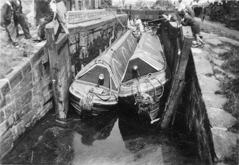

David Mack Posted July 31, 2024 Report Posted July 31, 2024 56 minutes ago, beerbeerbeerbeerbeer said: Is there any possibility the boat in the lock could have done it? Gone in too fast and banged fk out the gates. Like this? 3
beerbeerbeerbeerbeer Posted July 31, 2024 Report Posted July 31, 2024 Oh dear. Don't hold back on the information, where’s it to? and when?
Rob-M Posted July 31, 2024 Report Posted July 31, 2024 2 minutes ago, beerbeerbeerbeerbeer said: Oh dear. Don't hold back on the information, where’s it to? and when? There was a discussion 1

dogless Posted August 1, 2024 Report Posted August 1, 2024 But it's only one gate according to the photo on page one of this thread ... or do you know more ? Rog
hider Posted August 1, 2024 Report Posted August 1, 2024 1 minute ago, dogless said: But it's only one gate according to the photo on page one of this thread ... or do you know more ? Rog Both collars are off. 1
